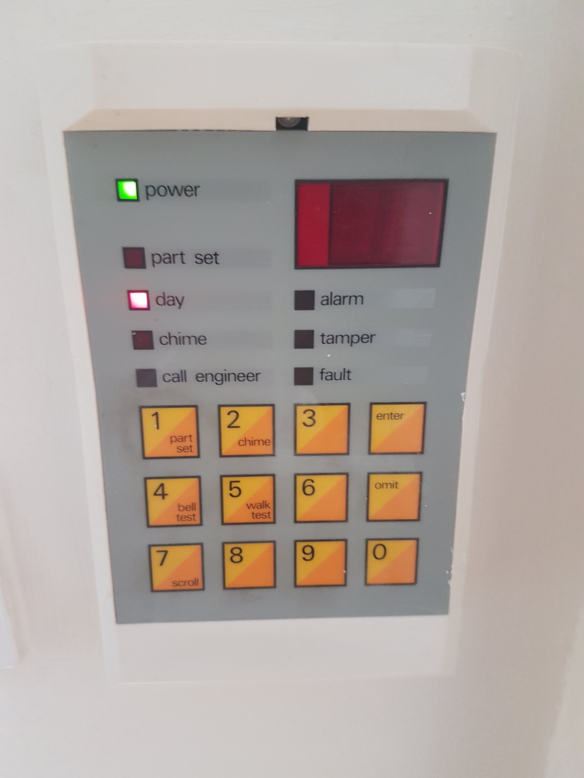

Have searched quite extensively.... But without any identifying marks, is a challenge to determine make/model for this alarm panel (here when we moved in).
Though have been able to work out most settings, not clear how to change the alarm code (previous owners left current code for us).
Any help greatly appreciated,
Thanks.

Scantronic 9100 code can only be changed by engineer ! Default being 7890 it's about 30 years old
Many thanks. The house was built around 1989....so assume it's original.
And the code is not the default but if requires engineer, will obviously leave as is.
Have no issues with it at present, but out of interest, is there a 'simple' upgrade route should it develop a fault?
Most modern panels will do ....endstation will be texecom 48 metal / euro46 large in size ...
