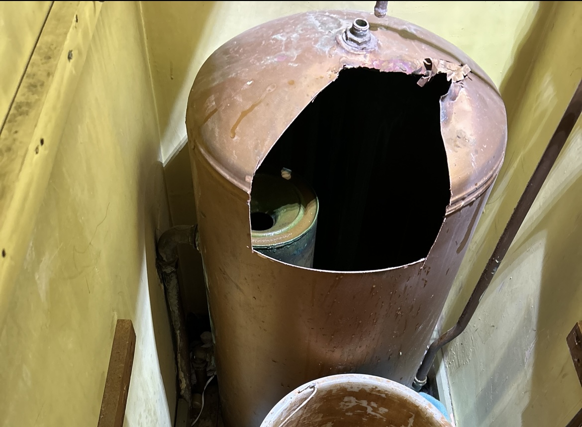

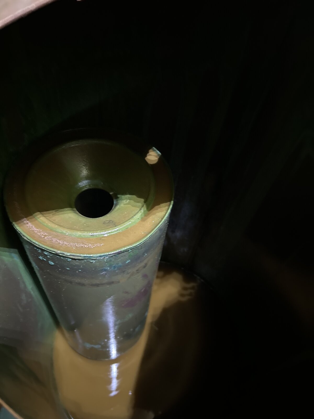

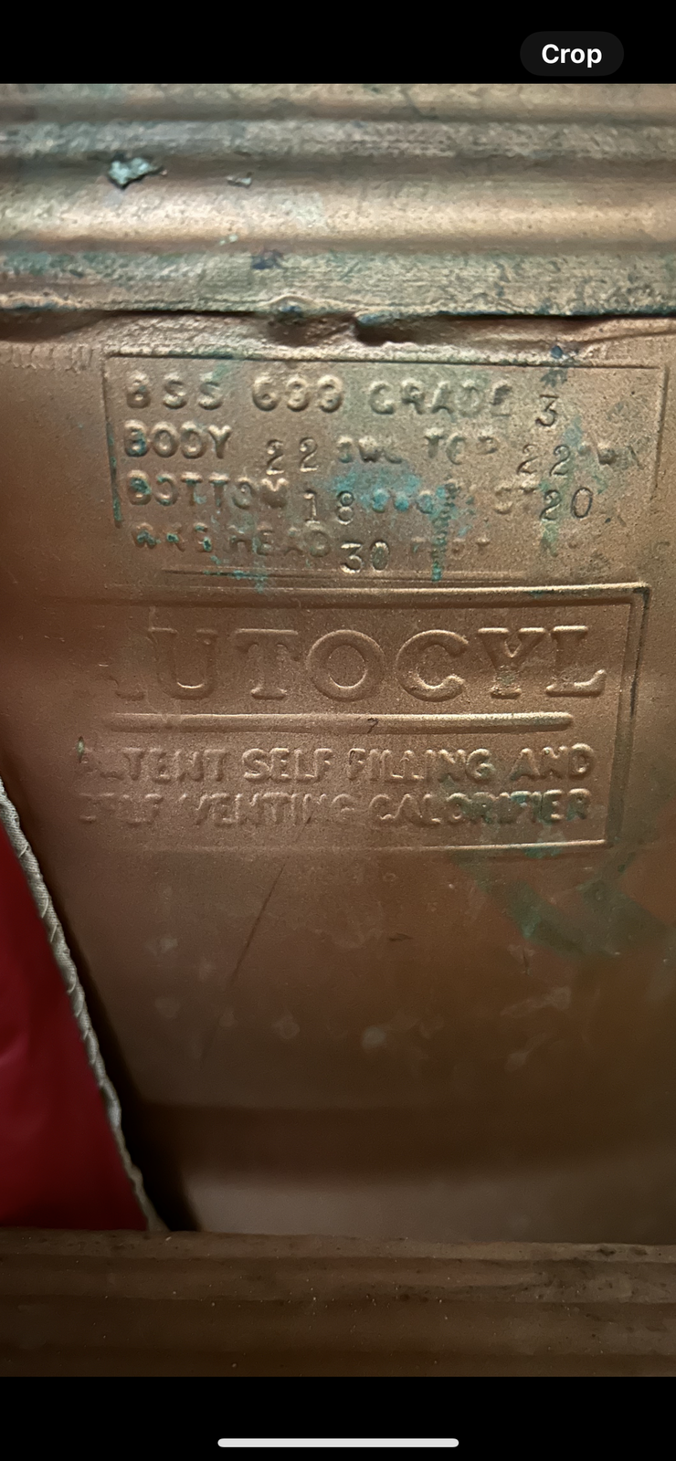

Afternoon all,
Can someone please help me identify the type of tank this is? I’m torn between gravity coil or prismatic? It has an old feed tank about 2ft above it in the same cupboard. It does hot water only fed from an old solid fuel back boiler.
Inside is what looks like a twin lined smaller cylinder?
I basically need to replace the hot water tank but with what type?

Thank you, I thought it might be.
Only thing that put me off, is most say primatic are heating and hot water. This hot water tank is hot water only. The heating is all currently electric storage heaters.
Can primatic be hot water only?
They can be h/w only but if you'renot using the back boiler, you're better off decommisioning it and buying a 2 immersion cylinder for electric heating .Economy 7 like your heating.
