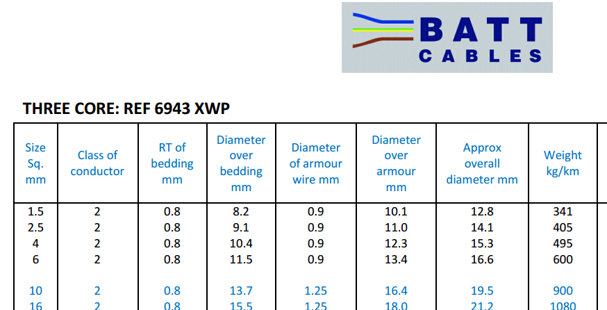

Can anybody help me identify the core size of an offcut of SWA? Moulded into the outer sheath it says " ELECTRIC CABLE 600/1000v BS5467-1997" then printed in white "1416 MT I P NO 13344031". The 1416 seems to be a progressive no as it is 1415 and the 1414 further back along the cable. I cant see any other identification. The outer sheath diameter is 13-14mm. It is 3 core and either 1.5mm2 or 2.5mm2 but stranded cores to hard to work out.
You may have to be more accurate -
Measure the bundle of strands to get the diameter of one core. If it could be any size then that wouldn't be accurate, but as you have a choice of two, it will be - there's a .4mm difference between the two.
I see what you mean, thanks for the table. The 13-14mm is measuring the major and minor diameters but almost exactly replicates the the difference between 1.5 and 2.5mm2. Now if I had a kilometre of it, I could weigh it......

Blue fits, red doesn't. But last time I used 1.5mm2, red didn't fit either so no help really. Thinking back I am pretty sure it is 2.5mm2 but I might just buy a new length so I am sure what I am using.
