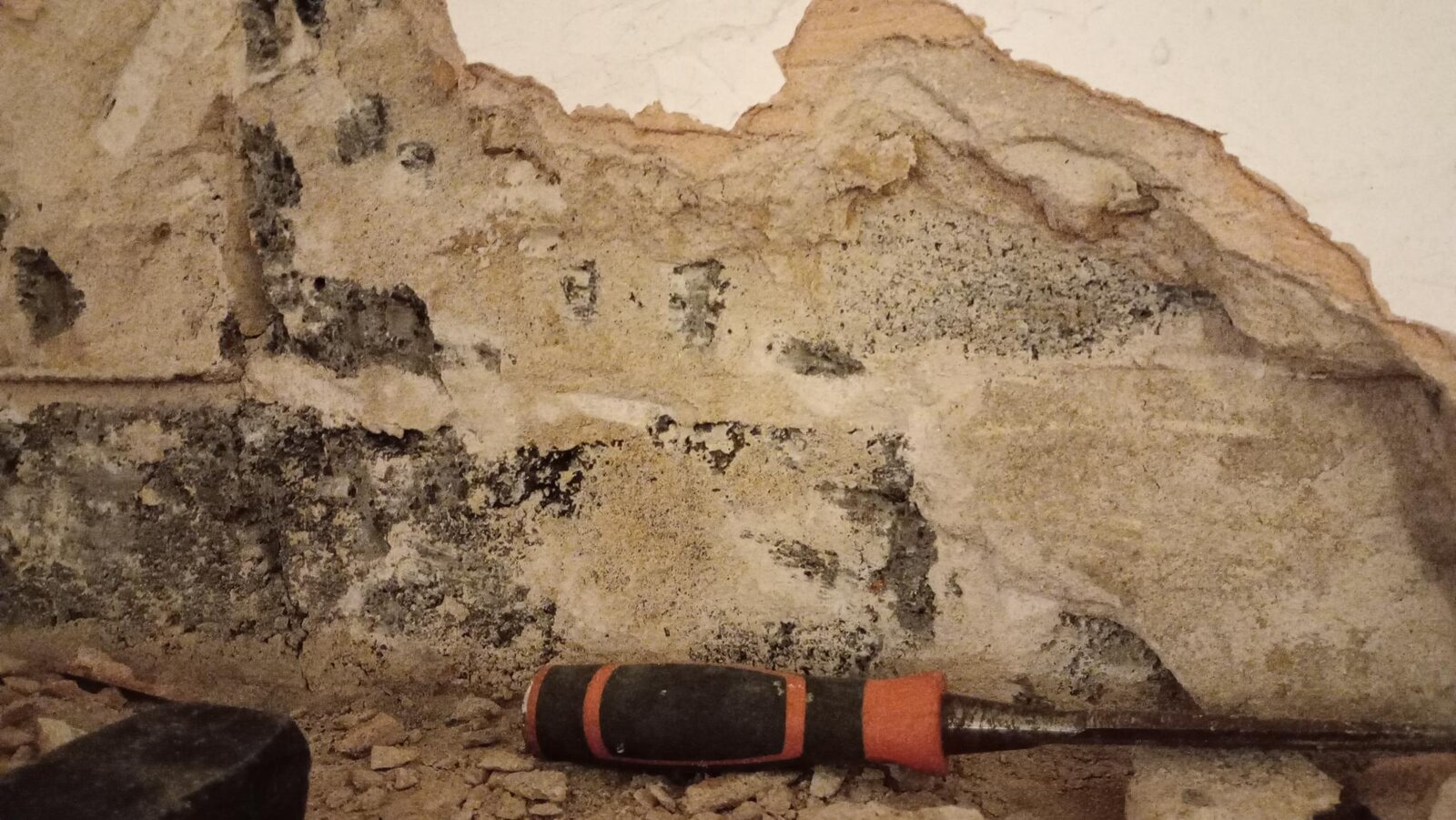

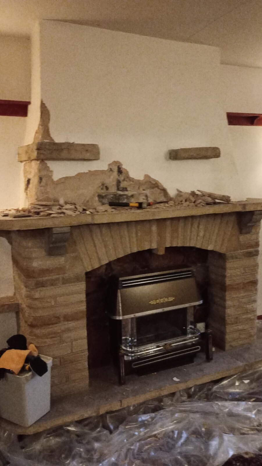

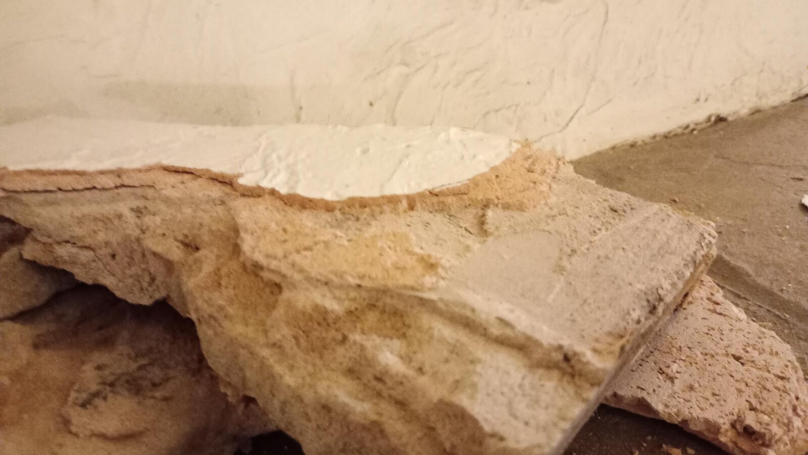

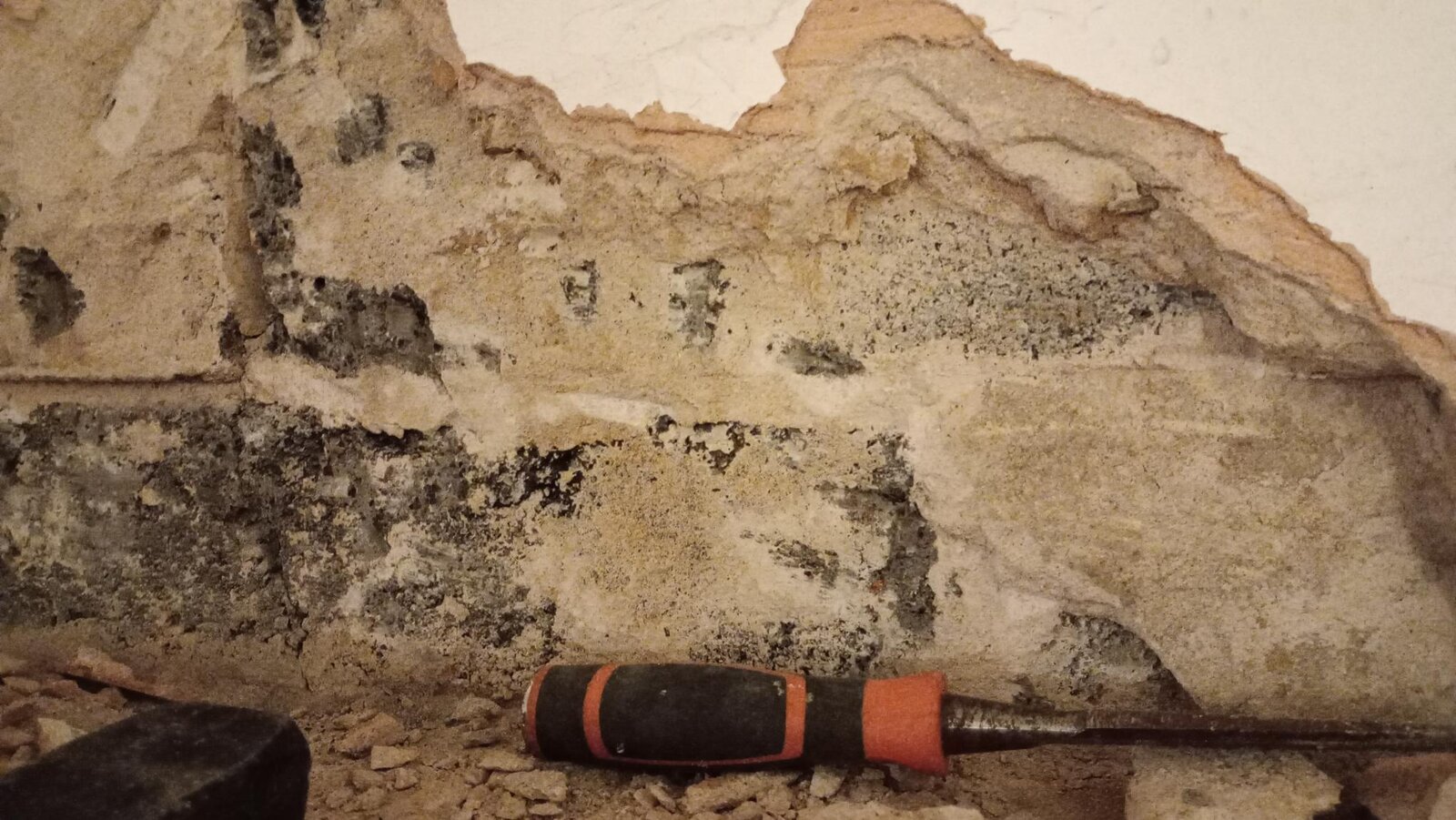

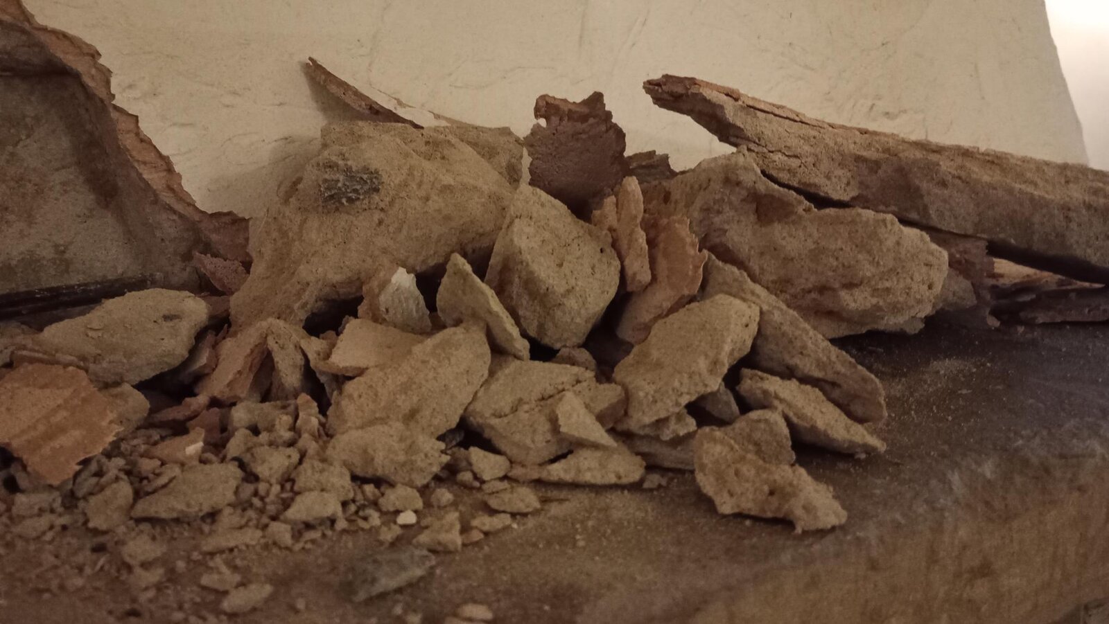

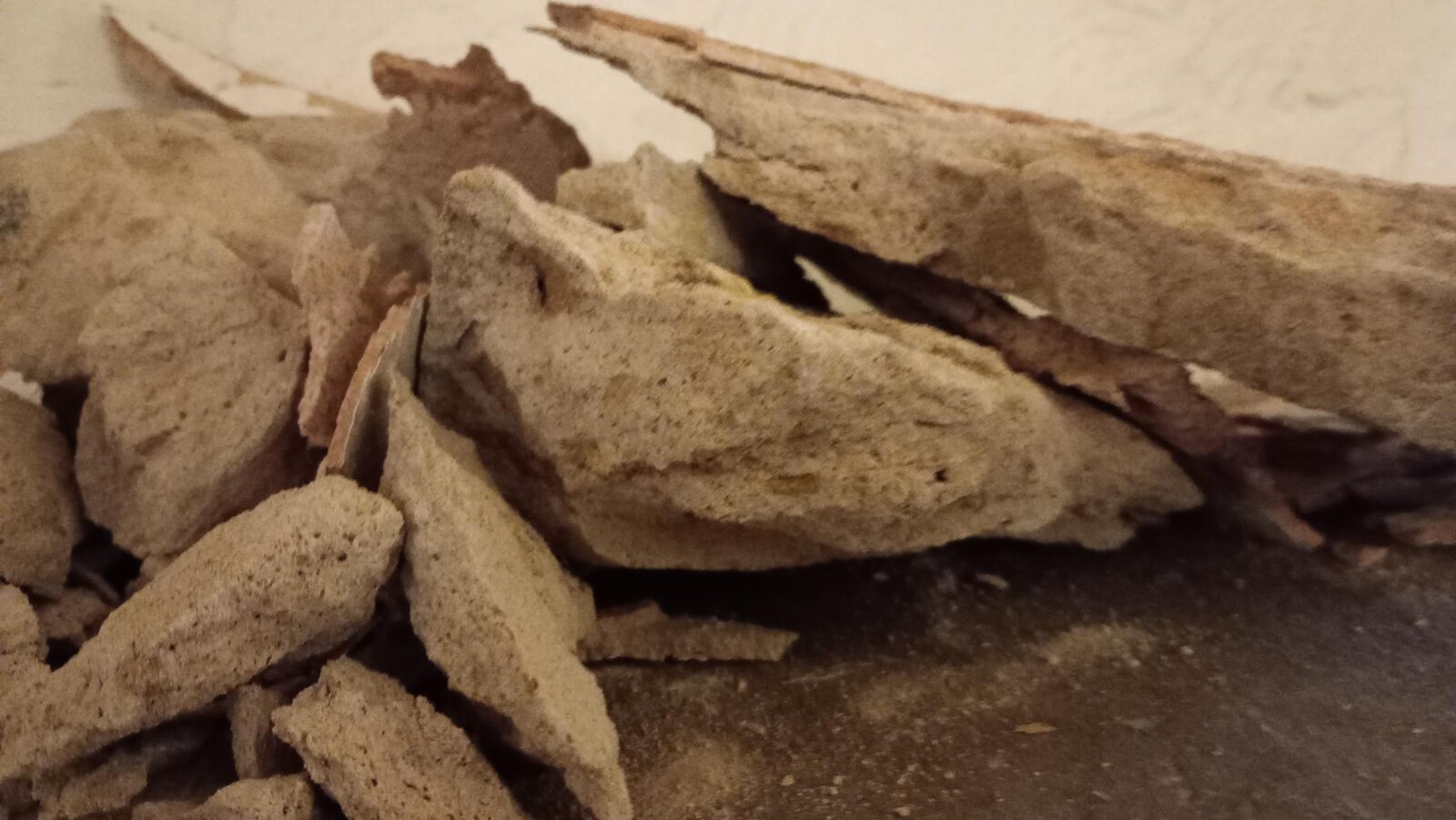

Good Morning ,
Can anyone with experience tell me if this contains deadly asbestos by looking at the pictures?
thankyou
I may be wrong, but I see a lime plaster backing with a gypsum skim - these won't contain 'deadly' asbestos.
I can't tell from the photos whether the white paint covers a textured coating though?
Thankyou.....it's textured......
We are trying to get to the brick behind to exposé it....it's 19th century property But then it's hard to identify the brick.
So you're thinking lime plaster being with the White front being gypsum?
Thankyou
Lime plaster is the thick, crumbly, pale coloured backing. Take a block, drop it in white vinegar and it should fizz.
On top of that, I see a thin layer of hard, pinkish material, the gypsum skim.
Both of those layers would not have asbestos.
If, there is a textured coating over the top of the skim (i.e. artex), there is the possibility of asbestos within it, but it's also possible that the surface texture has been made from the plaster finish. It's impossible to say from those photos.
It's certainly possible that the textured surface is from the plaster...
Thank you random Grinch......when you speak of the layers are you referring from the bottom up to the white textured surface?
Thank you very much...I stopped work and ordered a test to be sure
