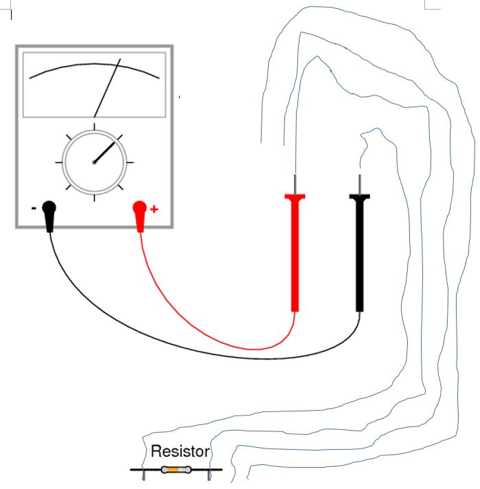

Just to confirm, there was only 1 wire on the outside of the wall although it looked like (didn't pay much attention to it tbh) it had a few pairs of wires within it. Are you saying to take a pair of those wires and connect the resistor to each end then complete the circuit with the multi-meter at the other end?
Or just one single wire connected to a resistor at the bell box end and multimeter at the other?

Craig,
Resistor idea sounds good - test it with the multimeter on Resistance setting and make note of its value before you use it on outside wall.
I am Suggesting: "From the cable that is outside, select two of the wires and connect the resistor across these two wires. Then complete the circuit with the multi-meter at the Inside end of the cable, testing each wire for Resistance." If the wires inside the cable are twisted pairs, then use one of these twisted pairs as this should make it easier to test and identify the wires at the Inside end of the Cable.
Here is a terrible picture I made.
It shows that you will get incorrect Resistance for all the other wires (no/zero resistance if wires are joined), some Resistance for all the other wires if say going to a PIR, but when you find the correct pair you will get (near) the resistor reading.
Haha nice diagram SFK!
Thanks for the info, think I got confused with 2 physical wires rather than a pair of wires within a wire. I guess as long as they are linked together with a resistor one end and a multi-meter the other end it should make a circuit.
