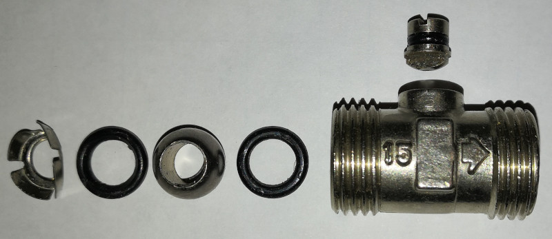

Evils of ball valve. I am suffering this on 4 old/possibly-unused valves currently.
The soft seal in the ball valve is its weakness. So, there may not be a miracle valve. Although, I think redundancy could be a passable compromise. A gate valve plus a full bore ball valve could reduce the chance of shut off failure. Here's a run through of all the valve types:
Analysing one of the failing ball valves indicates shrinking of rubber o-rings because of aging. This is reparable using mechanically superior FKM rubber o-rings that are available cheaper from china, assuming they are metric sized. China doesn't do imperial sizes. The mangled securing spring could be cannibalized from another failed valve by cutting the casing with a dremel. A repaired unit would likely be better than anything you can buy. The shrunk o-rings would be made, most likely, from the common Nitrile (Buna) rubber. There is no guarantee branded products don't use this rubber. Looking at buyer complaints, I suspect branded products also use this rubber.

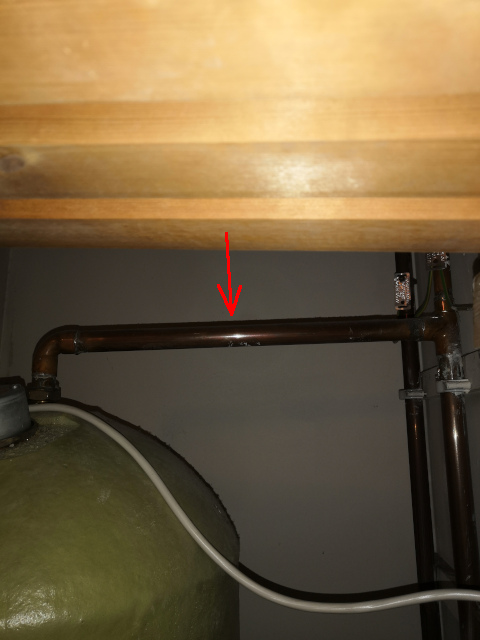

Any problems adding the ball valve at the arrow? This gives me the redundancy of 2 shut off valves. One here and the original gate valve up in the loft, which I will fix/replace. This location is the easiest to work with. The nut on the top of tank allows me to remove the pipe on one side of the valve during installation.
Yes its a problem. No valves are allowed on the safety vent. If you want to add a valve to the hot distribution pipe, it must go after the Tee on the downwards section of the vertical pipe.
If it's low shower pressure you are on about, pipe it in 22mm until the very last moment.......
