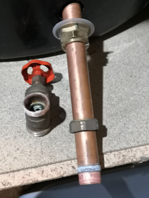

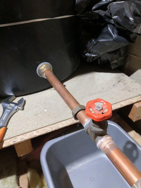

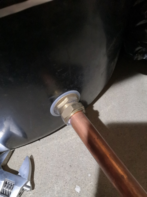

I have loosened the gate valve for extraction. But there appears no way to get the valve out. How can I do this? The tank side is flexi and can be pushed in a little. The the tank connector looks a bit fragile and I might end up ripping up something. Also the tank connector is unfamiliar to me. What is giving it a water seal and do I need a new seal if I were to disconnect the tank?
Turned out the pipe is seized on the tank connector end, and I will have to either cut the pipe or disassemble the tank connector.
The valve will just be stuck with calcium deposits and won't be too severe.......can you rock the valve to and fro a little, supporting the length that goes into the plastic tank?
The water seal is courtesy of the polythene washers, probably one either side.
Have you any movement outwards on the right hand length of pipe?
John :)
The only way to get the pipe out is from inside tank. Theoretically, I could force everything and it might work. But I really don't want the risk of additional breakages.
Reason for the gate valve failure is a large lump of calcium and copper "galvanic" reaction. It doesn't look like there is much hope for gate valves.

While sitting comfortably at my table manipulating the removed gate valve, I have to retract my earlier assessment. There is hope for gate valves after all. The correct way to fix partial gate closing is to repeat the closing action 200 times. There's a good probability the calcium will be chopped up. Increasing that to 500 times increases the probability of success and less work than replacing the valve. The action needed is to close to max, back off enough for the gate to unstick, repeat at a high pace. This involves rapid back and forth mini turns by the hand. The turns would be no more than 90 degrees.

There is no guarantee where it will go. There's just as good a chance it will go to somewhere that does no harm. For the pressure feed to the hot water tank, it will go to the bottom of the tank, and not much of it. The photo shows 30 years worth.
