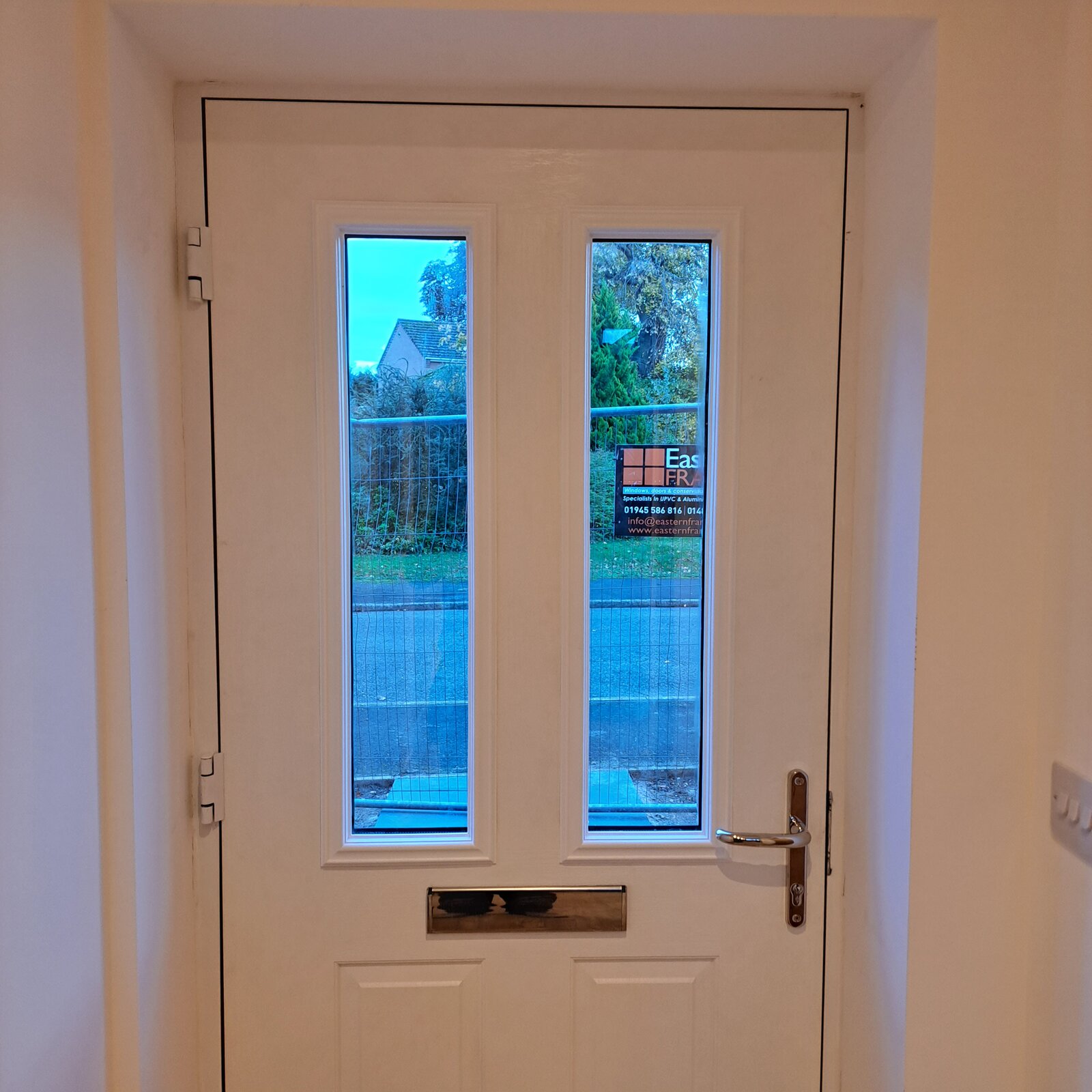

Hi, we had 2 composite doors fitted in our new build March 2022. The rear door failed earlier this year due to water getting in at the bottom causing it to swell. that door was replaced under warranty.
The front door has now failed in the same way. The fitters came out and found that the top hinge had also failed and that there were cracks in two of the glazing beads.
I have had an email this afternoon say that this was not covered under their warranty and that we would have to pay for a replacement. I believe that the doors are manufactured by IG but I'm not sure.

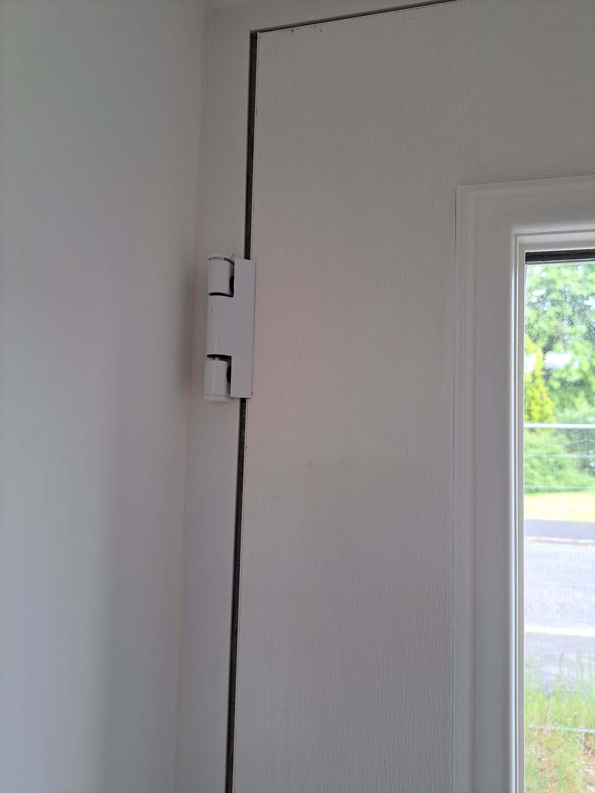

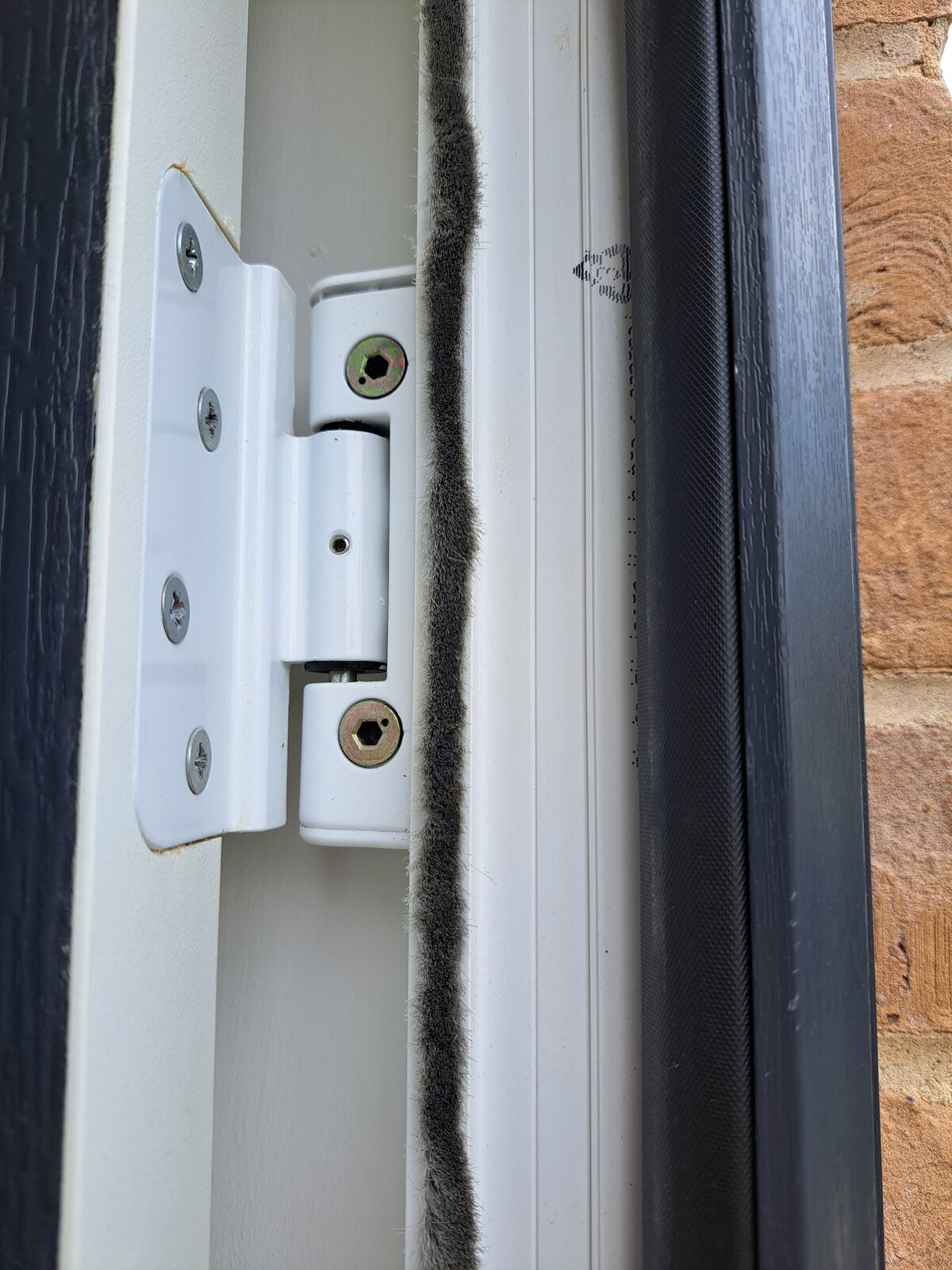

Are the hinges in the photo used by IG?

The hinge should last the life of the door.
If the damage was not deliberate or misuse, then it should be covered if not by the manufacturer/supplier then by the fitters under normal consumer 'fitness' legislation.
It's not for the customer to be hunting around for a replacement - in fact that will potentially invalidate any warranty on the door.
I notice it is a dark colour, does it get a lot of sun? I have seen some manufacturers don't recommended dark colours if they face the sun.
Doesn't look like an IG door hinge, I know because it's an ERA challenger hinge.
The door has clearly been adjusted up on the hinge pin from underneath with an allen key hence the gap

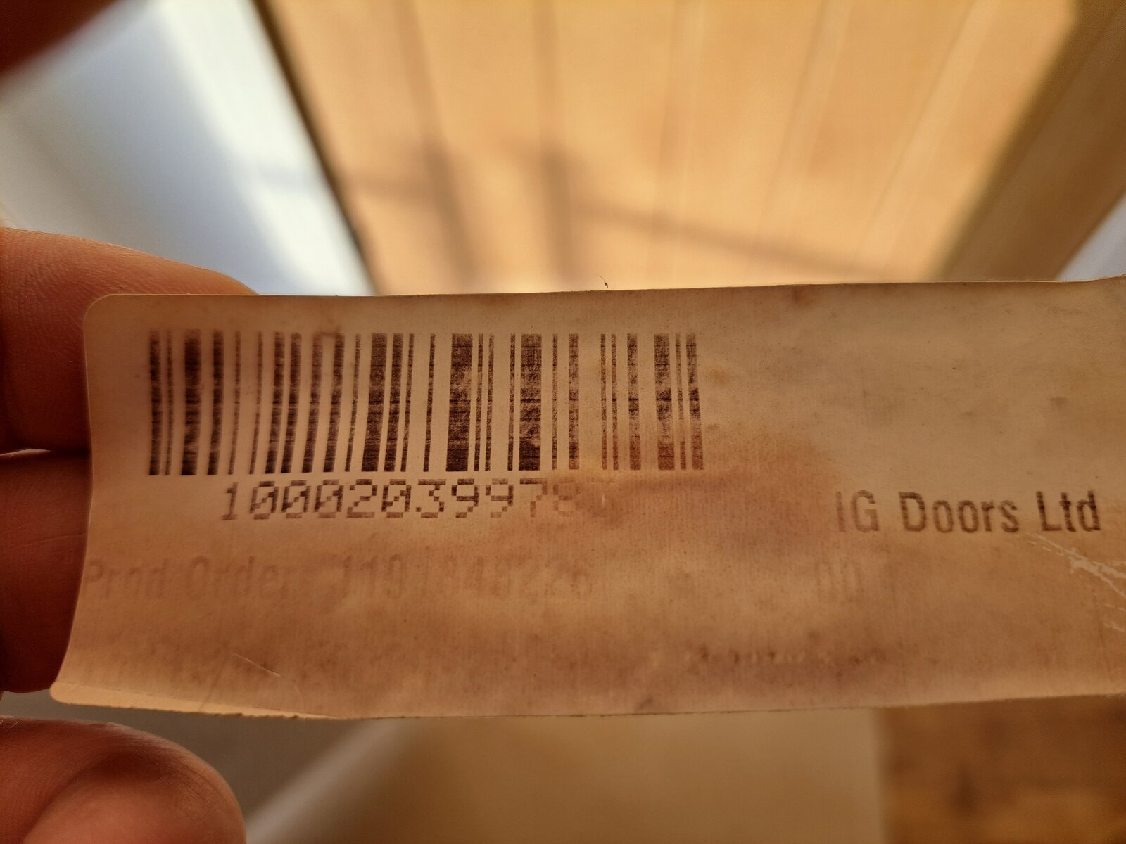

I found an IG production sticker on the top of the cassette. The hinge was adjusted by the service engineer.

. That doesn't look like IG to me either , completely wrong hinge for their doors BUT it might be that it comes from trade side of IG not retail.side of IG , Truedor , which was recently sold to Horman

Ser gut turned up on Thursday as planned. He had a glazing bead frame and 1 replacement hinge but couldn't understand why as he had said a replacement door was needed.
He struggle to fit the hinge as the middle hinge had also failed. He then struggle with the glazing frame as most of the clips had been damaged at first fix. He thought the fitters had used an impact driver them.
He went off saying it needed a new door. Later in that afternoon the company rang to say that they had ordered a new door.
