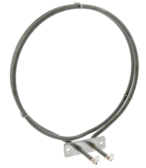

Looking at spares, assuming the details are correct, there are two heating elements in this model:
It is not clear what each does. This video talks about the replacement of the former fixing a cold water problem, but my water does heat up (although according to a Bluetooth thermometer, maybe not enough - 51 degrees during a 60 degree wash - maybe a thermostat problem, as surely heaters either work or not?). He ultimately identifies an issue with the circuit board.
There is also an "active drying air guide" but I can't find any details of what it does.

You have obviously found it has two possible replacement elements, the semi circular one will likely be the water heater one, the one in the tube the heated air element - the latter being the one which is failing to get hot.

It has only ONE heater the flow thru one . The circular solid element is a random cooker fan element.

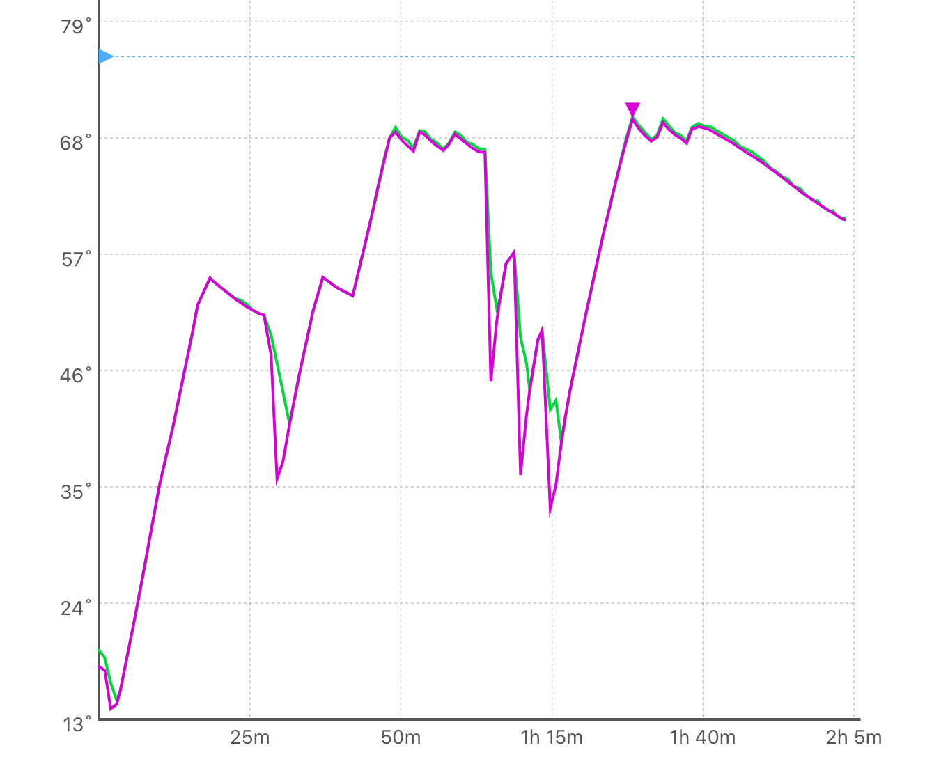

It does appear to be an intermittent fault, as a 70 degree wash today seemed to work; I used a Bluetooth thermometer to test it (and also noted steam escaping at the end of the cycle):
On that basis I think @SpecialK is on to something - and it is music to my ears to hear it might be fixable without removing the whole dishwasher as the way it's been installed (floor put down afterwards) was going to make that a right pain.

All seemed to be well since my last post until I noticed an unusually loud humming coming from it the other day and it's not getting up to temperature again (confirmed by Bluetooth thermometer). I'll start with the relay.
