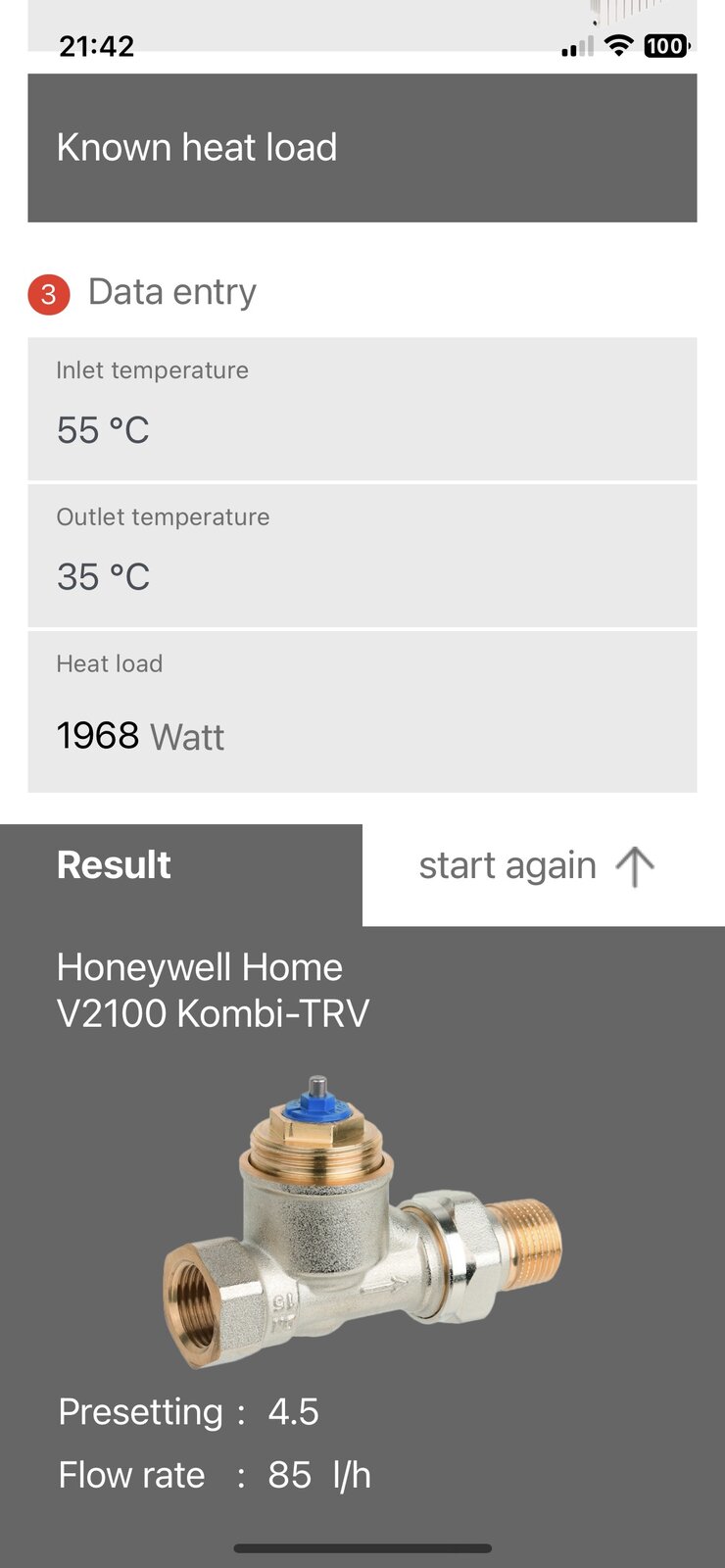

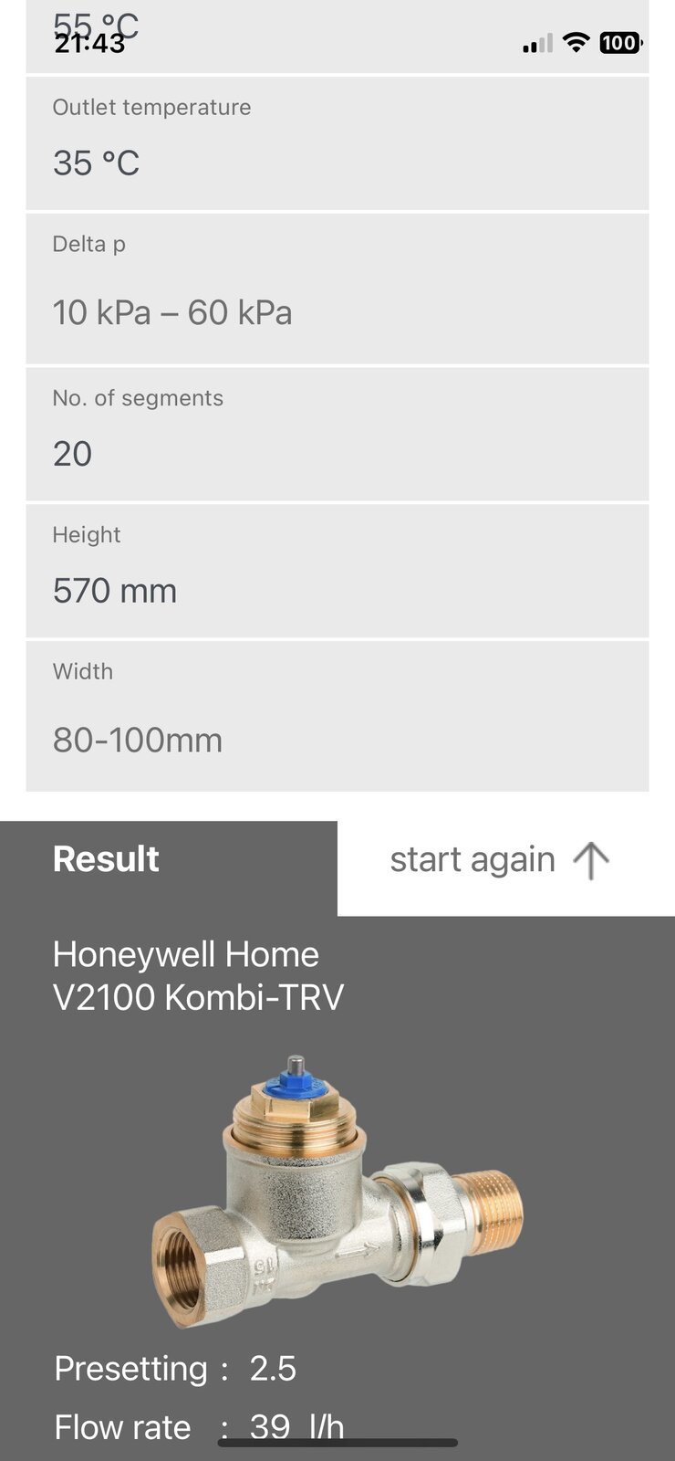

I’m looking at fitting these on all the radiators in my house. Looking at the settings guide it all seems straightforward. The problem is all my radiators are aluminium. I have been on the Honeywell app for their auto balancing valves (They have settings for aluminium radiators)
When you enter the size of radiators in aluminium it comes out a totally different setting than if you enter the known heat load of the radiator.
The settings I get for one of the aluminium radiators if I input the aluminium radiator settings I get preset 2.5, 39 l/h
The settings I get for the same radiator under known heat load setting on the App is preset 4.5. 85 l/h
How do I know what settings to use if I get the IMI valves? They have no presets for aluminium radiators.
