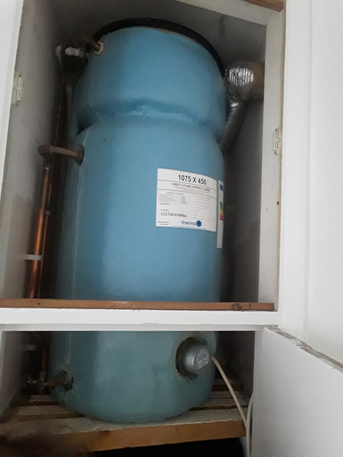

Hi I have an immersion boiler and I'm looking to put a shower head in my flat, so my boiler is about 1.5m higher than my bath taps If i add a shower and have the extension pole/ shower head about the same height as the boiler, would I get any hot and cold water? I mainly want a shower for cold showers as I'm getting sick of having baths... I dont know if the pressure would get to the shower head?
If your hot water cylinder, with immersion heater fitted, is fed from a cold water tank somewhere above it ,the vertical height difference between the tank and the shower head will determine the pressure.
For instance ,if the cold tank is in a loft ,and the shower head is a few feet lower,the pressure would be very poor.

These another flat behind me, so I think water froms the mains outside? My cold tap as they are now bathrooms and kitchen, water pressure is stronger than the hot
Show us a pic of your hot water/ immersion boiler as you call it.
You will not get any pressure from a shower head if the bathroom it's in is on the same floor level as that set up.

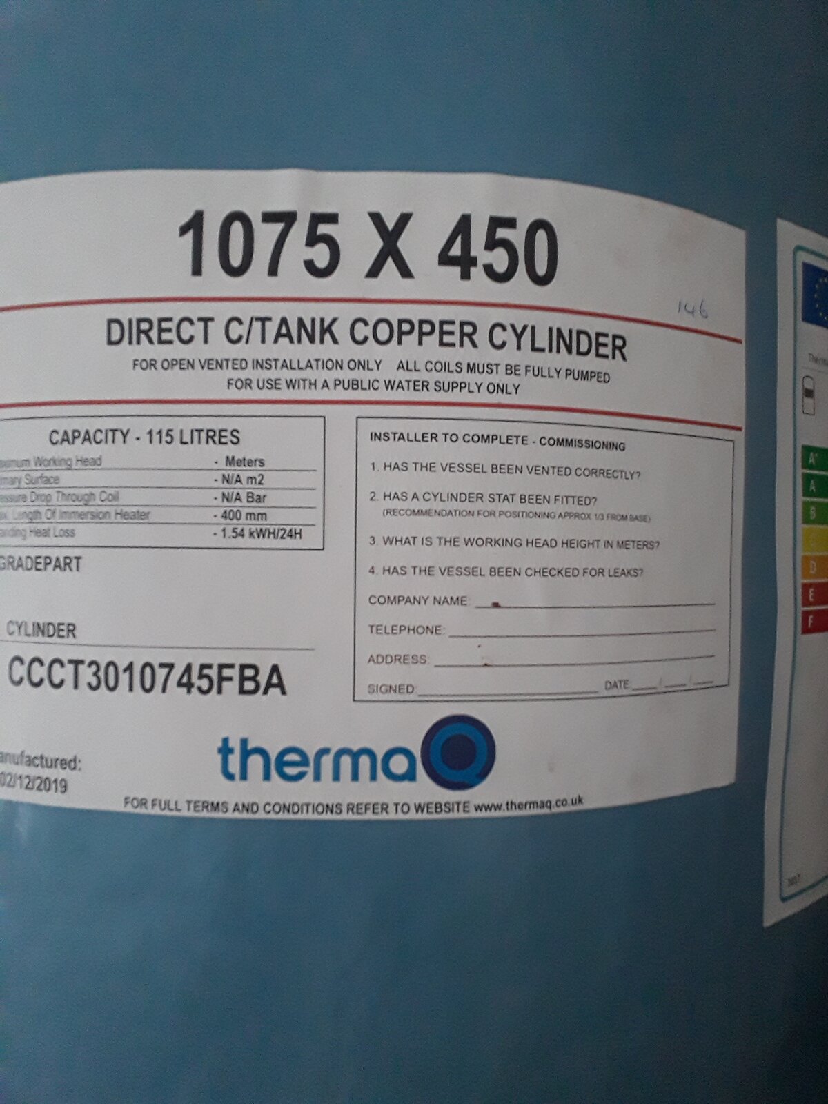

its roughly 215cm from the bathroom floor to where I would like the shower head as im 6ft 3..
the bottom of the boiler sits roughly 180cm above from the floor and its highest point is roughly 280cm
You said the cold water was mains pressure ,so you would have plenty of cold water from shower head .
The hot is gravity fed and you would get virtually nothing,if any at all.
