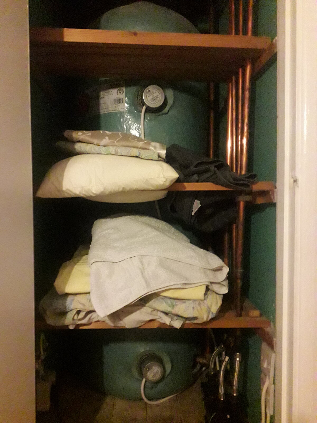

What colour is your cylinder? (This is not a joke)
My cylinder is Greeny blue. Yeah the booster wasnt switching on all day. The night time one usually works until 7.30am, but cut out sooner..Normally i would think this is because there is now the full amount of hot water..but.i had a bath about 6.30 am..normally the overnight (cheaper one) starts working again after ive used that much hot water..but wouldnt kick in again even though my overnight one runs til 7.30am..i will see if the overnight one starts working again tonight . perhaps it was just because there was a lot of hot water anyway afterall. Im used to the booster working again as soon as any amount of hot water is used up..but maybe it doesnt always work in such an exact way.. These things baffle me :-)
The green is a fairly modern insulation, it will not lose much heat. Even if you leave it switched on all day, it will not use much electricity because it will already be hot, unless you use up the hot water. If you away for a week or more you will save a bit by turning it off.
The booster element is usually at the top. The top stays hot longest becsuse the hot water ruses when you use it up, so will not come o until you have used up almost all the hot water. The night time element heats almost the entire cylinder, and is usually at the bottom of the cylinder.

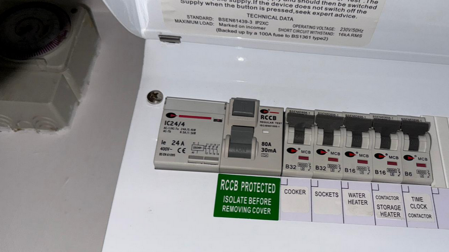

OK, we have now a little more info, seems you have two immersion heaters, one, the bottom one, will likely connect to the off-peak, and the top one, likely to some sort of boost switch.
There are many ways to do this, a timer like this
can allow you to select, but there are also some very clever devices like this
which I don't think will be the case with you, but we call it Economy 7, but that is only the tariff, the way we get that power varies a lot, sometimes we have two completely independent supplies, and other times you have a timer which decides when each element is supplied.
On another thread, we see 1739480716616.png showing a timer top left, which clearly works the relay to the left of the RCD, that works in this case three circuits which don't even come from the same RCD. So what we need is to know how yours works, smart meter, tele-switch, what?
What have you got to test with? An immersion heater can take hours to heat the tank, even a pen tester,
can help, you know power to cable in seconds rather than hours, I don't like pen testers so not saying rush out and buy one, but give us an idea what you have to test with.

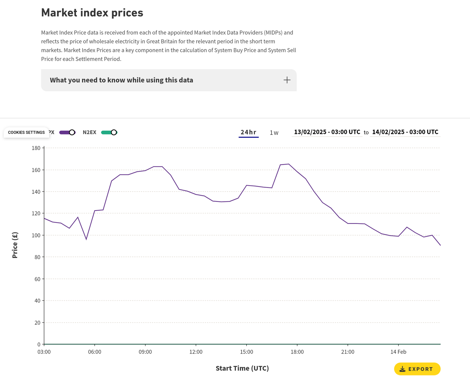

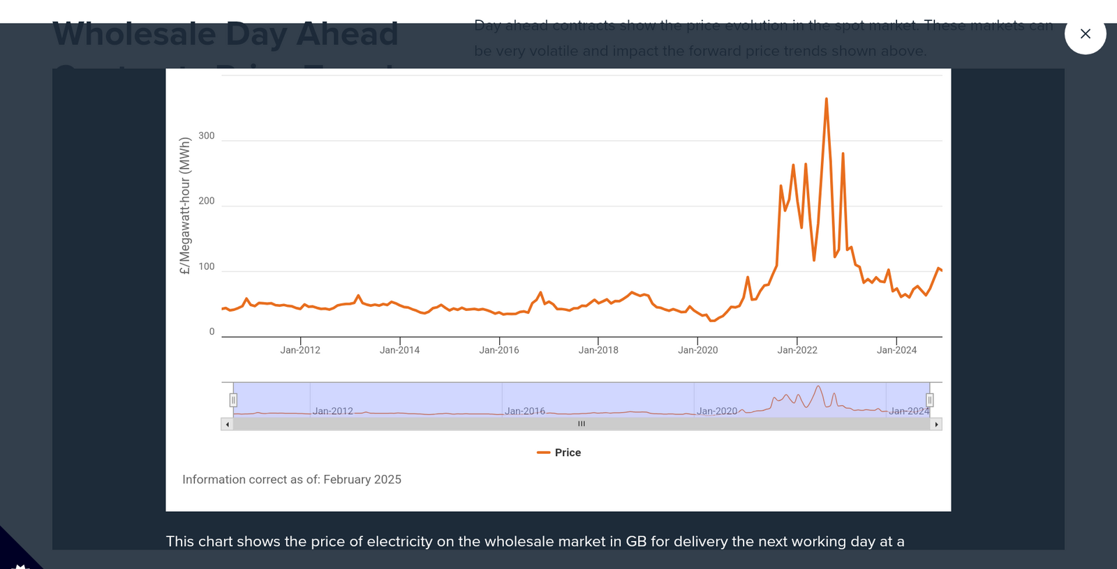

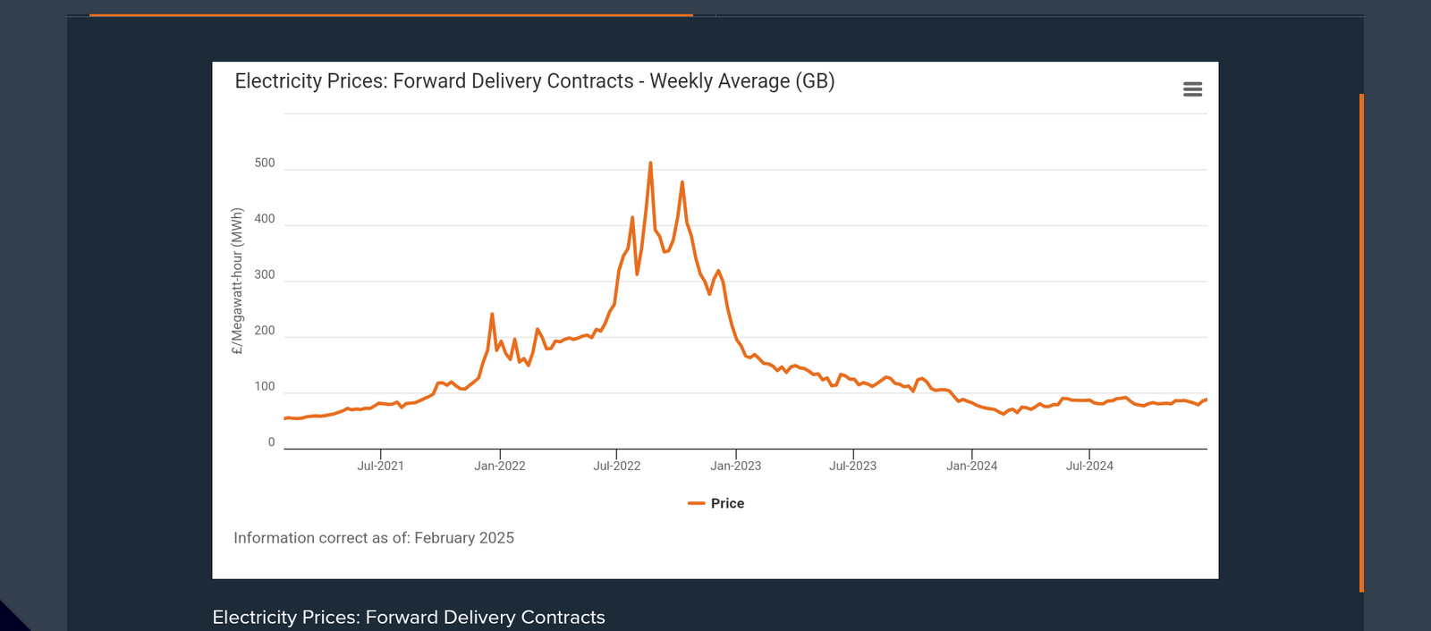

See if you can work out highest and lowest wholesale prices per kWh
(Source: OFGEM)
Here's a more current graph
(Source: Elexon)
Is it around 12p per kWh or have I got it wrong?
Long ago when I worked in the biz I remember it being 3p.
