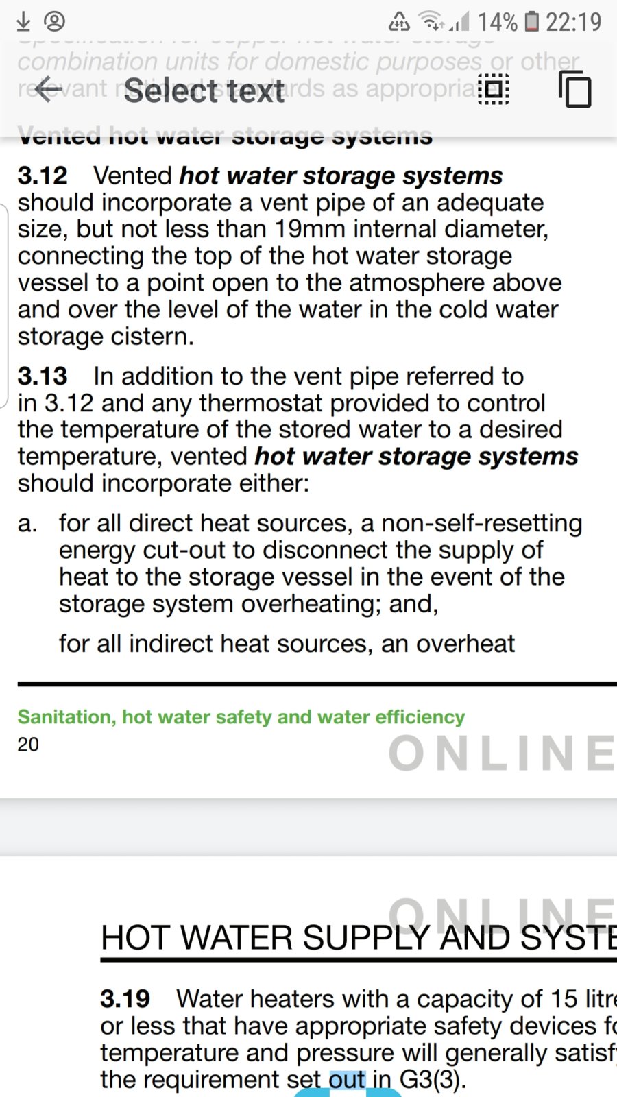

There was boiling water in the the cold water tank I dropped it from cold tank and the tank has collapsed . Can you give me the requirement in law about the immersion needing a cut out as I can use this against Dyno Rod that they should of done it when Plastic tank was upgraded ?
I am completely with everyone that it should of been done and if it is not a legal requirement and DR said we have changed the tank but we do not ahve to changed the thermostat by law but tod me the risk. I would of 100% spent £12 and changed it.
Anyone tell me if its a legal requirement as I have been told it is and it is not. If so please show me it in regs . I would be very greatfull ?
Yes I can see it here in the regulations but is this only for new installs. How would this fit in my situation. Should DYNO have LEGALLY changed the thermostat when they changed the tank. Yes or no will do please ?

I dont think, sadly, there is a requirement in law to check and/or upgrade any immersion not fitted with the new type of Stat. I can understand why you would think using a large name company should get you good service, sadly that is not always the case. Particularly with the franchises, they have to pay a lot of money up front to use the name, so in order to make any money, costs have to be carefully managed, and it's not always guaranteed you'll get the best people.

Got third part plumber out today. Was thermostat as already gathered.. But plumber got in loft. Tanks are ok. Reason hot water came through ceiling is the can't was not installed properly into new tanks. The new tanks was alot smaller so vent should of been extended . Which he has done and charged me. He completely disconnected the thermostat so it cannot get turned on by any current or future tenants. Only the boiler can heat water.
Ah, the plumbing jigsaw pieces now fit together diy (expansion pipe missing tank).
Regulations are not retrospective diy, hence, if it was legal when it was fitted it's still legal today (in spite of new different ones being more recently passed).

Yes that would go for the thermostat. But fitting a new tank without a adequate vent is poor installation. Resulting in damage and could of possibly been alot worse.
I'd gather the evidence of the poor quality job done by the previous people then and invite them to comment on it, given the damage caused etc. If not forthcoming with anything towards the cost of getting a third party in to finish the job properly, take the matter further. Personally would have had thermostat replaced for what it would have cost, but at least if disconnected, cannot be used without deliberate reconnection.
