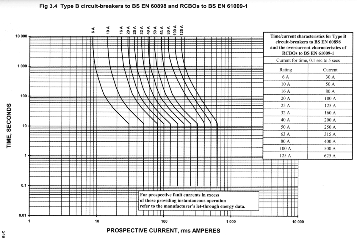

If one looks at the tripping curves 1684636717511.pngwith a 16 amp RCBO it would be reasonable for it to hold for around one hour with a 6 kw load. Likely each immersion heater has a thermostat, the normal would be for the lower one to be set higher that the upper as in the main two immersions are used with Economy 7 and the like, I know not using that here, but still likely set that way, with a modern cistern there is really no point having two immersion heaters unless using off peak, as the tanks are well insulated. But unless a lot of DHW is used, likely the top immersion will rarely switch on, and if it does, not for very long.

So the question is what is easy to test? I have a clamp on ammeter which would easy show it two heaters running, would also likely show leakage if I could put it around just the lives (line and neutral) and I also have a insulation tester which would show if water ingress was the problem, which I used would depend on ease of access.
Since @Licklieder has IR test equipment that would seem to be step one. Once that is done and we can rule out earth leakage, then we start on the rest.
