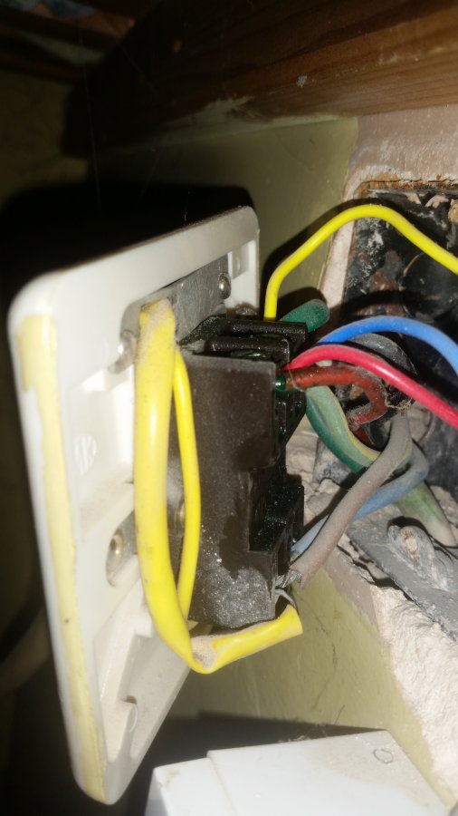

Hi, looking for some advice, I currently have an immersion heater which is run either by 24hr electric, ie no timer, or by a timer that links to our oil fired system.
Currently the mains goes to a 20a double pole switch, from this the main wire then goes directly to the immersion heater, but also from the 20a switch,they're is another connection to an isolator switch which goes down to the timer for the oil fired system.
This is fine if I'm happy to run off the oil, but is there also a way to install a timer for the electric side of it. On most systems you would wire this inbetween the pole and the immersion heater, but would this then override the oil heated timer.
Hope that makes sense.

Try again with the description. I have the mains going into the 20a socket. Live to L1, Neutral to N1 and earth is earthed . From L1 and N1, wiring going into a isolator switch which goes to Load L and Load N. Again earthed.
From here, wiring goes down to timer for oil system, via live and N Supply.
Also in the 20a switch is the live and neutral to the immersion heater which goes from the L2 and N2, again earthed.

So it's sound like I need to put the timer in-between the 20a switch and the immersion heater
Yes, that sounds right.

You appear to have an incorrectly wired set up - the proper way, as per the photo, is to have separated feeds for both the immersion heater, and gas boiler, allowing independent switching of each item, without affecting the other - ideally fed from separate circuits.
You can see there are two fused spur units, one for the Immersion, and the other for the Boiler above.
