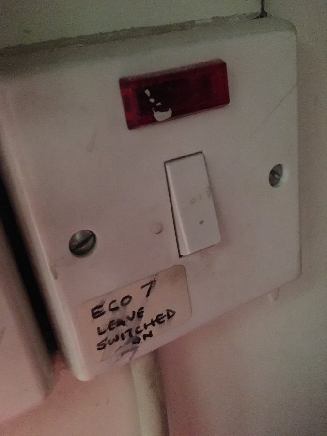

I'm having problems with my Economy 7 Immersion heater element. The element decided to pack up (RCD tripping) and therefore I fitted a new element. However the new element doesn't seem to work. When I switch on the Economy 7 plug the neon red light does not come on. I'm therefore struggling to understand whether this is a electrical or plumbing issue. The storage heaters in the house are still working and the Economy 7 section of the RCD does not trip.
If the red neon light should come on even if there is no appliance attached then it's something to do with the electrics, if it will only come on if an appliance is attached it's probably the element. Any ideas?
Cheers.

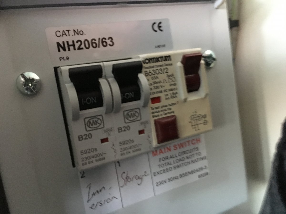

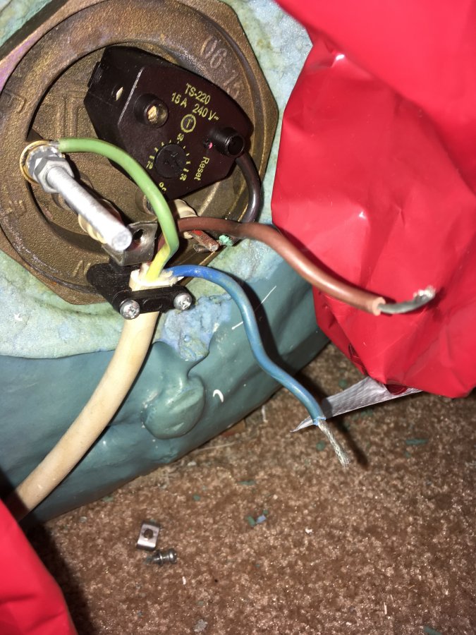

Could you post some photos of your fuse boxes, the element connections and the 'economy 7 plug'?
OP doesn't sound like you have much understanding of the subject. Might be wise to call an electrician. Prodding and poking at (invisible) electricity, with or without a meter could prove nasty!
Hi there. I have now tested the ac across the blue and brown wires with a multimeter and there is no current. I've attached photos of the wiring, economy 7 switch and economy 7 RCD. Any further thoughts would be appreciated.

You should be testing for VOLTAGE. Between the earth connection and each supply wire.
But you can do that with the element wired up.
It is somewhat dangerous with loose wires when turned on.
With nothing connected you can measure the resistance of the element and the continuity of the thermostat.

Your economy 7 supply will only be live at certain times of the day, location dependent, therefore you will have no voltage until these periods, no point testing until these times (some meters have the time on them). As Tony mentions though, you can test for continuity to see if there is any damage.
The circuit needs to be systematically tested from the element and thermostat back through to the CU but I wouldn't play around with it IIWY, and with respect it doesn't sound as if you have the experience to do this safely and could cause yourself serious injury.
