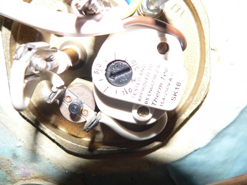

My hot water is only heated by an immersion.
When a new tank and immersion were fitted about 1 year ago I started to get problems with the thermal cut out on the immersion being triggered at random stages during the heating process. Sometimes this would be even with the temperature of the water still only tepid.
I understand these thermal cut outs are a fairly new safety requirement.
I was able to initially solve the problem by not using the shelf immediately above the top of the immersion in the airing cupboard. More air seemed to thus circulate and stopped the thermal cut out tripping.
Now despite the same setup it has started tripping again and I keep on having to reset by pressing the little black button down again.
The immersion is a Thermtec Type HS 3kw.
Can anyone help with this problem please?
If I replace the thermostat which I believe can be done without needing to remove the immersion itself or drain the tank does it need to be the identical make of thermostat?
It just needs to be the same length, ensure the power is off and then undo the two terminal screws on the top of the stat, remove the wires and slide the stat out and measure it, they are normalls 7" or 18"
Thanks for this. Whats confusing me though is that this thermal cut out does not seem to be integral to the thermostat. It is mounted on top of a brass "lump" next to it with the wiring going through it. Does this make any difference to changing the thermostat to one of a different make to the immersion?
post a picture, the stat normally has the reset switch on it, a dial and two terminals for the live in and out

It was fitted by the plumber so don't have a receipt for the actual immersion etc. So does this type of thermostat have to be replaced like for like or otherwise replace the whole immersion?

Thank you for your comprehensive reply.
Are you saying that it is not possible to just replace the thermostat and thermal cut out with this type of immersion. I understand that can be done without removing the immersion and draining the tanK?
9 times out of 10 the immersion is corroded and needs changing. I always change the complete unit, it saves 'go backs'

Thanks - The immersion (and tank) is only about 15 months old and previous immersions have lasted at least 15 years. Is it absolutely not possible with this model (see picture above) to replace just the thermostat or even just the thermal cut out? If I can would it have to be like for like or could I use a different make of thermostat that has the thermal cut out on the thermostat itself rather than to one side where it seems to pick up excess heat causing it to trip?
