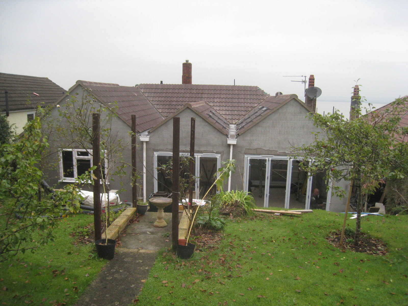

The problem with bungalows I have come across is a wide extension with a single ridge roof results in a ridge too high and would look ridiculous.
I designed this one a few years back. The clients absolutely love it inside. Light, airy, interesting and a talking point apparently.
