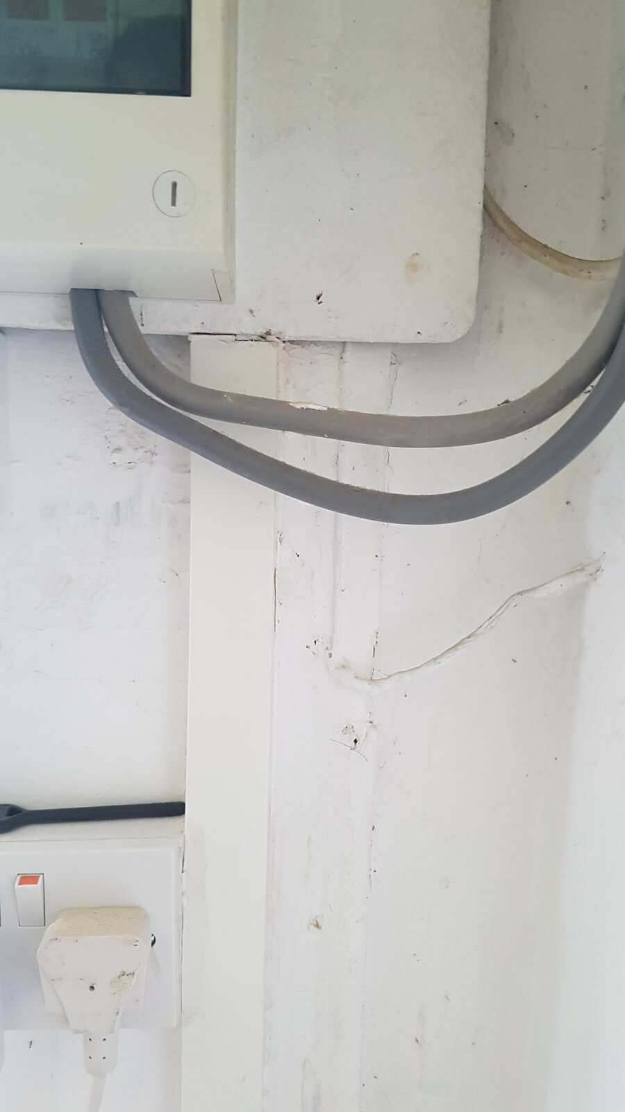

Electrician did checks. Wiring fine. Upgraded the MCBs to be rcbo's (only the exterior socket had a rcbo)
Used a left over mcb on a redundant radial to power one socket in the pantry to run the fridge/freezers, just in case of nuisance trips.
Do you mean that the circuit servicing the fridge/freezer does not have RCD protection? If so, do I take it that none of the cables of that circuit are 'buried' (in walls)?

Correct.
The circuit is maybe 10cm in trunking from the CU to the double socket.

Correct. The circuit is maybe 10cm in trunking from the CU to the double socket.
Fair enough - but do you really mean 10cm?
We have had a freezer related trip/loss of an upsetting amount of food in previous house. It seemed like a good idea. Thoughts?
Most people probably would have some buried cable, which rather changes things. A dedicated RCBO is then probably what they would have to consider - although that would then leave the freezer at the mercy of 'nuisance trips' (which seem to be a problem for some people, even though not for me!). A 'non-nuisance' trip of the RCBo is not much of an issue, since it would usually mean that something had gone wrong with the freezer, anyway. The only obvious alternative would be to use something like SWA for the buried cable, or to have the cable in metal conduit (so as to preclude the requirement for RCD protection) but most would probably regard that as too much hassle!

Ok, maybe closer to 30cm
I do see you point about using the rcbo downstairs ring would notify us of a trip.
However, the circuit was already there so quick and easy to do.

Fair enough (although the photo is not very clear!).
