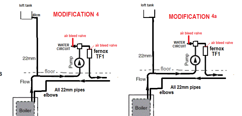

hi,
i've had someone look at my heating system recently and he wants to combine the feed and vent pipes to help eliminate the air and other problems i have been experiencing over the last year following a boiler and pump upgrade.
he also wants to remove the vent. arm above the F and E tank which i'm unsure this the right thing to do ?
here's some drawings of my system and possible modifications:

the system is 35 years old and a Y plan, i don't think it has a bypass valve fitted.
there are 8 rads. with just 3 trv's fitted in the bedrooms,
the boiler was upgraded several years ago along with a filter and new pump.
i have had many problems , my main concern is air getting in the system also in the winter i'm having to continually adjust things to keep it running.
i have done everything i can to the rest of the system so now i'm thinking to improve the pipework around the boiler,pump and improving the feed and vent ?
please advise ,
chris
I would go with 3 or 4 but move the filter to the return.
4 and leave the filter because there don't look like room for it on the return. Has the boiler been fitted with the F+R correct ???? not unknown for them to be swapped

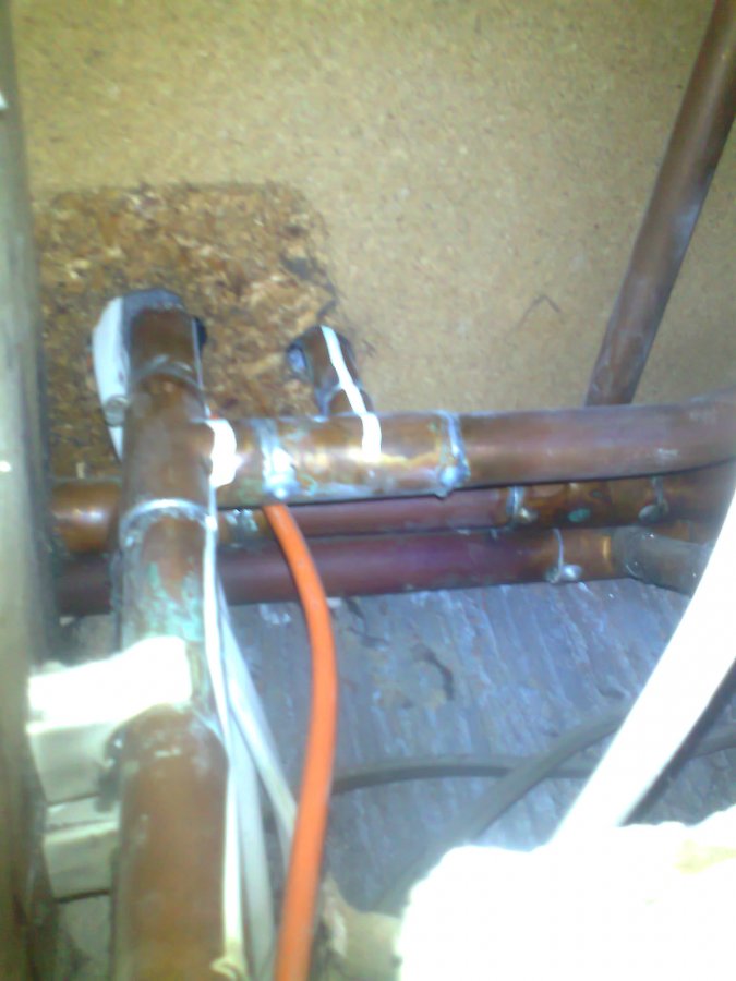

i'm 99% sure the F & R are the fitted right way round but i will double check when the ceiling gets cut away more to replace the pipework, the guy that came round is a working plummer, but he has never worked or seen mine before.
the stage i was at last week was thinking that i have a leak somewhere pulling air in, so i got some F4 leak sealer to put in but he thinks a reconfigure is the way to go.
i would prefer not to move the filter because it will end up very close to the boiler and will be difficult to access when i fit cupboard in etc, but i believe they protect the boiler better that way and also if i do that maybe one day my airing cupboard will be free of equipment if i remove the emersion tank and move the pump abit (thinking to get an instant water heater if i still have problems with heating system).
what about leaving the elbows on the returns ? will that affect the flow much and getting heat around the system etc ?

Have you checked for magnetite blockage in the existing pipe work? This would cause all your symptoms.
If the air is believed to coming into the system from the vent pipe then as a trial fit one of these to teh end of the vent pipe over the tank.
http://www.hepvo.com/
This will allow the system to vent but will prevent air being drawn down the vent pipe.
Does the boiler have any air bleed valves in it or between it and the pump ?. Some of these, especially the automatic ones, will allow air to pass backwards through them and into the water when the water pressure at the valve is less than atmospheric pressure outside the valve
Your system is a bog standard y plan so I am bit surprised your "plummer" has not see yours before, if your pulling air in I would check the feed is not blocked before changing pipework.

yes if i get a magnet there is a small attraction to it at those tee's but i don't think they are badly blocked ?

how would i check the feed insn't blocked ? if i'm cutting any pipe in that area i may as well renew and improve it at the same time.
i think i'll do no . 4 modd and see if it's any better this winter,

the plummer that came round said i don't need a vent pipe as longs boiler has over temp. and the water in the F & E tank is kept low.
if i do the modd no 4 is it better to relocate FE tank to make 4a or is a 40cm piece of horizontal pipe ok ?

I'd cut out and replace all the pipework where the magnet is attracted before doing anything else. You may be surprised how 'not badly blocked' they are! Its definitely air you're getting out the rads? (Not hydrogen!) What inhibitor is there/has there been in the system?
