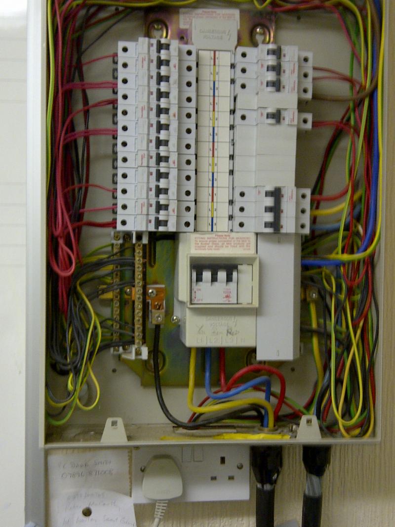

My distribution board is a Bill Talisman Plus with a 100A T13SD 3 pole incomer. What can I replace this with so that this trips rather than the one in the depot.

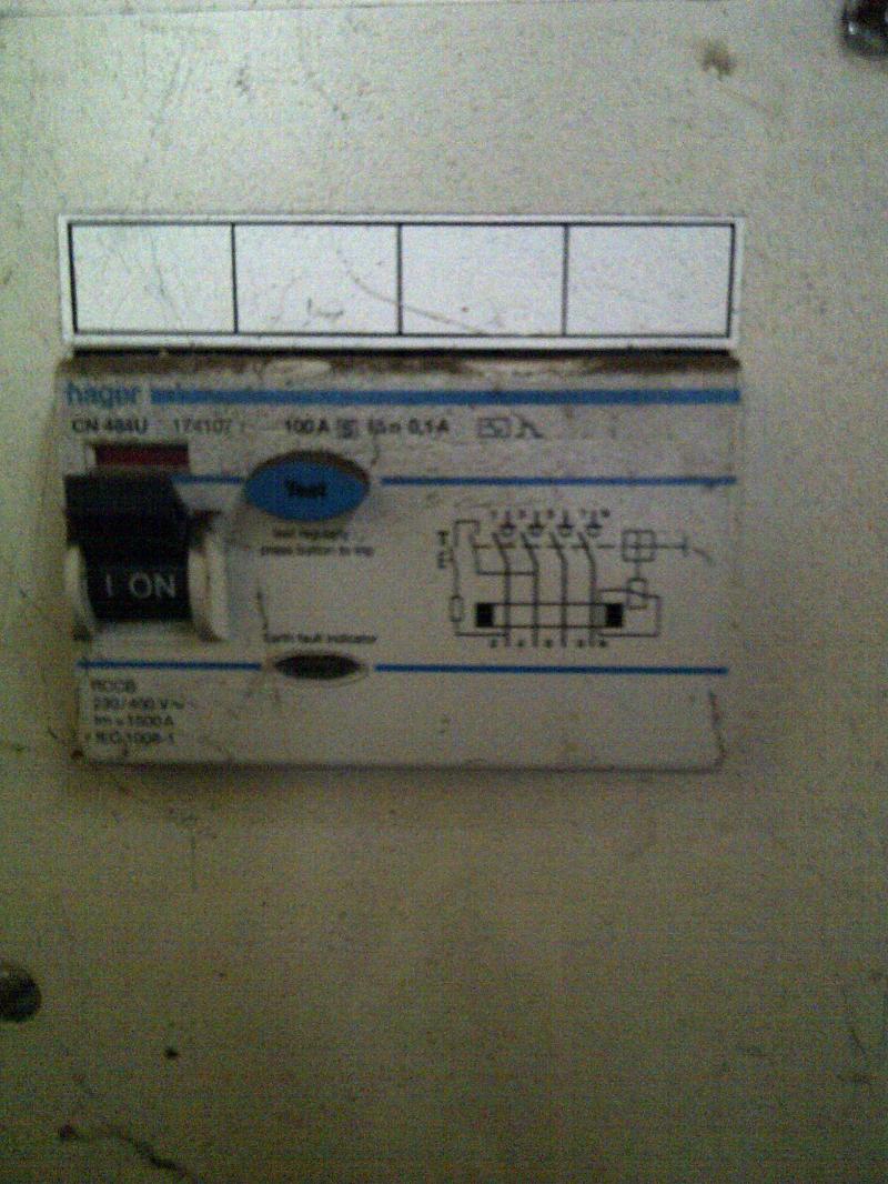

Depot Trip. Is a Hager CN484U 100A, 100mA trip RCCB
Main DB, Incomer is Bill Talisman 100A T13SD
The R/H armoured cable is fed from the lower 3 breakers on the R/H bank and feeds...

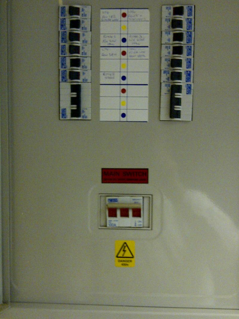

Hall DB. Incommer is Proteus 100S3 AC22b

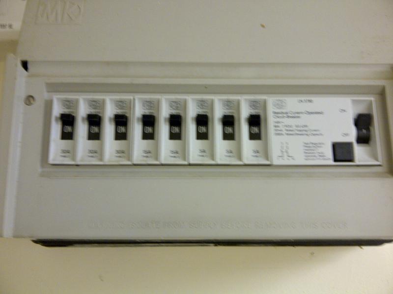

Lower Grnd DB. Incomer is MK LN5780 80A 2 pole 30mA trip
Activation of this test button does not affect Depot Trip

Is the rating on the rcd in the other unit 100mA trip?
If so you could fit a 3 phase 30mA RCD to the main incoming tails. or swop the main switch in the bill board for 30mA RCD from EATON/MEM.

Putting a 30 mA RCD in your premises will not ensure that the RCD in the depot will not trip on a fault in your premises. It will reduce the chances but not eliminate them. It is possible that when your RCD opens on a 30 mA fault the action of opening 3 phases creates a transient "disturbance" that the 100 mA RCD in the depot may react to and open. The mechanism is that the "disturbance" as the phases disconnect creates capacitively coupled earth leakage currents. The more wiring there is ( more phase to CPC capacitance ) the more likely that both RCDs will trip.

If the Supply is TN and the loop impedance is in spec (and if not, why not), then an RCD to the buried cable is not required, the cable is protected by the fact that its SWA and any digger bucket, etc that goes through it, will contact the armour first before any phase and ensure that a fault to earth is created the fuses are cleared.
If they however insist on having some RCD, then you could perhaps try and persaude them to swap it for a time delayed type (either 100mA as the present one is, or even better, 300mA), then at your end 30mA main incommer, this should be sufficent to acheive discrimination although not the nice-ist set up in the world
