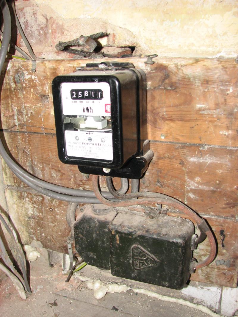

I bought my house about 5 years ago, the consumer unit had just been replaced but there were still a couple of lights (1 under the stairs & 1 outside) wired to an older box. I removed the old box and wired it into the new one some time ago. I noticed that the supply into the house (1930s) which runs between the party wall and pops in just above the meter has damaged insulation. The cloth outer is completey missing on one section?. Is this okay? The other thing is that I have no earth. I have an earth connection to the incoming lead water pipe, my side of the gas meter and the rest of the internal plumbing. Is this enough? There is certainly no earth connection to the metal main fuse box (not my side of the meter). Is this a problem? Is it my problem? What should I do?

Can you post a photo of the service head, and the earth cables?
Is the main switch on your CU just a switch, or an RCD?

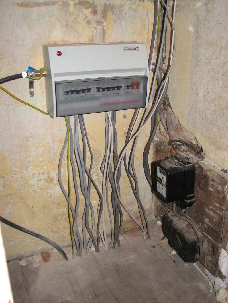

It's a split load CU with a switch and an RCD. Trying to sort a picture now.

The earth wire that exits the CU to the laft goes to the water and gas, The one that goes down goes to the central heating etc.
The SWA goes to the shed.
The earth that you can see here is the one that goes to the central heating etc. It just passes behind the board that everythin is fixed to.

Don't panic. But that looks like very poor workmnship, no cables fixed down or protected, incorrect earth bonding on armoured cable in side of CU, just from a quick look.
If you are concerned, contact an electrician registered with a competent persons scheme to carry out an inspection and test (PIR)
Neil
An electrician will not touch that. if it is BEFORE the meter.
That needs the DNO/ electric board to sort out,
If you feel that it is unsafe you can report that as a dangerous situation and they will come out eventually.
However if they arrive and it is not, then they might charge you.
they will proberly arrange to replace that old metal supply box as well.
Do not attempt, to ever open that, yourself
What is going on with that earth clamp on the gland?
Looks like that's your supply earth, so it should go the/a main earth terminal (which could be inside the CU, but is often external).
Then the earth for the circuits runs from the MET to the CU, and the main bonding for the incoming services runs from the MET to the services...
Is it possible that its been converted to a TT (earth electrode) supply via the swa cable?
