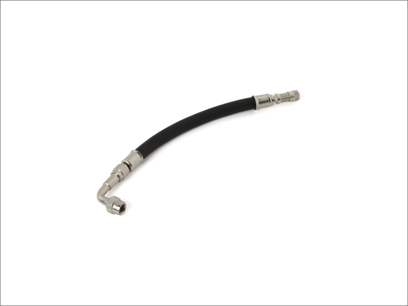

The engineer showed me that that plastic pipe from EV was suspended (not connected anywhere). In terms of charge - engineer who came a few days ago said EV pressure was low, so he topped it up to 1 bar.
Plastic pipe from EV? Are you sure you're not talking about condensate? I very much doubt BG would do such a blatant thing. Suggest you call BG service and explain the situation and let them come and inspect. I'm sure your boiler comes with 2 yrs warranty.
If the expansion vesel wasnt connected the pressure would be all over the place, can you post up a picture of the plastic pipe from the expansion vessel ?
I am sure. He took the condensate box out and he specifically said that EV is not connected. He showed me an orange cap on top of EV and there was like ~inch long flexible pipe coming out of EV and not connected anywhere.

Sounds like BG engineer has left his extension hose for charging the vessel on the vessel TBH ;)
