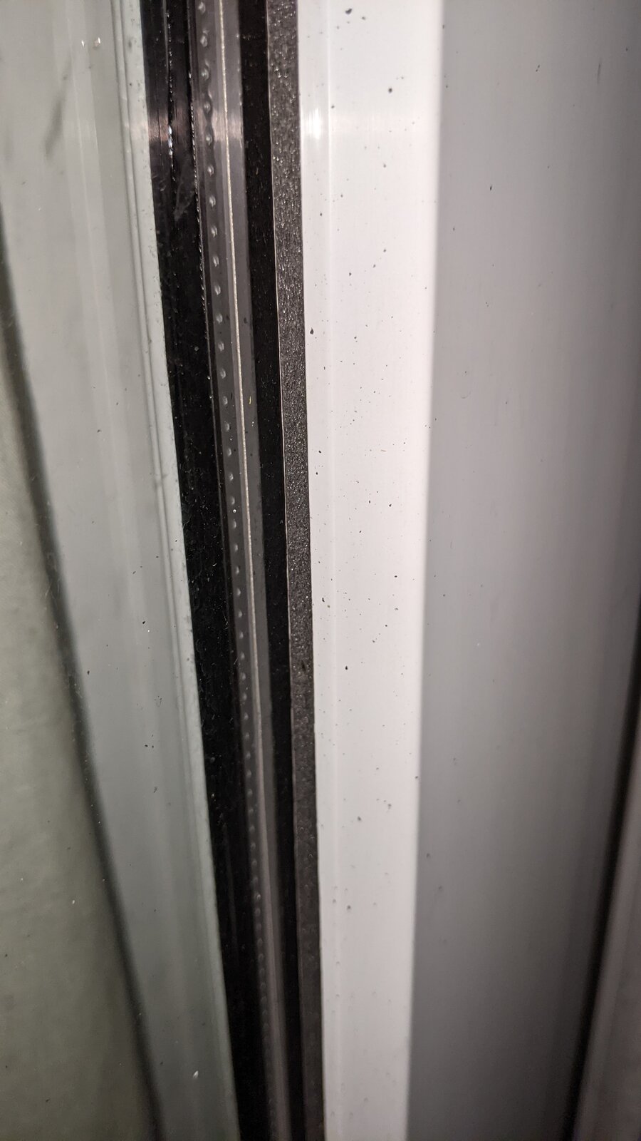

With this bout of bad weather the UK is experiencing at the moment, it's reminding me of things leaking that I really need to solve in my house. One of the leaks is my french doors that open inwards.
I suspect I have 2 problems, but I'm not that experienced with homely matters, so would value some feedback.
Basically, it looks to me that the doors have been installed incorrectly. I've come to this conclusion from the following:

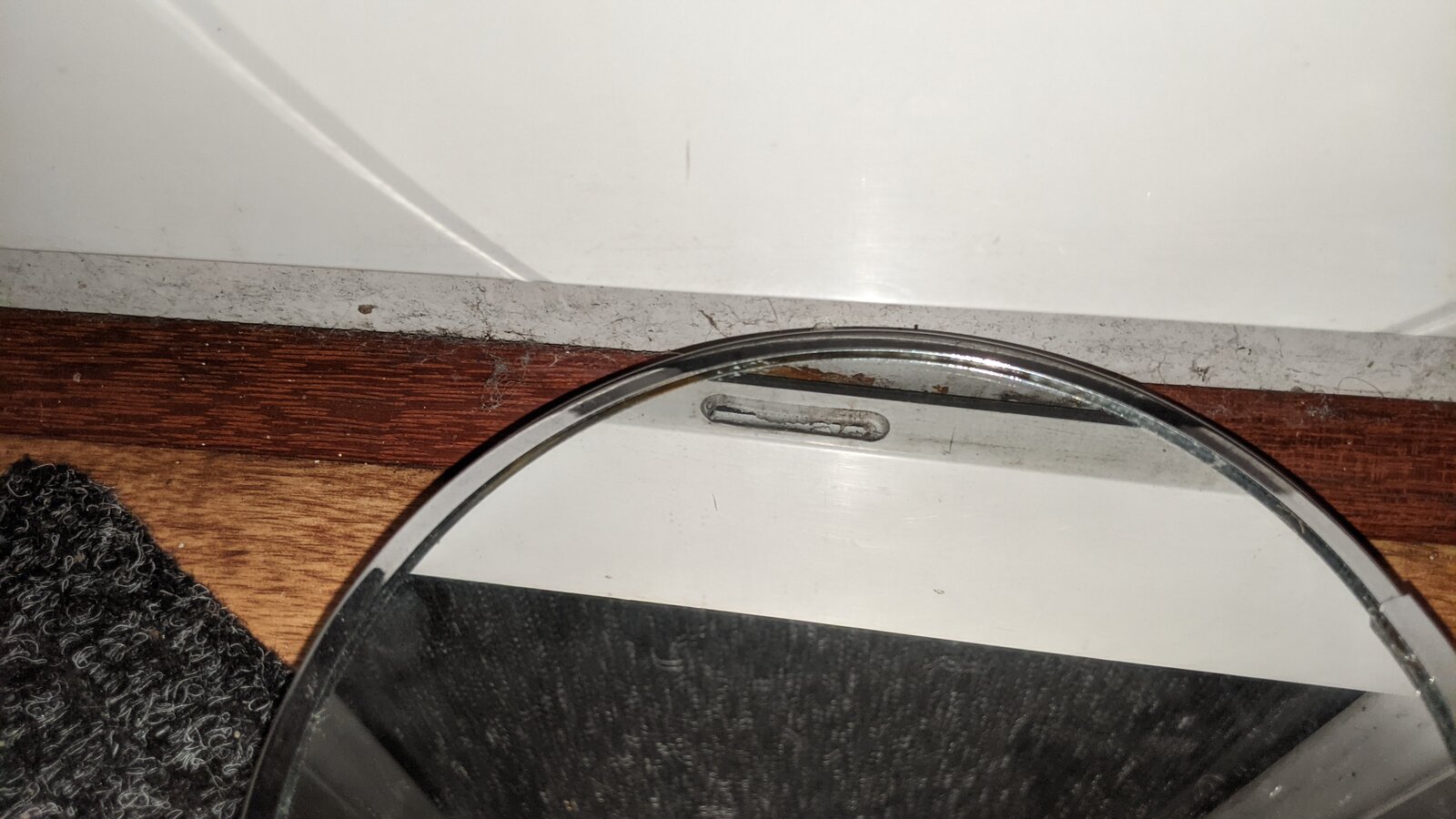

1) There is a drainage weep hold on the 'inside' side of the door, which is just weeping water onto the inside floor.

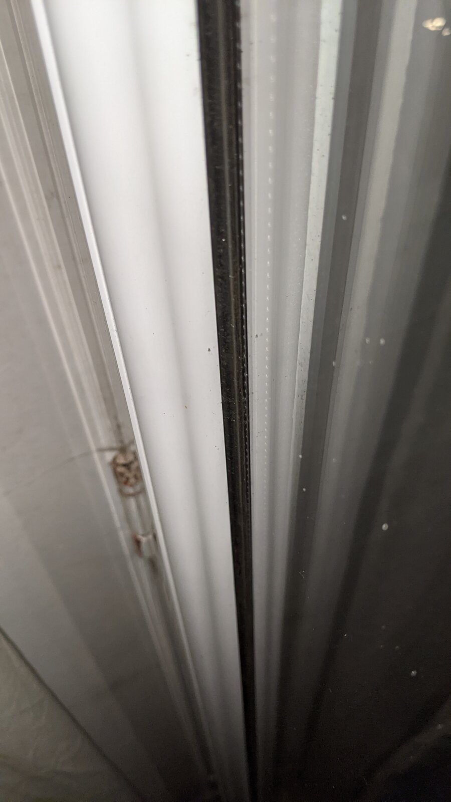

2) When looking at why there was water needing to come through this hole, it seems that the seal (if you can call it that) around the glass on the outside is just, what appears to be, foam. On on the 'inside' it's rubber.
I've taken a couple of pictures to show what I mean:
1st is of the outside foam
2nd is the inside rubber (not the clearest)
3rd is the hole on the inside of the door.
https://imgur.com/a/DXRrAAb
Does it look to be installed incorrectly? If it is, I suspect that the only way to fix, is to remove and switch it around, so that it opens outside.

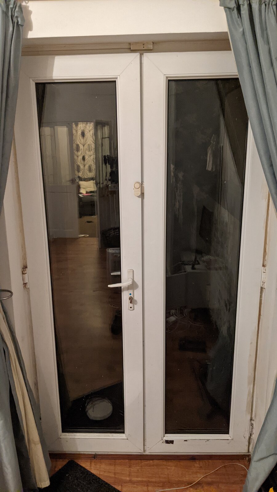

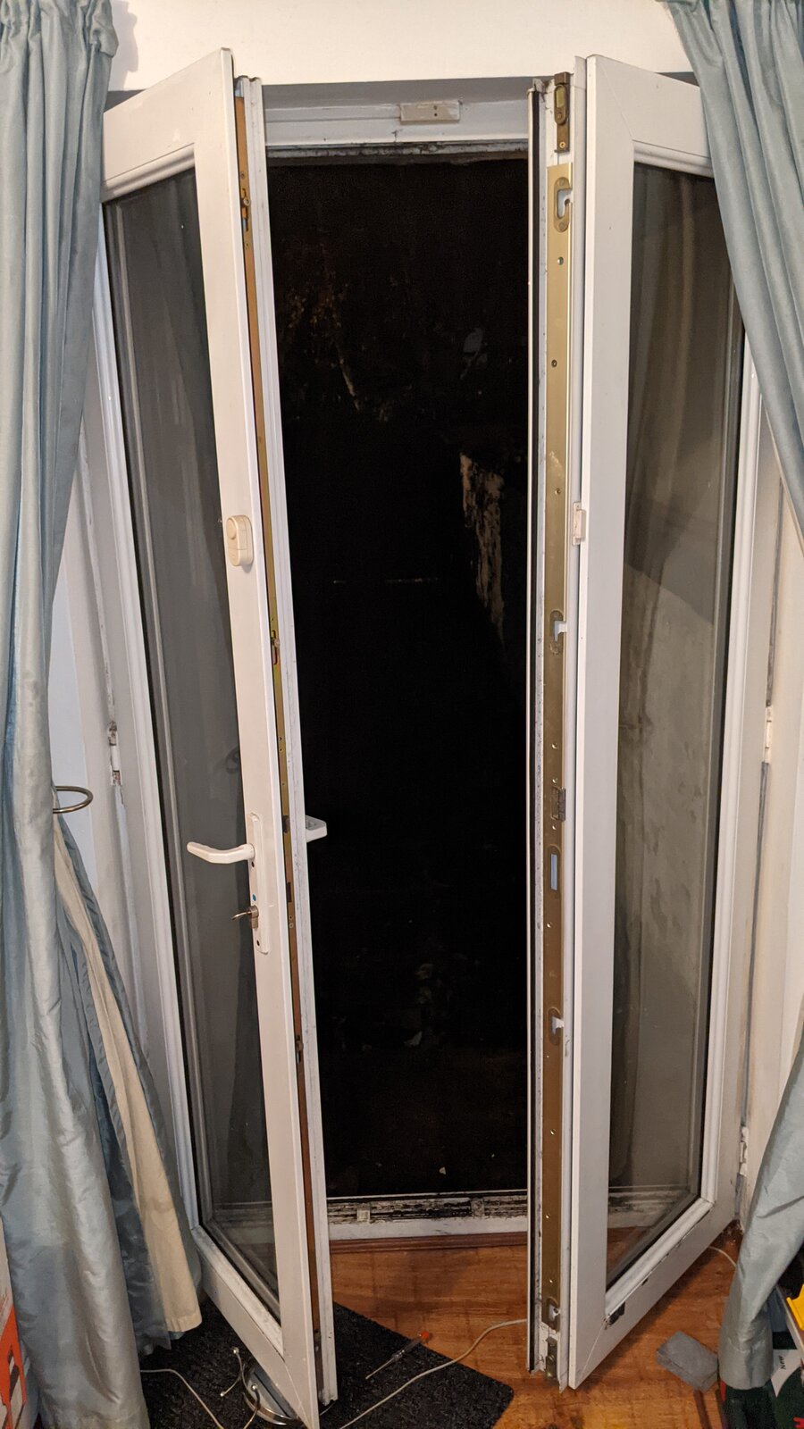

Are you saying your french doors open into the room?
it’s not clear from your pictures what’s what, try to take a photo showing the whole door, one with door open showing the cill.
Try to attach them to your new post, if you scroll down you can upload images, add them as thumbnails, will be easier.
(y)
just thought, is it a conservatory?
Yeah they open inwards.
I've taken more picutes and will upload and edit the post, thanks.
It's just a door into terrace side return (think that's the right name)
I would have thought the rubber gasket should be on the outside.
The weep hole, should also be on the outside.
Someone will be along to give you a professional opinion, I have got any doors similar to compare, mine are wood.
Looking at those , yes they are round the wrong way. Drainage holes should always be outside ( for obvious reasons lol ) , and I don't think I've ever seen the foam ' security tape' put to the outside on upvc. My guess would be that because they would be ' externally glazed ' when turned around d , someone thought they weren't safe/secure, so switched it. Externally glazed with good quality security tape should be fine....worst case when you switch it round and remove the glass, cut all the security tape out ad when reglazing use wedge gasket instead .
