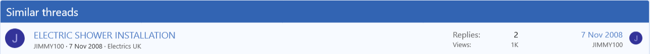

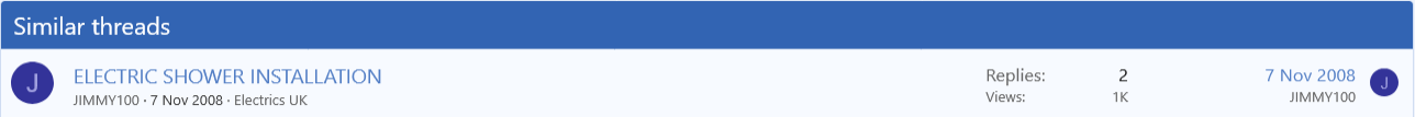

We see quite a lot of this, and I think the list of "Similar Threads" at the bottom of each page of messages (seemingly without any regard for the age of those threads) probably has a lot to answer for!
Yes, realised it was old when I saw @ban-all-sheds answer, I was surprised when we bought this house, 60 amp supply, two kitchens, three bathrooms with as a result two electric showers, but never blown the fuse. Think unlikely as basic two homes, main house and granny flat, and granny flat only used for visitors.
2008 so just into 17th edition, and below that 2005, power shower. What sometimes worries me, is valid answers when 16th edition was in force, are no longer valid.
