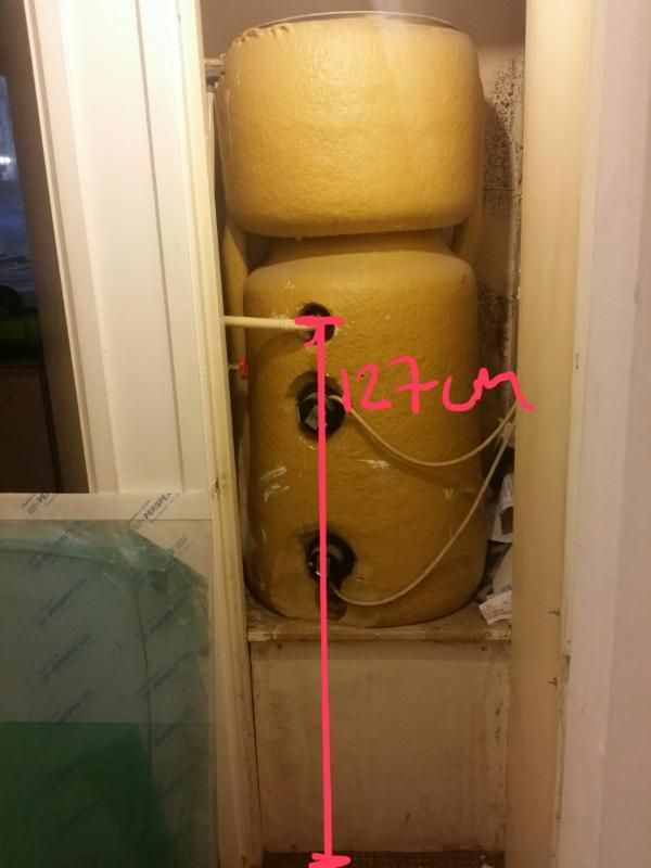

Okay so here is the tank:
I measured the height of that middle pipe its 127cm, the Sink tap end is 111cm off the ground.
I worked out it takes 58 seconds to fill a 2 litre bottle of water.
So anyone know what i need to be increasing by?
The 'head' of that system (for the kitchen tap) is the height of the top of the water level in the upper tank less 111cm. The height of the hot water feed coming out of the tank (127cm) is irrelevant.
Oh i see, so i am guessing around 50-70cm is the head.
I dont know much about the tank, just that it has a lid on the top that is loose, and it is cold water in the top.
Do you think given it has head (good or bad?) the issue is something else?
