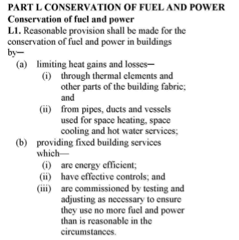

If such a law exists then it cannot possibly insist such an impossible task is performed. The first time it is exercised it will laughed out of court by the technical experts. ... Im sure that Eric is misunderstanding the detail of any such a law.
I strongly suspect that, in a manner which he is often guilty, eric is probably confusing Approved Document L ('guidance') with Part L of the Building Regs ('the Law), since the only (very vague - absolutely nothing about any specific detail) things that 'the Law' (Part L) says are ...

I had indeed read the approved document, and had also noted when looking for a new house how many seemed to have two zones which seemed to be controlled with a valve which is either open or closed.

As I said before, it's a bit ironic that, in the context of such a discussion, one should be talking about usage patterns which surely represent anything but 'energy conservation'.
I realise that 'the Law' (i.e. Part L of the Building Regs) can only consider the design and construction of a building and its heating system and that (since we don't live in a 'police state') cannot control how householders choose to use their heating system, but to leave heating 'on' (even if 'turned down' a bit) for long periods when not 'needed' (seemingly, in the case you cite, around 14 hours per day 'upstairs, and maybe 8-9 hours per day 'downstairs'), simply so that the areas do not 'take too long to warm up' when needed is surely the antithesis of 'energy conservation' and, I would have said, not really compliant with at least the spirit of the law - particularly L1(b) of Part L. If the law requires that the systems should "...ensure they use no more fuel and power than is reasonable in the circumstances", the law probably also assumes (intends, hopes!) that householders will not negate that by engaging in energy-wasting usage practices?
In my house, I have 'frost control' which will over-ride anything else if the temp in any zone falls below about 5°C but, other than that (and unless there are extremes of weather conditions), when heating in a particular zone is not required, it is turned off (not just 'down') - and it very rarely takes more than an hour or so to 'warm up' the zone when required (as you've said, under normal circumstances, temperature in a house is surprisingly well maintained, particularly 'upstairs') - and I'd be surprised if that practice doesn't use a lot less energy than would be the case if we kept zones 'warm' when they did not need to be heated.
