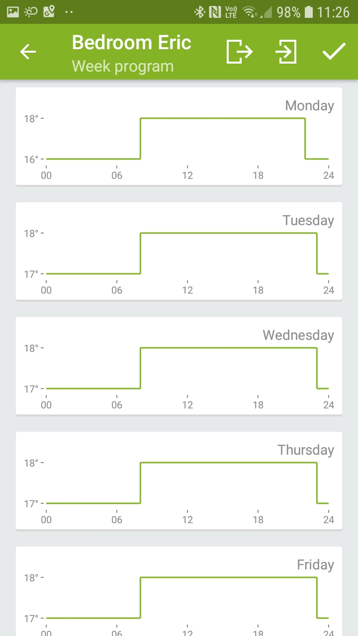

If the same radiator always got warm, I would blame the TRV, I would assume not shutting fully, but it is random which radiator gets warm, the valves open fully at 12 noon Saturday, that is when the TRV's exercise, however not at this time or day when the got warm.
All the electronic TRV's you hear from time to time adjusting, but at moment set to 16°C at night and 17°C in the day and in last month the temperature in house has never dropped below 20°C so they should have only opened when scheduled to exercise.

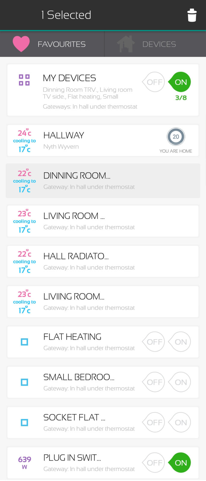

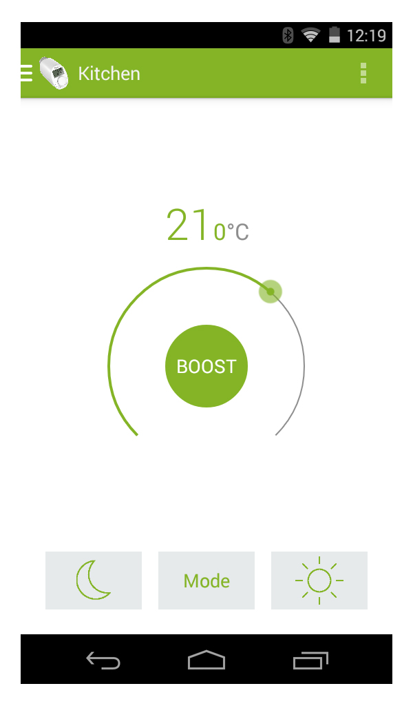

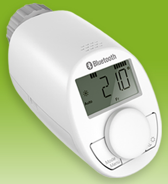

The Energenie thermostat reports both the target and current temperature quick check today entry level floor is 18 and 19 deg C and target 17 deg C. However the cheaper Bluetooth TRV's don't report current temperature, 61dmtMm13BL.jpg there is a display on the valve, however hard to read in place, 510VC3xAYwL.jpg so phone it what I use to set valve, Screenshot_20190725-112626_calor BT.jpg so the valve in real terms is set then forgot, once the motorised valve is fitted I will set higher temperatures but set low so I do not get thermo syphon when the DHW is heated. Away from house I can access far less, however don't really need to access anything when not home so this
is the away from home report, not sure why I would ever switch off top one My Devices, the next Hallway is the Nest thermostat on the wall, next 4 are the 3 entry floor rooms, two radiators in living room, and they are set to auto follow Nest, flat heating is no more, it was a socket that supplied the pump in flat as with next 2 the sockets and light switch have not been fitted in this house, sockets built into an extension lead. The last one Plug in Swit is a switch and monitor which has the portable air conditioner plugged into it only a small one as you can see only uses 639 watts when running, this is about the only item on the list which I will access when not at home, and get the room cool for when I arrive home, and it is in fire place venting up the chimney so well away from the radiators, so although radiators show 23 degs C the centre of room far cooler.
Although I am able to turn central heating off/on away from home, I have never done so, I will look to see temperatures of the three rooms, but only to see if I need to switch on the AC before returning, not the heating, the 5 bluetooth TRV heads are set and forgotten, and since never done a winter with bluetooth heads don't know how good or bad they are, I have run a couple of winters with the wifi controls.
