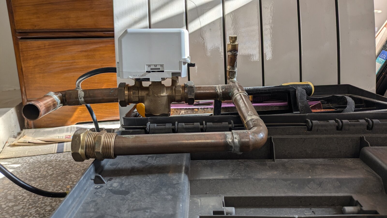

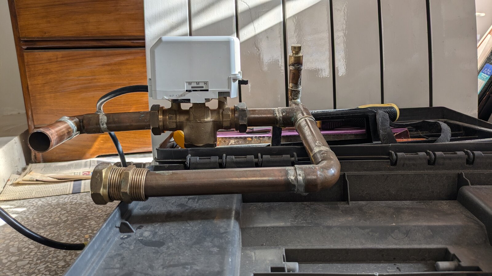

I have bought the cylinder, will hire someone to do the pipework. I have attached a photo of pipeloop with mid position valve which I intend to utilize with cylinder installation.

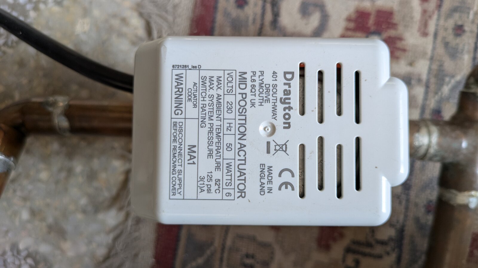

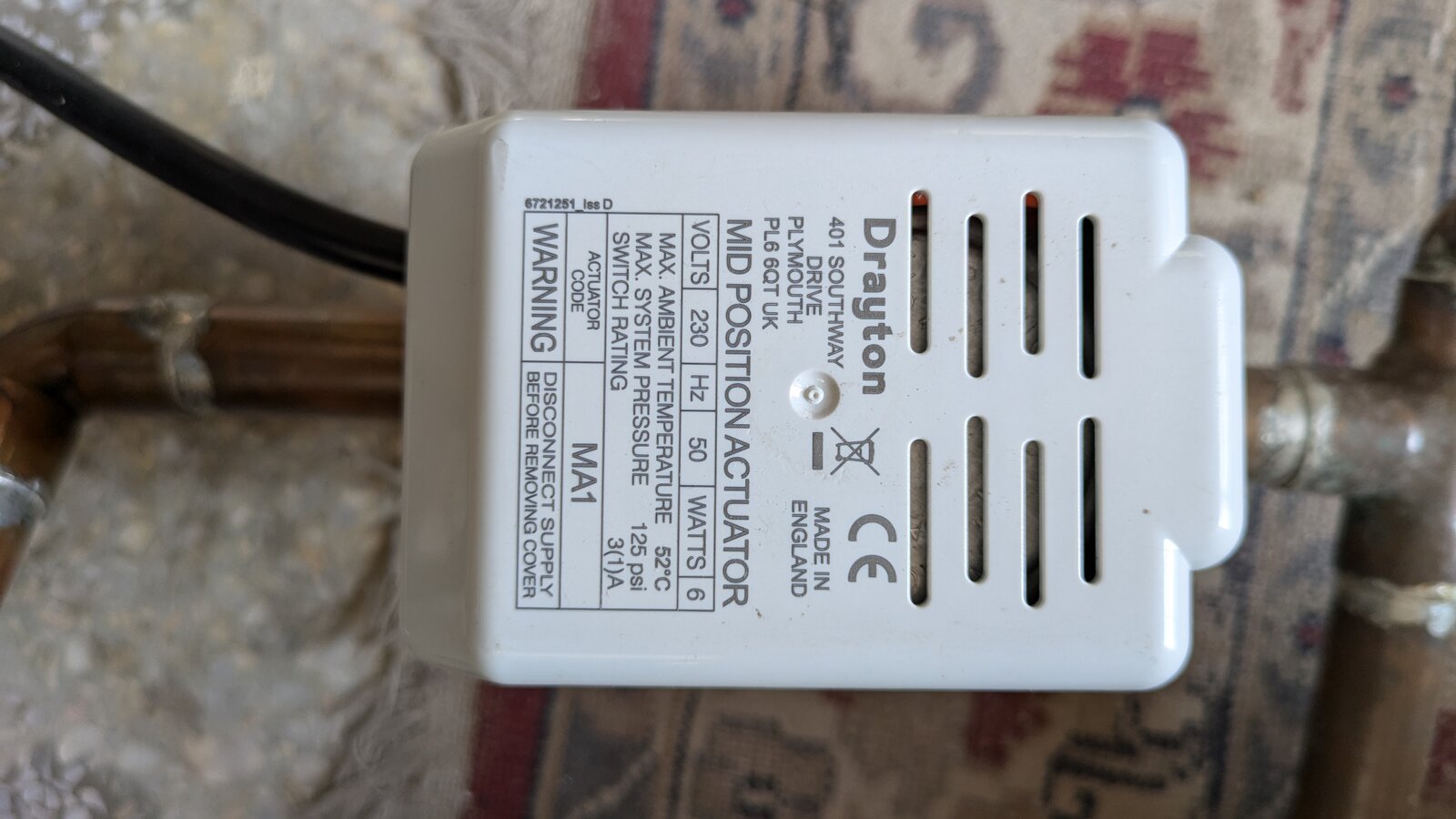

The mid position valve is drayton (see attached picture)

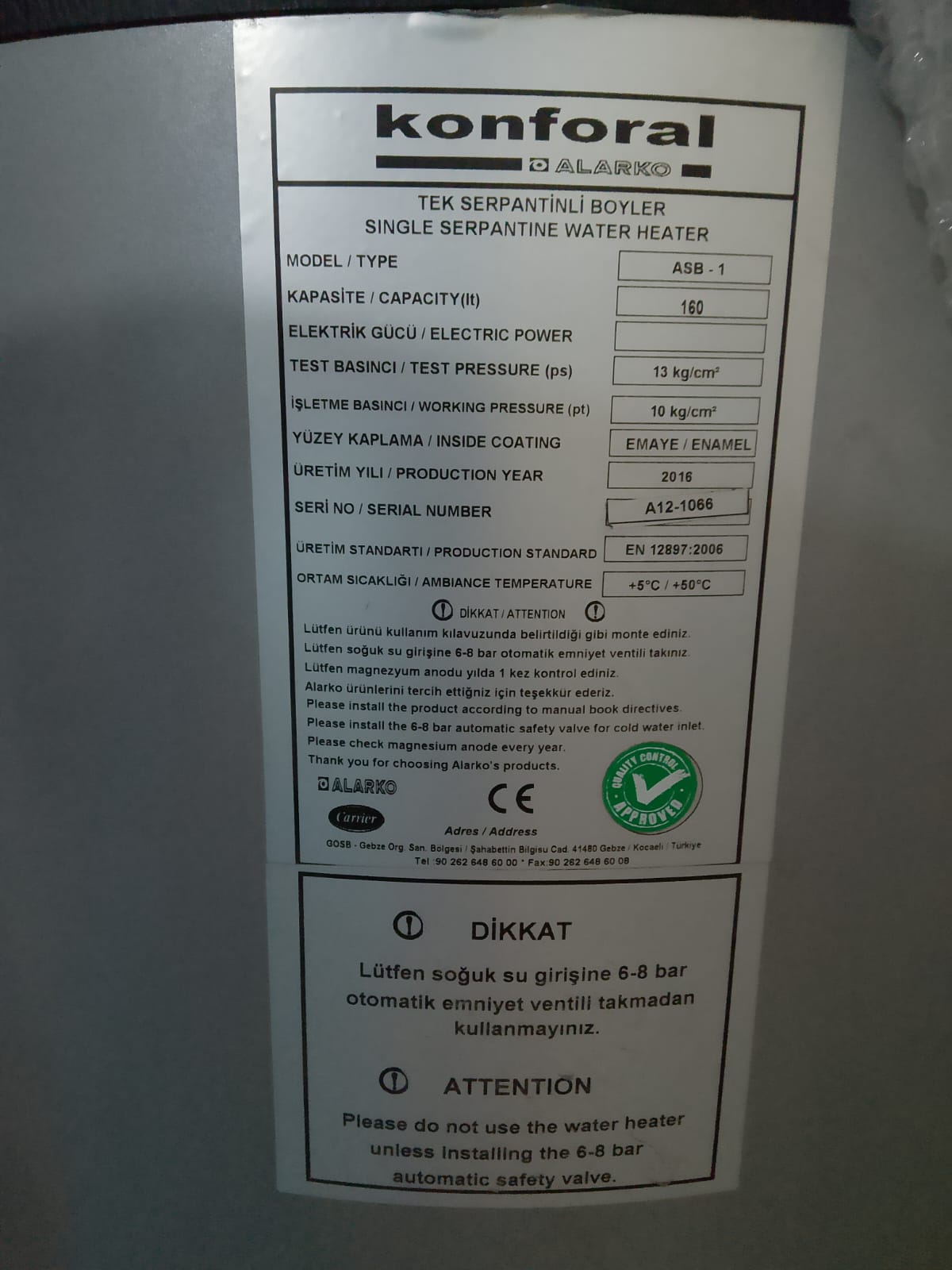

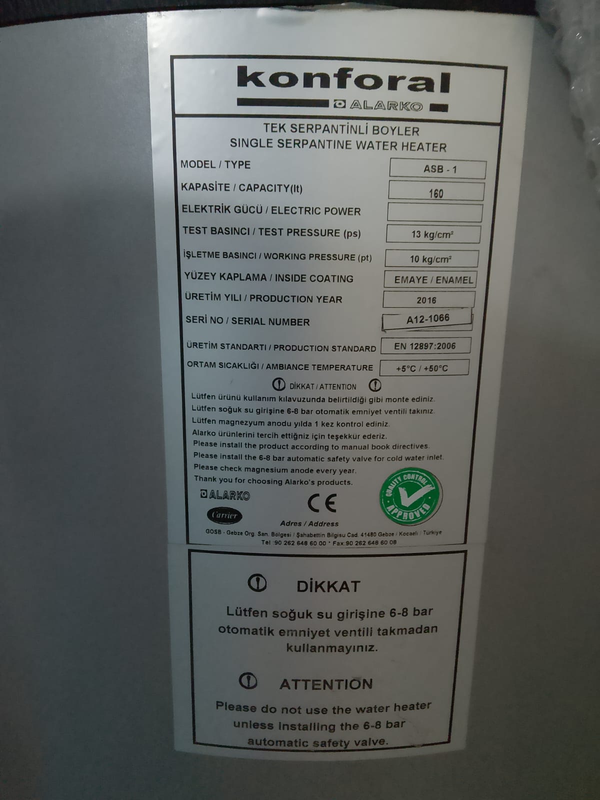

I have bought a 120 litre indirect water cylinder.
Vented or unvented?
I'm pretty sure the operation and wire colours are the same as Honeywell, unless somebody corrects me.
I just want to make an informed decision of which configuration to go for and will buy parts based on the configuration. What's your advise on W plan system? I have to make a decision whether to go for 2 x 2 port valves for X plan or mid pos or diverter valve for W plan?
As you already have the valve, may as well use it. Although it's a mid-position type the mid-position is not used with weather comp and PDHW, and it's wired accordingly a la Viessmann. If you feel like getting a replacement either/or valve head that would be wired as W-plan.
So mid Position valve that I have is for Y plan system and have a different actuator.
Different from what? It's a mid-position actuator I assume.
Am I right in thinking (as you have said in your post as well) that valve body for mid position and diverter valve is the same? Its just the actuator that needs to change from ZA5 (5 wires) to ZA3 (3 wire) system.
Yes, valve body is the same.

The MID pos valve was a hangover from the last job and an old used valve so can't be taken back
