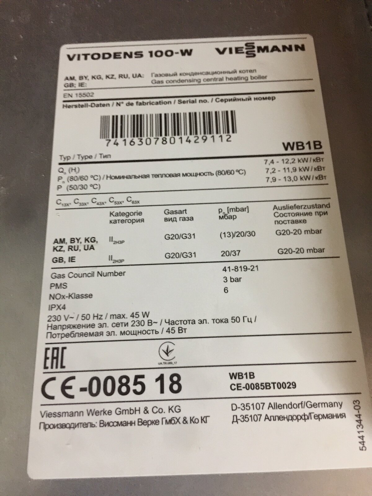

what model of 100-w is it - can you give us the GC number? I wasn't sure about the OT - (edit) Only ever done a few Viesmann's - and I was sure I remember that one of them had their own Protocol, like WB's EMS, though I do have it on good authority (@DP) that it should be OT enabled

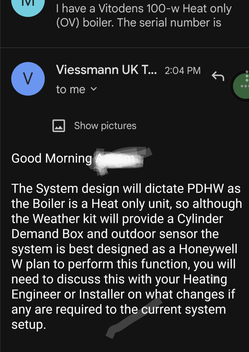

The instruction sheet I have sent in previous note says that DHW can run with weather compensation + cylinder demand terminal box of viessmann. I just want to make sure that it does what it says before I buy terminal demand box.
Message from viessmann tech support

W plan is an old system design and I wouldn't suggest that would be the best way, a W plan would use a diverter valve rather than a MID 3 port, you can alter with wiring to essentially turn the MID into a diverter but it's not what's it's designed for and not sure how well the valve would last. That being said though a 'W plan' PDHW wouldn't be a bad idea but I wouldn't use your MID pos valve.
Easier configuring the system as an X plan, which is very similar to an S plan but needs a NO CH 2 port and it won't use the switching wires of the valve to control the boiler (though the orange Switched live from the DHW 2 port is used to power the CH NO 2port.
I don't think you need to go to all the trouble of getting the control unit etc but if that's part of the weather comp and you really want that then it may be moot. The DWH doesn't 'run' with the weather compensation per sé, weather comp alters the flow temps for the CH, determined by the outside temp, it may be just that the weather comp system comes with the control box too.
GC Number 41-819-21

As it says in the Viessmann data, if you have a Y-plan (mid-position) valve, the mid-position is not used with weather compensation, so it must be wired to operate as W-plan (either/or). Without studying the valve in detail (and perhaps not even then) I don't see how to do that, but maybe somebody on here or your electrician if you have one, can help.
Is it a Honeywell valve? Another option is to replace the valve head with a W-plan V4044 head.
Changing to S or X-plan would be a lot of work, both to the pipework and the electrics.
I don't find the Viessmann data sheet too clear, as it doesn't show the room-stat. The table showing wiring of the diverter valve looks OK for W-plan - valve powered when the cylinder-stat is satisfied (assuming the live to 4 on the terminal strip is from a roomstat). For your Y-plan valve, it seems to be saying common the grey and white wires and connect to 3 on the strip.
Don't know what you asked Viessmann tech but their reply isn't much help.
