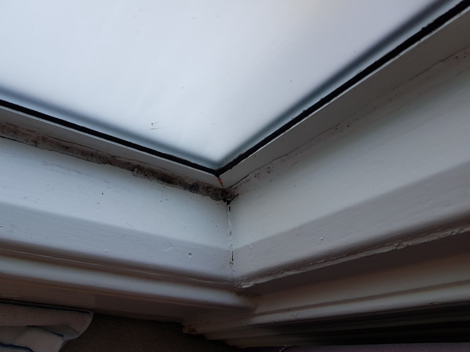

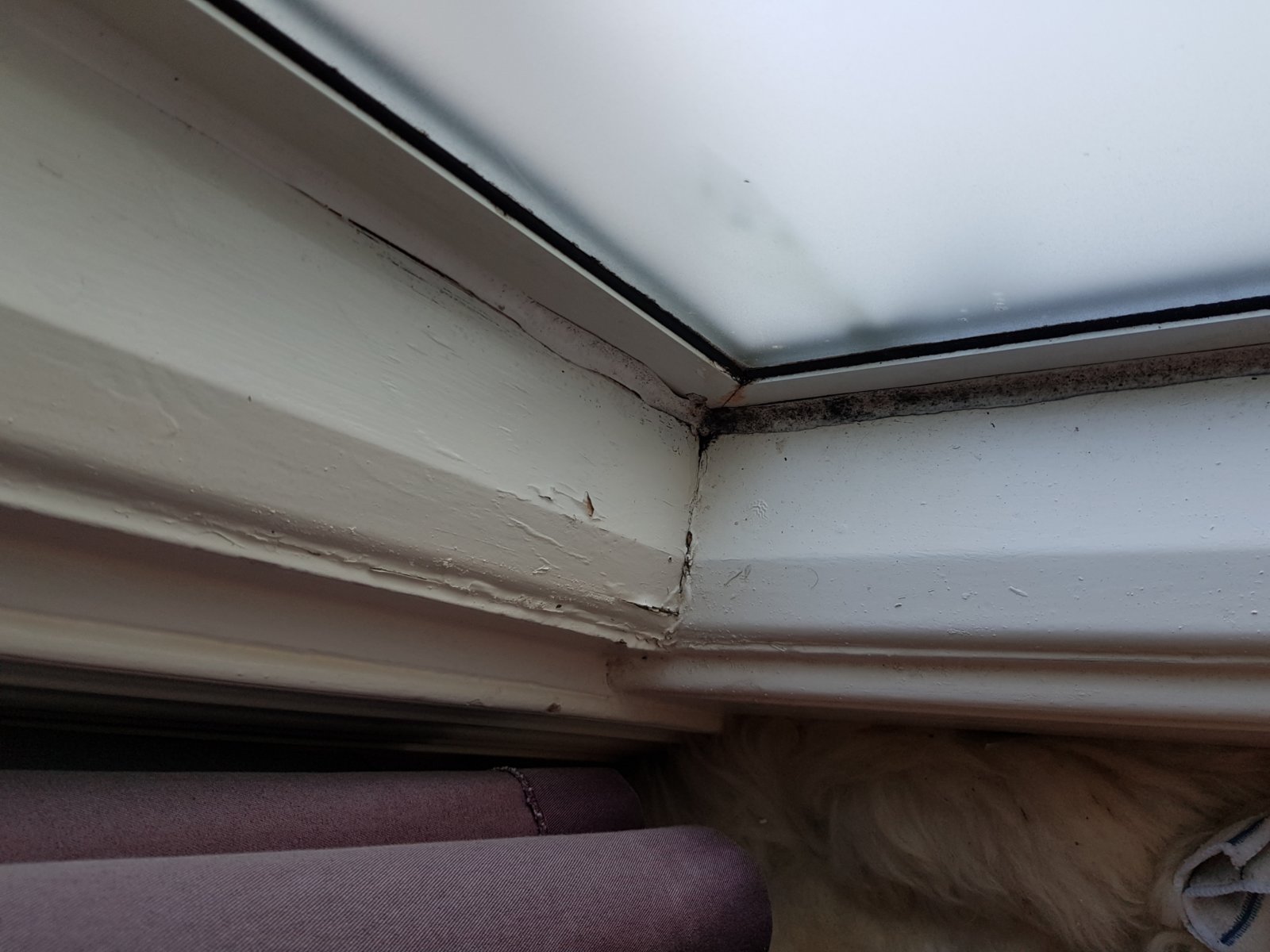

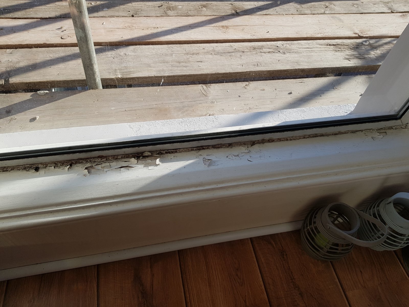

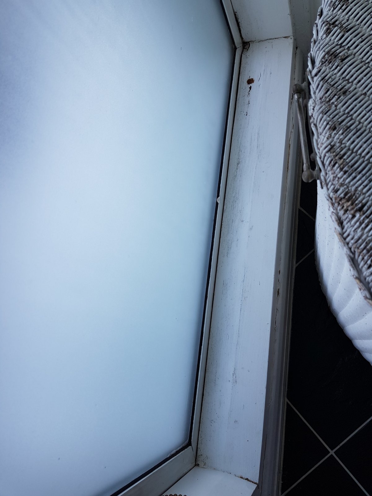

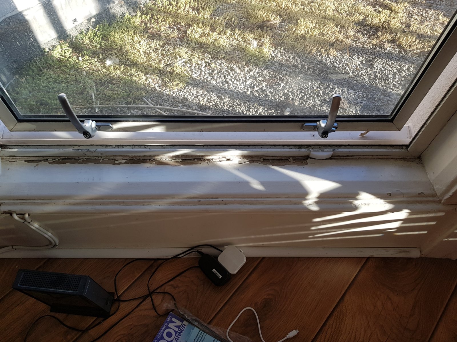

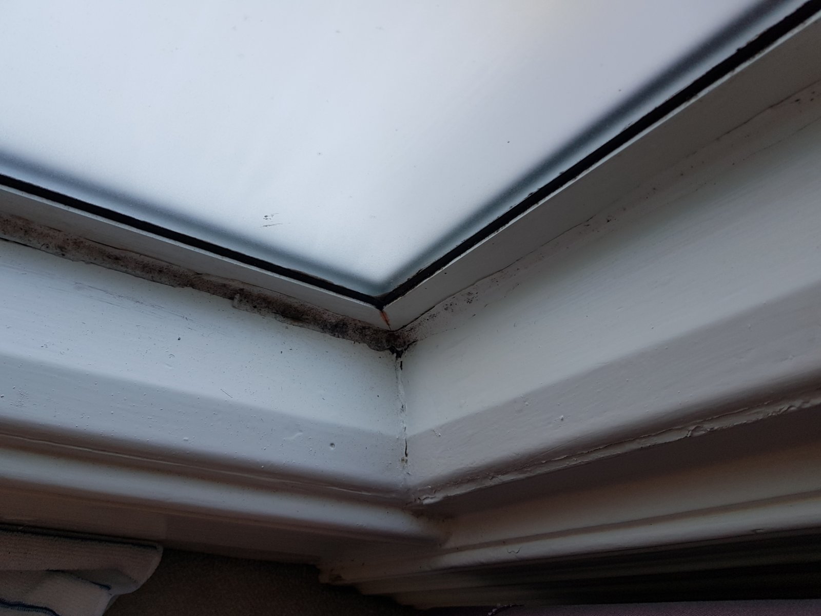

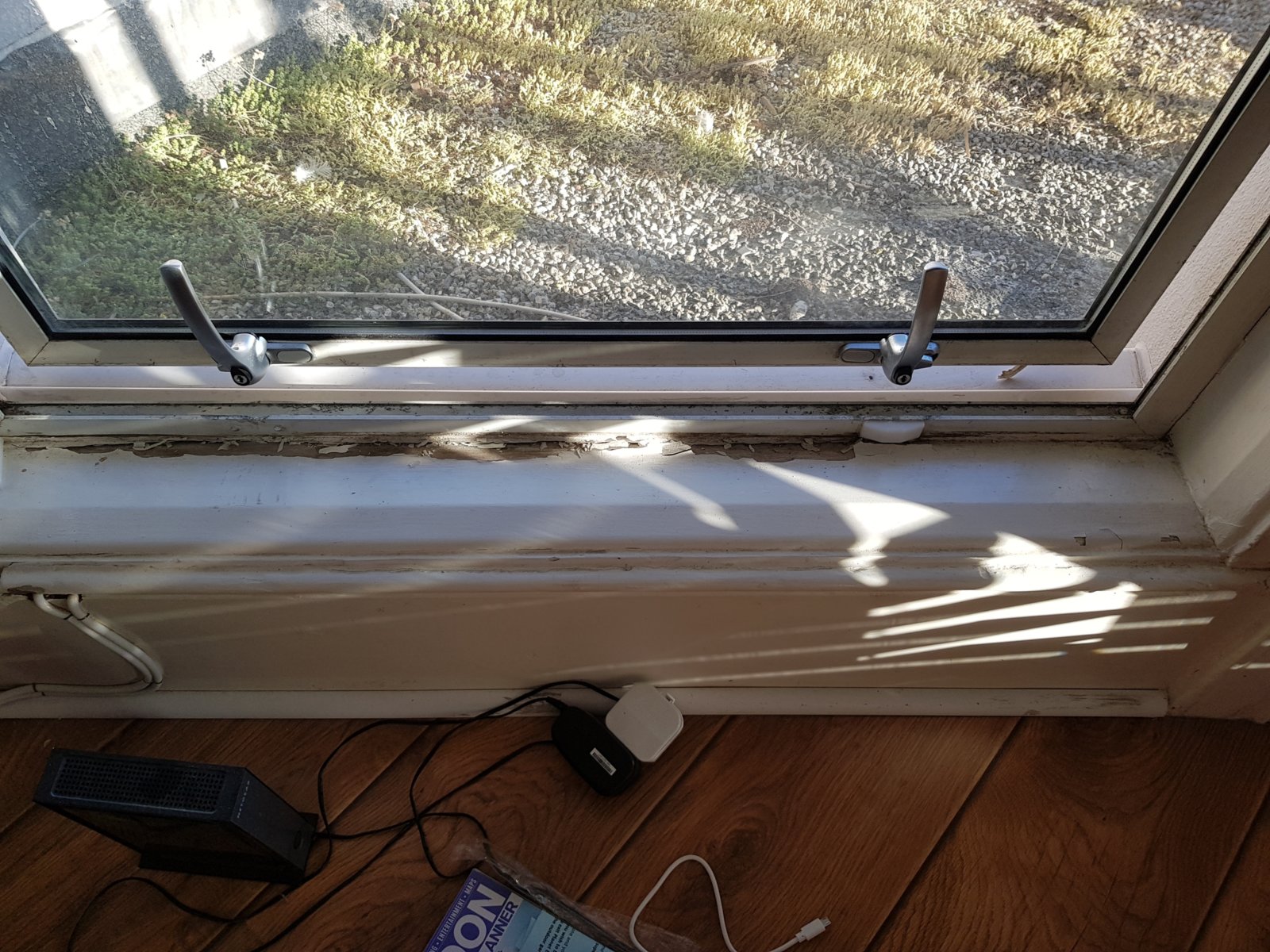

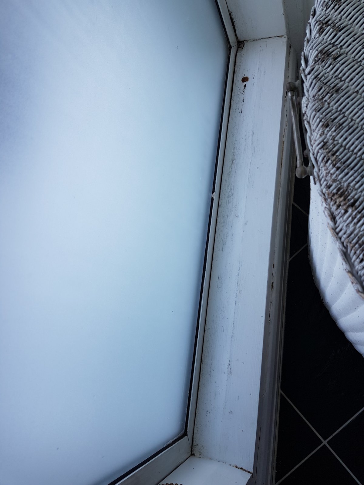

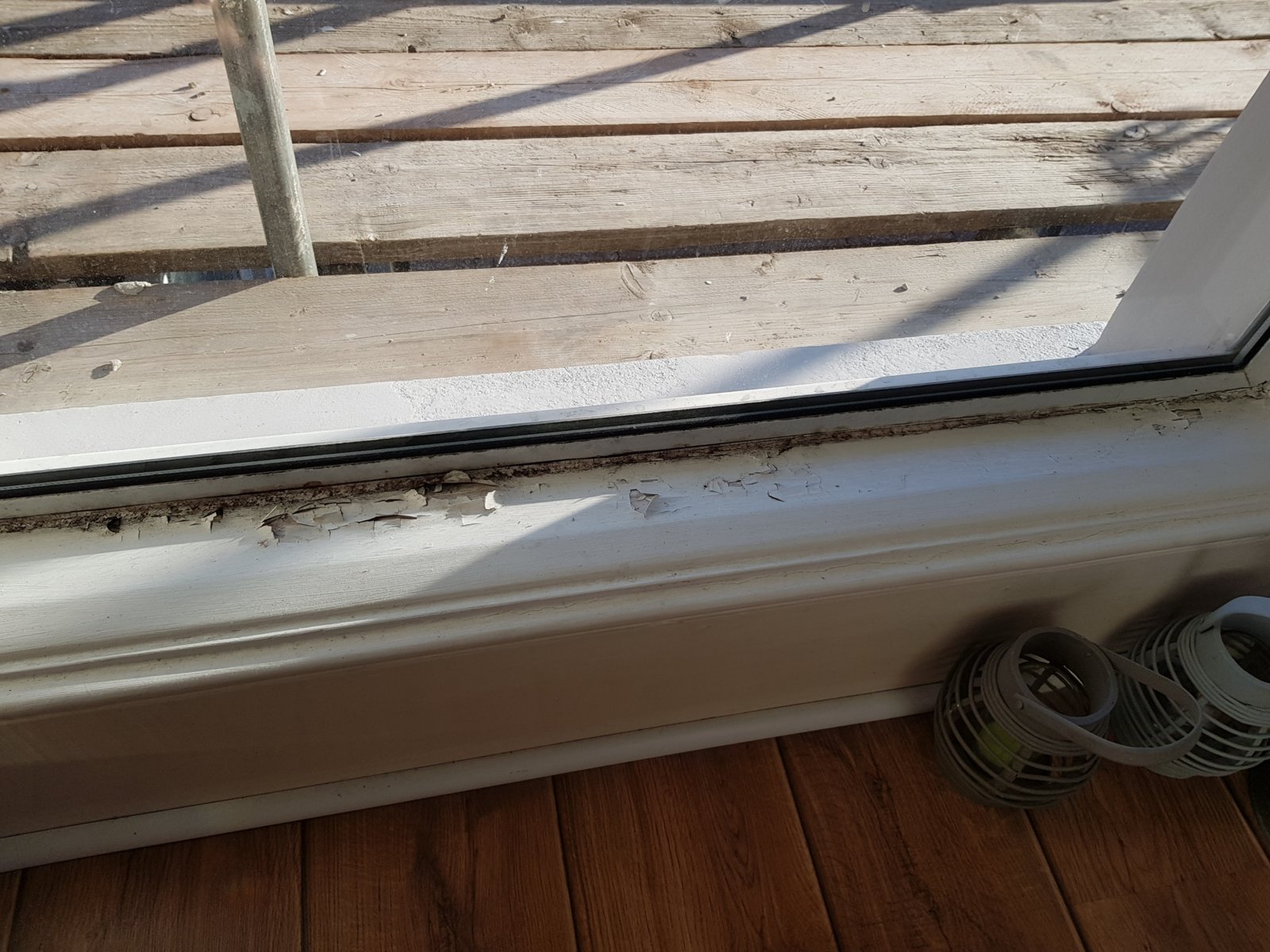

Greetings,
A newbie to DIY and painting. Flat have lovely windows but the wood need some love on the indoor cills / sills to be maintain as per pictures.
Condensation have done some damage and do not want to replace the windows yet.
What would be your recommendation? ( I could get someone to do it, but me think I could save money doing it myself)
Steps by steps and product
Many thanks

Scrape, sand, primer, filler, undercoat, gloss.
The preparation is the important bit. Get yourself a scraper and a coarse sanding block and set to.
(Is the wood actually rotten?)
Thanks so much for your feedback
Filler, is that for the damaged / rotted wood? Am I correct? In one window, yes the wood is damage / rotted slightly but can be repair as very light surface.
When you say Primer, undercoat, gloss – is that 3 type of different paints?
When you say scrapping, is that scrapping all the old pain to bare wood or just the flaky bit?
Any link for a good scrapper ? would any from B & Q / Homebase be sufficient?
https://www.diy.com/departments/diall-4-stripping-knife/203488_BQ.prd
https://www.diy.com/departments/hamilton-prestige-4-heavy-duty-stripper/36418_BQ.prd
Paint wise – what type or brand should I use – currently white gloss so I guess the same. Been told to be mindful of what you can find in Homebase or B & Q.
Thanks,
You can get Primer and Undercoat in one can, and I happily use it as a DIYer.
Downside is it seems to be a bit more expensive than buying seperseely, and also needs a few coats. Upside is less tins and very easy to apply.
Found it was cheaper at Screwfix and Toolstation than homebase. But I do like the homebase version.
SFK
A 2in1 waterbased primer/undercoat will be fine but use oil based gloss or eggshell for the finish coats.
Scrape loose paint away, and any damaged (soft or blackened) wood.
If filler is necessary use a 'Two Pack' filler now. (2 pack is more durable in wet areas and will cure to full depth of filler, 1 pack needs multiple layers.)
Sand level those areas; 'Key' all other painted areas - use 80 grit abrasive. clean all dust up.
Prime with Aluminum primer (Wickes), smooth but do not brush out to thinly.
leave overnight. Apply 2 coats of undercoat - for where you are painting oil based is best.
Once dry, Key (and de-nib - smooth out little lumps) with fine abrasive (120/160/180).
2 coats of gloss - keying between coats.
