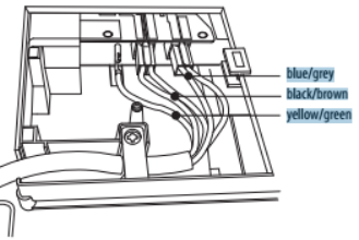

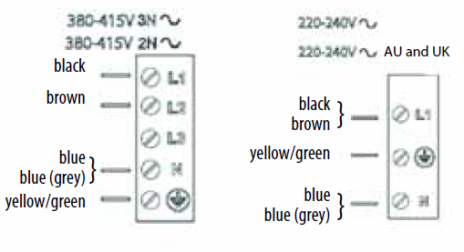

I don't know if this is for cable flexibility or to allow more connections in europe.
In some countries in mainland Europe it is not uncommon to have 2 or 3 phase supplies available for domestic users. The elements in ovens are 230 volt with some elements on one phase and Neutral and other elements on the other phase and Neutral.
I think it more likely that when more than 16A is required, it would just be connected to two (or three) circuits.
For some reason Whirlpool fit a 5 core cable for UK appliances when a 3 core ( of larger cross section ) would suffice.
No, it's normally shared over two phases. Where single phase is only available, the two conductors are linked. The two sides of the hob are usually electrically separated up to the connection point.

Our Technical team have advised, the cable is 5 x 1.5mm with Live and Neutral joined making 3mm for L & N
The fuse protects the cable ''in the wall''
