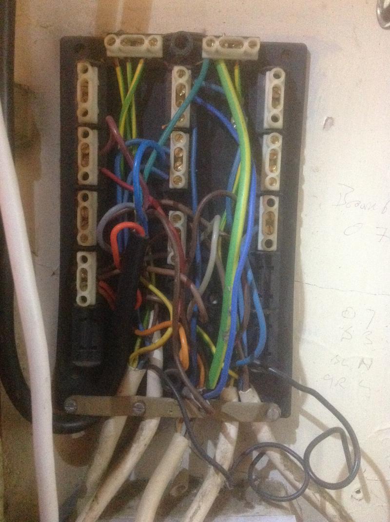

I have a Potterton Promax 24/2 HE Plus boiler GC No 41-601-17.
A hot water Cylinder + Emersion heater and Cylinder thermostat
Pump – Multi Head G Pt No 59506180
Valve 1 - Sunvic SZ2301
Valve 2 – Drayton Zone Valve Actuator ZA5
Honeywell ST699 Programmer
A connector board (Picture) = a box with connector blocks which all components are wired into!
2 water reservoirs in the roof
I have recently moved into this house and I am not sure what type of system I have. It seems to be a bit of everything. Not what I am used to! I seem to have 2 systems in one as far as the heating is concerned. When the hot water is on it warms radiators in the Kitchen, Hall Bathroom towel rail and downstairs toilet. All other radiators are controlled by the central heating control.
The hot water cylinder sends water temp info to the boiler when low and the boiler heats the water in the cylinder.
Here’s the thing! I wish to add a Honeywell T6360B room thermostat into my system because currently my heating is controlled by a combination of the timer/Controller and the radiator TRV's. Not very efficiently I can tell you! (just had 1st Gas bill!!)
Please could you tell me where to wire the thermostat? To the controller or the connector board? What cable to use 2, 3 or 4 core? And finally which wire goes where?
Thank you in advance

Can you identify the cable from the ST699 at the connector board?
That's possible, but the DT90E or DT92E (wireless) would be a better choice.

I have traced and labelled all wiring to this connector board and looking at the photo from left to right identified cables are as follows:
1. Valve - Drayton Zone Valve Actuator
2. Honeywell 699 Programmer
3. Pump - Multihead G
4. Valve - Sunvic SZ2301
5. Cylinder Thermostat
6. Mains Power Supply
Thanks again
Bison108
Presumably you know which valve controls the heating. ;)
Locate the brown wire from this valve in the junction box. It will connect to a wire from the ST699 programmer. The thermostat is wired as follows:
Move the brown wire to a spare terminal
T6360B
Connect T1 to where the brown was connected.
Connect T3 to where the brown is now connected.
Connect T2 to a neutral terminal. Make sure it is a neutral - blue wire is not always a reliable guide
If you install the DT90E the wiring is similar. Just substitute terminal A for T1 and Terminal B for T3. There is no neutral connection for this type of thermostat.

Hi D,
I have carried out the advice you have given and most importantly I have not blown anything up which is comforting.
The boiler seems to switch on and off via the thermostat so that's good.

Slight hiccup! No heating now. Having disconnected the Brown wire it appears that the valve does not work to let the water into the central heating system.
There is however another live which is an Orange wire to the programmer! Should I try your instructions out using this orange wire in place of the brown wire?
Are you able to tell me which of the terminals in the programmer the correct wire is attached to because I can trace the correct wire from there?
Thanks in advance, again!
If it was working correctly, why have you disconnected the brown (presumably to the valve)?
Is this orange from the valve? Which terminal does it connect to in the programmer?
Hi D,
Please accept my apologies. I misinterpreted your instructions initially and it was late last night so I put the wiring back to its original position!
Had another go this morning and took into account you latest post. It made a lot more sense. Sorry I am a bit dull but I think I have got there now.
