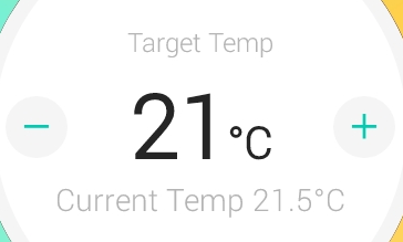

I found in my late mother's house, radiators with the TRV on the return needed the lock shield valve turning down more than when on the feed, as to why, is up for debate, it may have been due to the TRV heads fitted? It was claimed the heads have two sensors, one senses the water temperature the other the air temperature, the latter is the main control, the water temperature sensors will correct the air temperature one to allow for the heat direct from the radiators, I used the temperatures reported by the valve head, to set the lock shield valve. TRV_report.jpgThe current should not exceed the target, if it does, then the lock shield is too far open.

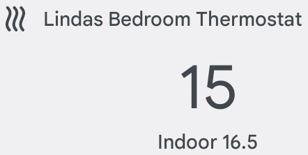

But when I started to use different makes of head, there was no reference to having two sensors, some only show target 1761823695414.png they were cheap at only £15 each in 2019, but most do seem to show both 1761824080662.png as you can see current has exceeded the target 1761824234852.png but because the set point has changed in the latter, no point heating a bedroom during the day. And if you set the lock shield too fine, it can slow how fast the rooms heats up. The 21°C is behind a settee which means it does get locally over temperature.
