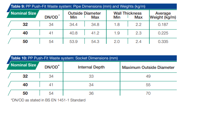

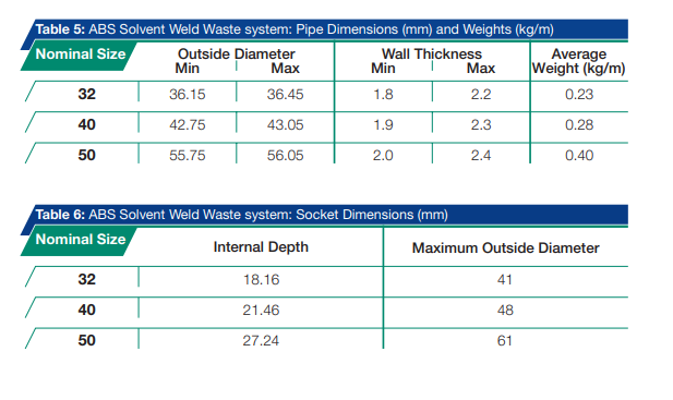

As the title says, What is the internal bore of a 40mm waste pipe?
I'm looking to insert a 34mm outside diameter extraction hose into a piece of wastepipe. I have a short length of 42mm O.D. pipe but the internal is too large.
Any suggestions on what size I need to get a 34mm I.D.?
My project is trying to make a manifold for my dust extractor. The end of the vacuum pipe is flexible rubber with a diameter of 34mm. This fits snugly into the 35mm outlets on my machines. My idea was to have a length of pipe with a number of T joints along the length. From each T joint would come a separate hose going to the individual machines. When I am using a machine the hoses to the others would be plugged so I get full vac pressure on the one I am using. I have some other flexible pipe which will fit the outlets on the machines, it's just connecting to the manifold with the main pipe from the extractor I'm struggling with.

Here are Osma waste dimensions,
ABS,
PP, Pushfit
