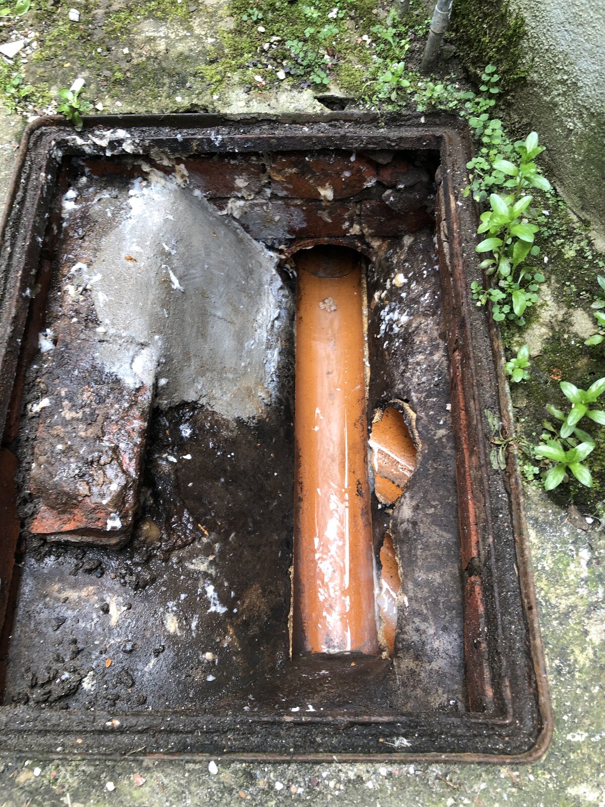

A stiff mix of Grano, build it up in thin layers. Keep channel wall vertical up to the crown of the pipe, then slope it back to the walls. Photo of said Manhole will help us advise better.
Thanks. I'd build the benching up on the opposite side, in thin layers if need be, to make a vertical 'wall' opposite the slipper, to at least level with the crown of the outgoing pipe, ideally to level with the crown of the slipper. Solids should then hit the opposite wall and fall into the channel, with following discharges washing any residue away.
You're lucky its a shallow chamber, nice and easy to work in.
