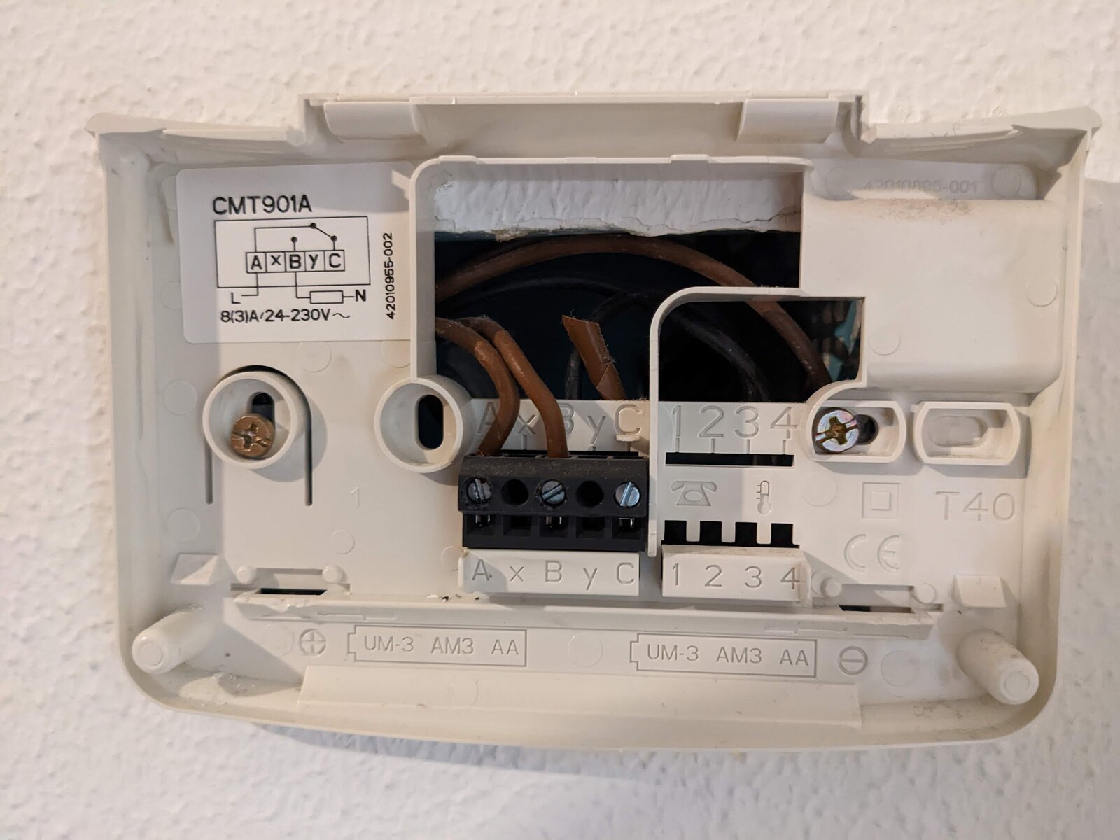

Good morning everyone,
I bought the Nest Thermostat E and I'm trying to install it instead of my Honeywywell (see photo).
I have a doubt about how to place the cables because I can't find an online reference on the AxByC cable nomenclature.
Can anyone help me?
Thanks in advance
its on the back plate...the live is on a the neutral is on b and the switched feed for the boiler on off is on c
Sorry, that's incorrect :)
The diagram is slightly confusing.
A is Live
B is Normally open
C is normally closed
The rectangle in the diagram represents the boiler, with neutral connected to the boiler (...and the switched live coming from 'B' on the thermostat)
So for Nest thermostat E, you only have to connect A to 'C' (Common) and B to 'NO' (Normally Open) on the heatlink.
