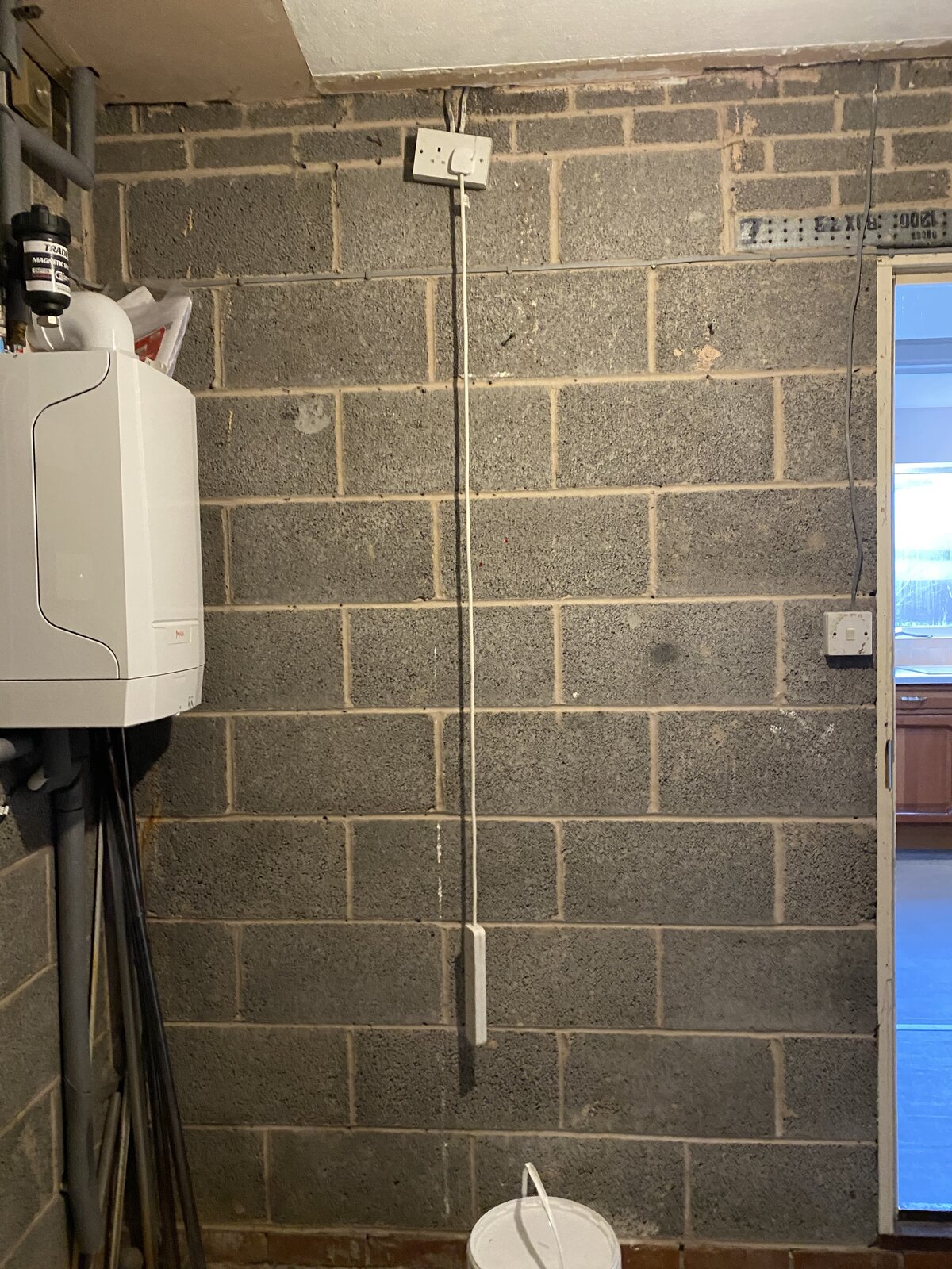

Morning All,
Understanding that BCO's can vary wildly between local authorities, can anyone give some pointers on what they're likely to want to see at the design stage please.
I've reached out to my Local Authority BCO to ascertain what they would want to see but would like to prepare myself.
The works I'm hoping to undertake are:-
Replacement of Consumer Unit - 1990s vintage to Hager RCBO Board
Separation of single lower floor final ring circuit > Kitchen Final Ring Circuit/Rest of Lower Floor Final Ring Circuit
Expansion of first floor final ring circuit + 4 total (1 per room) accessories (double socket)
Conversion of 1st floor accessories (single socket to double socket)
Addition of Radial Circuit to Garage (single double socket)
Addition of Lighting Circuit to Garage (it's currently pulled off the downstairs lighting)
Addition of Radial Circuit to Office (Office doesn't exist currently, will be utilising half of Garage)
Addition of Lighting Circuit to Office - As Above.
There are some other remedial works that need correcting, like sockets dangling from ceilings which need removing and making good but I was going to run through the EICR process before starting anyway so everything is identified properly and I know what I'm starting from - See Below - Great Job......
Any and all advice would be greatly welcomed.
I’m not just coming at this with a plucky attitude and a calibrated MFT 1720……honest.
Cheers
Lee
