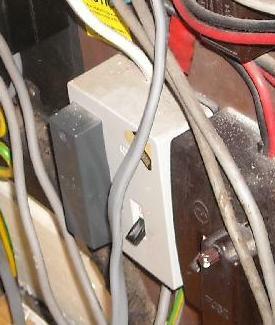

This is the 30A switch it's currenty on.
I've not got involved with the Agency that completed the work, and I'm currently speaking to the Technical Officer that was responsible for signing off this work.

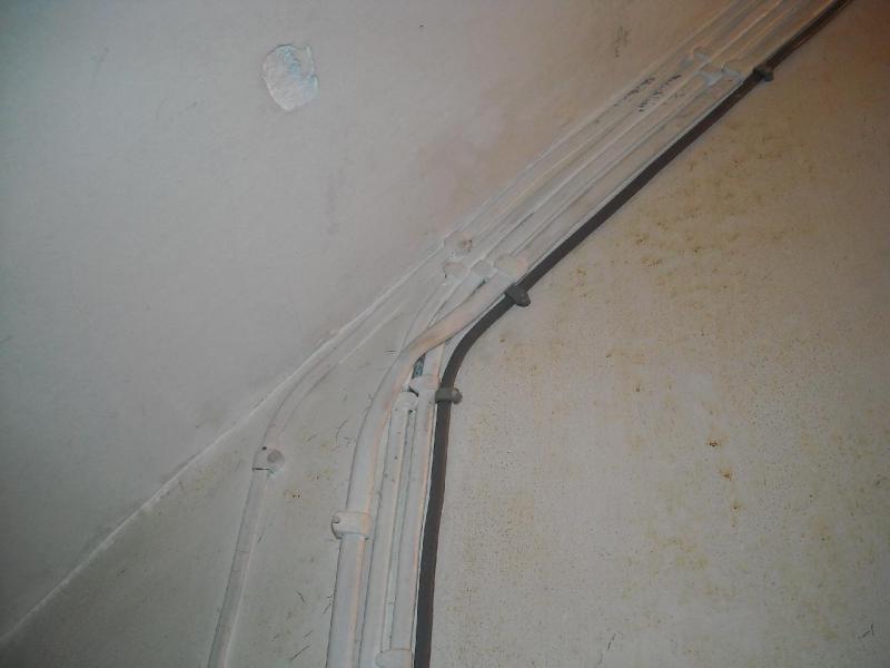

He told me, new wiring and RCBO had been fitted for the new shower, by the electrician, it's taken me four weeks, to convince the Technical Officer, that this is not true, evidenced by photos of the installation (see above), and I suspect the the Electrician didn't even visit under the stairs, and just hung the shower on existing cable in bathroom. After chasing the Certificate for Electrical Work, the certificate does not state this at all, it states, "extending the existing shower circuit to a new lower position" - I've yet to find out how this was done!
I've also measured with ruler the current cable, it measures about 10mm, so I beleive this is 2.5mm2 cable.

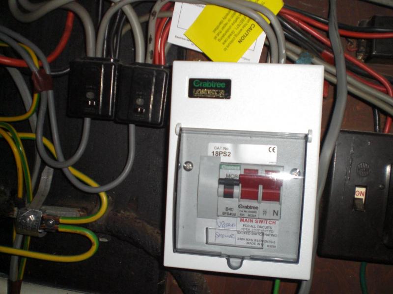

So this was what got installed, despite the Technical Officer telling me, an RCBO was going to be installed:-
We've now got a 40A MCB on old wiring!
I know this is difficult to get a size but this is the wiring...
I would appreciate comments from an electrician.
