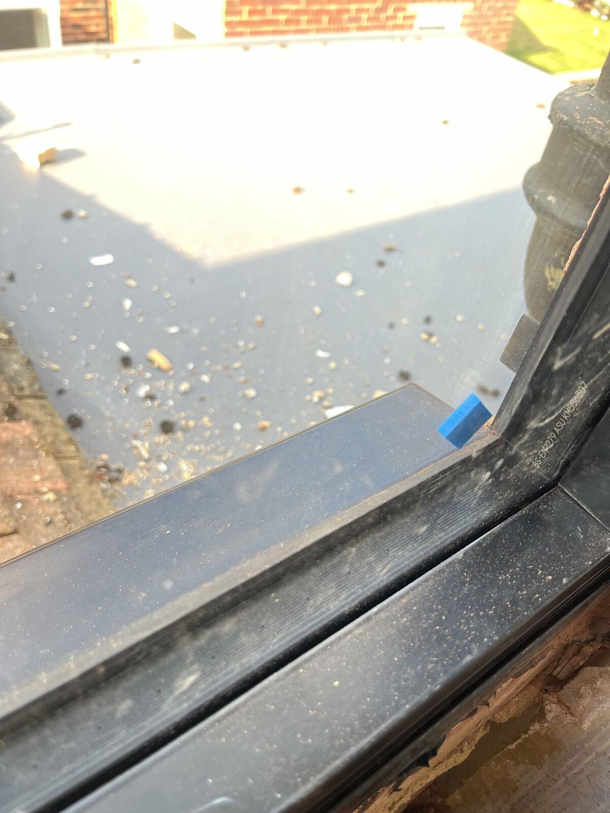

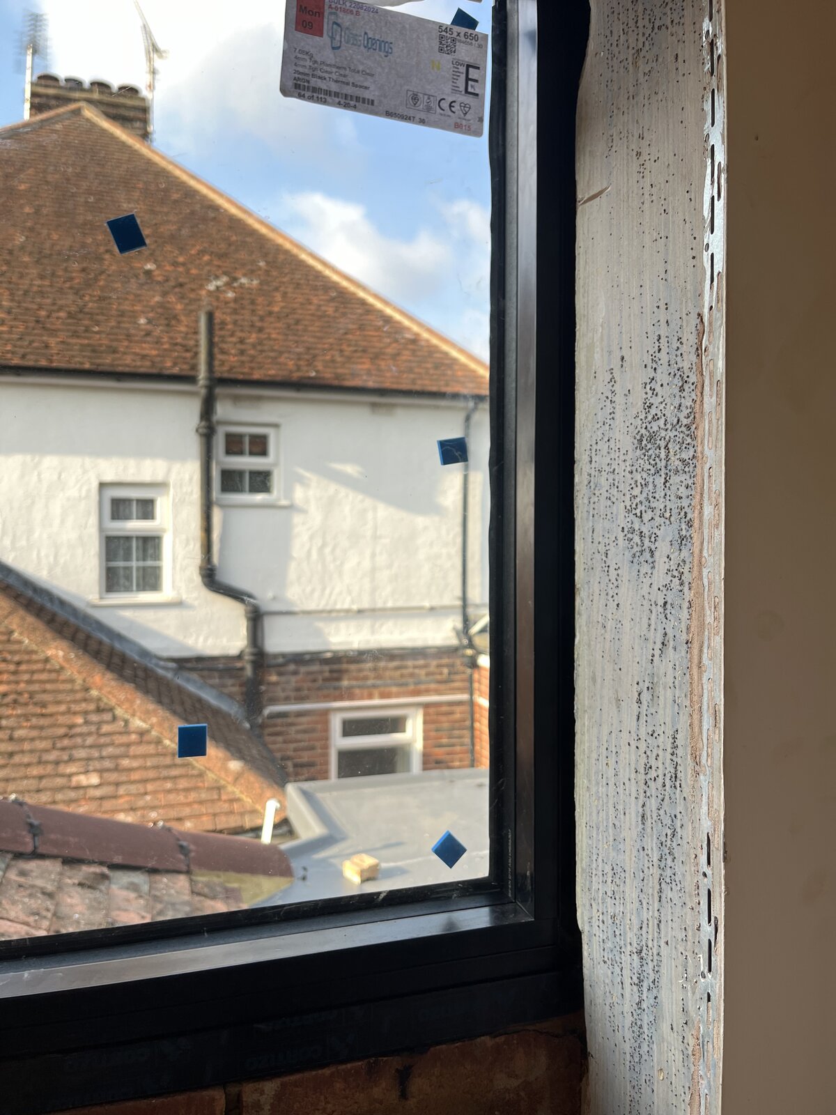

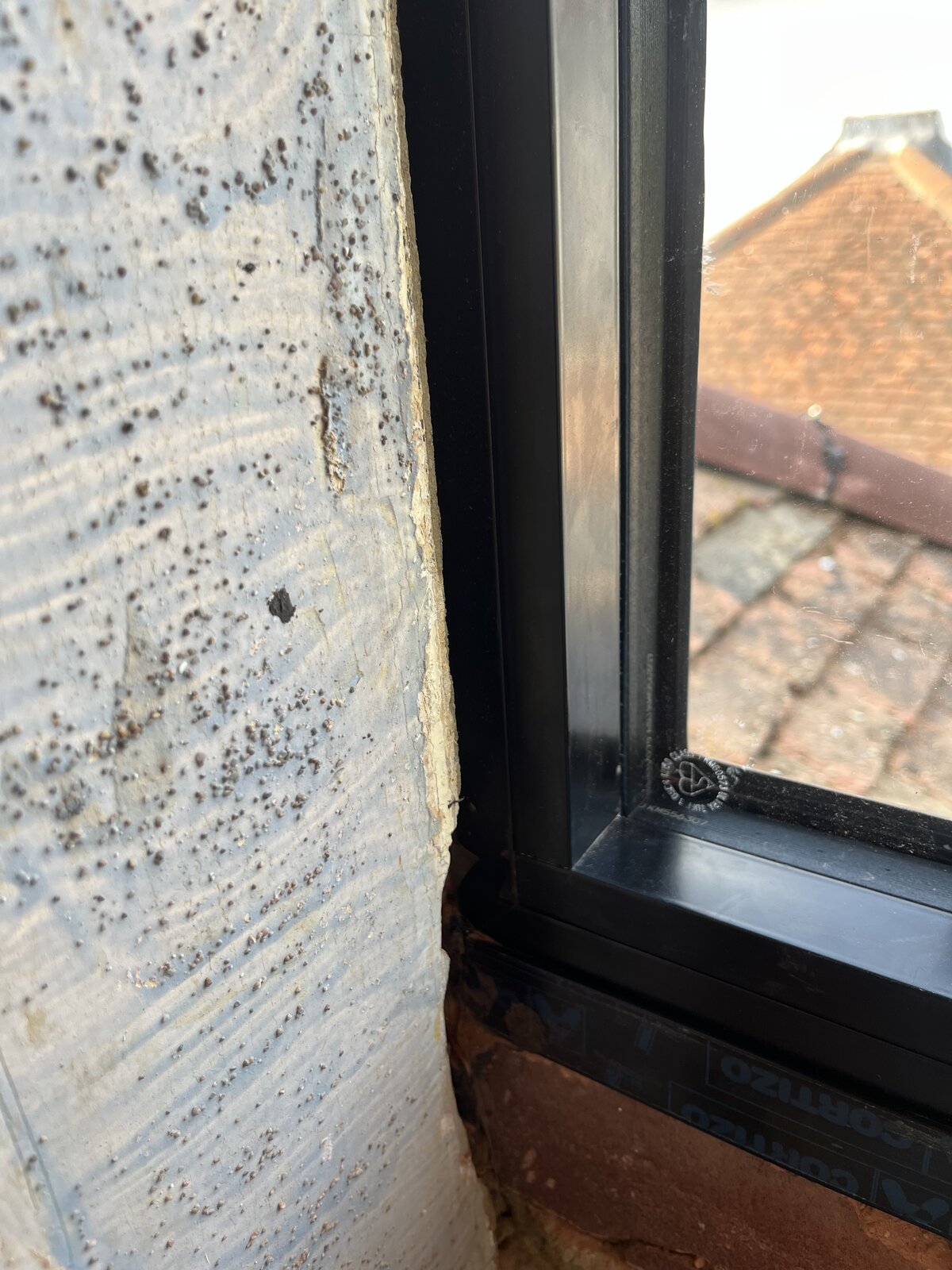

Hello,
I believe I have installed my aluminium window the wrong way round. I believe I have what was suppose to be the outside face on the inside.
Is this going to be a problem with damp / rain?
It’s a non opening window
it would be normal for the rebate of a window frame to be on the outside, as you have
what makes you think youve installed it the wrong way around?
Im not used to ali systems, but if its the wrong way around my guess is that the drainage for the frame rebates might be wrong -it depends how the cill works I imagine
Aluminium frames can be externally or internally beaded, depending on what you ordered. As Notch says, depends where your drainage is
