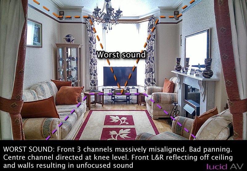

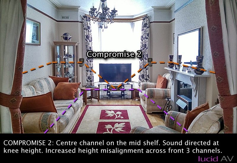

The further your front three speakers are from the TV then the more disjointed the sound from the picture. This isn't being a picky "audiophile"; it's just common sense. Putting the front three speakers closer to a level line will improve the panning effects as sound moves across them. Flank the TV wioth the front speakers if you can.
Surround speakers aren't really supposed to go on the rear wall but the side walls, about inline with the seating position and at roughly 1ft (30cm) above seated ear height.
The problem with putting any speaker up high and in a corner is that there's a lot of early reflections from adjacent walls. This creates the effect of three or four sound sources all sightly out of time with each other. It's less precise, more like the effect of adding a touch of echo. It's nowhere near as pronounced as the effect of shouting in a tunnel, but it does create a reverberation which means that the speakers can't do their job as well as they should.
BTW, anybody who takes the time to consider sound and the effects of eqiuipment positioning on sound quality is, by definition, an audiophile.
Here's some images of the effect of speaker placement on front channel panning. They're followed by a couple of rooms I've done where clients were kind enough to allow me to use the photography.
