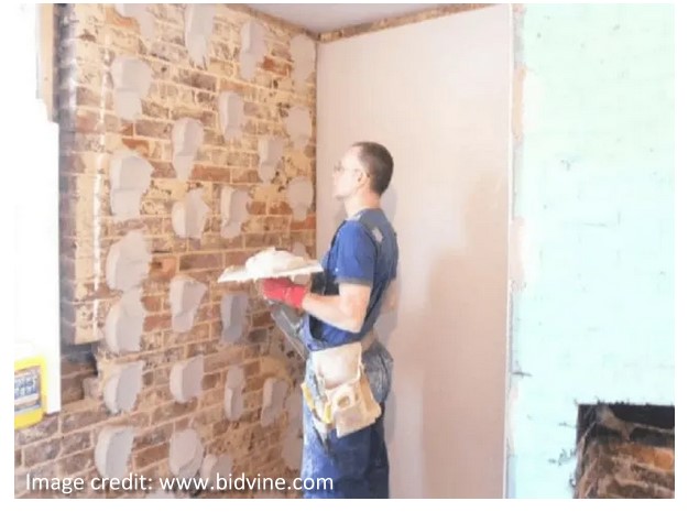

Honestly, you're not going to make it round the corners of a room that has a dot-n-dab (drylining) wall finish.
Have a look at the image below. Here's a chap applying the adhesive to the wall before pressing the board in place. Have a look at the internal wall corner. The board is hard up against the adjacent wall. There's no gap to get round.
Second, have a think about what's going to happen to those splodges of adhesive once the board gets pushed and jiggled into place.
They're going to spread. When they do, some will spread far enough that they join up with the splodges nearest, and then you'll end up with a solid wall of adhesive at some or other part of the board gap. You won't get a wire past that unless you either detour a lot or cut the board where the blockage is and create a channel.
I have a special kit for pulling wires behind plasterboard walls. In essence, it's a big magnet in a roller, and that attracts a metal slug to which the wire is attached. Sometimes I'm lucky and can get wires up a wall. Other times the gap between the board and wall is too small, or there are adhesive dams, or there's something else in the way. Inevitably then I end up cutting in to a wall at some point during a job. That's just how it is.
Lift parts of the floor above. Run the cable in the board space if it will go. Cut for any blockages, then make good after.
Make sure you use good speaker cable. It doesn't have to be fancy, just decent thickness and all copper. Don't waste your money on the stuff that's made from aluminium and then coloured with a copper coating. It's a false economy.
