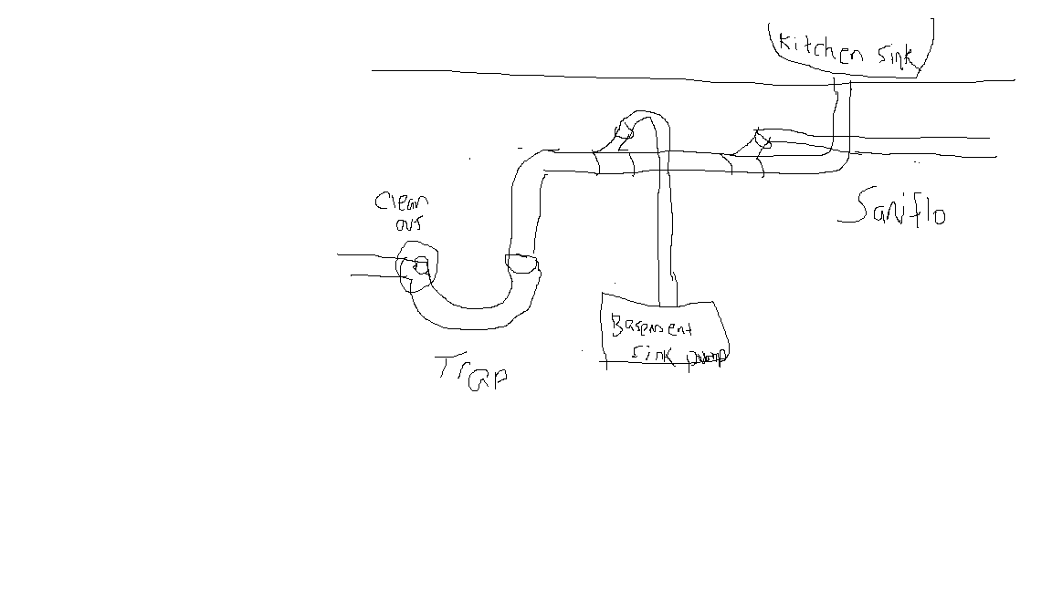

Hi Hoping for some advice about installing a saniflo toilet. I live in a cape home and the sewer drain is 3 feet off the ground. I have a kitchen sink and a laundry sink pump connected to the main sewer line. it is connected right behind the clean out. I was thinking about adding into that drain pipe run a saniflo pump discharge line. Is that too many things connected to the sink drain which was the primary thing.
after the trap is the clean out and i dont want to block that. after that it goes out of my house into the street
Seeing that the waste has been through the muncher it wont cause a blockage and any clean water will only help to "Flush" through the pipe.
If there is a blockage in the U bend then minched sheite will likely backup into the sinks - ewww.
Will that be to US code?
Maybe asking a US plumber would be best as the response you get ought to match your local codes better.
