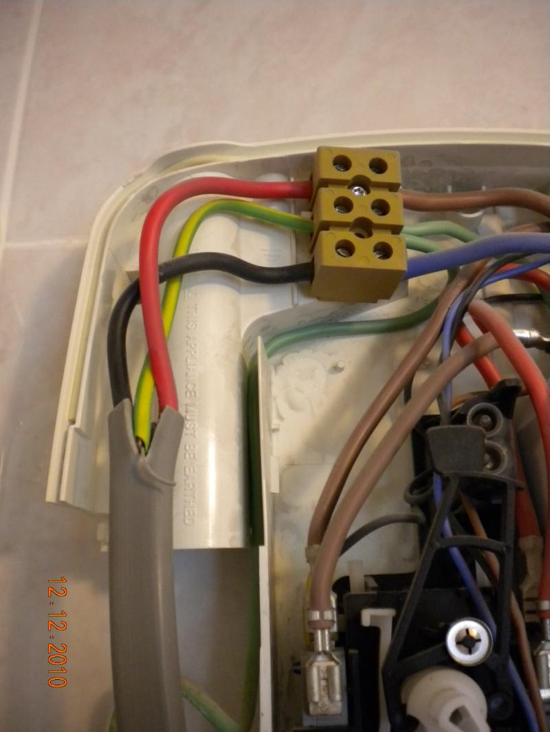

Now, how have you measured the size of the conductors in the cable feeding the shower?? I will bet they are 6mm² so 40A will the largest cb you can have on that sized cable.
Haven't measured the size of the conductors feeding the shower; please advise TTC. Thanks for your patients TTC.
that doesnt look like 10mm to me could be 6mm or even 4mm! job to know... are there no markings on the outer sheath of the cable?
It will require a new cable 10mm. I will leave it to the experts. Thanx for your help & advise.
