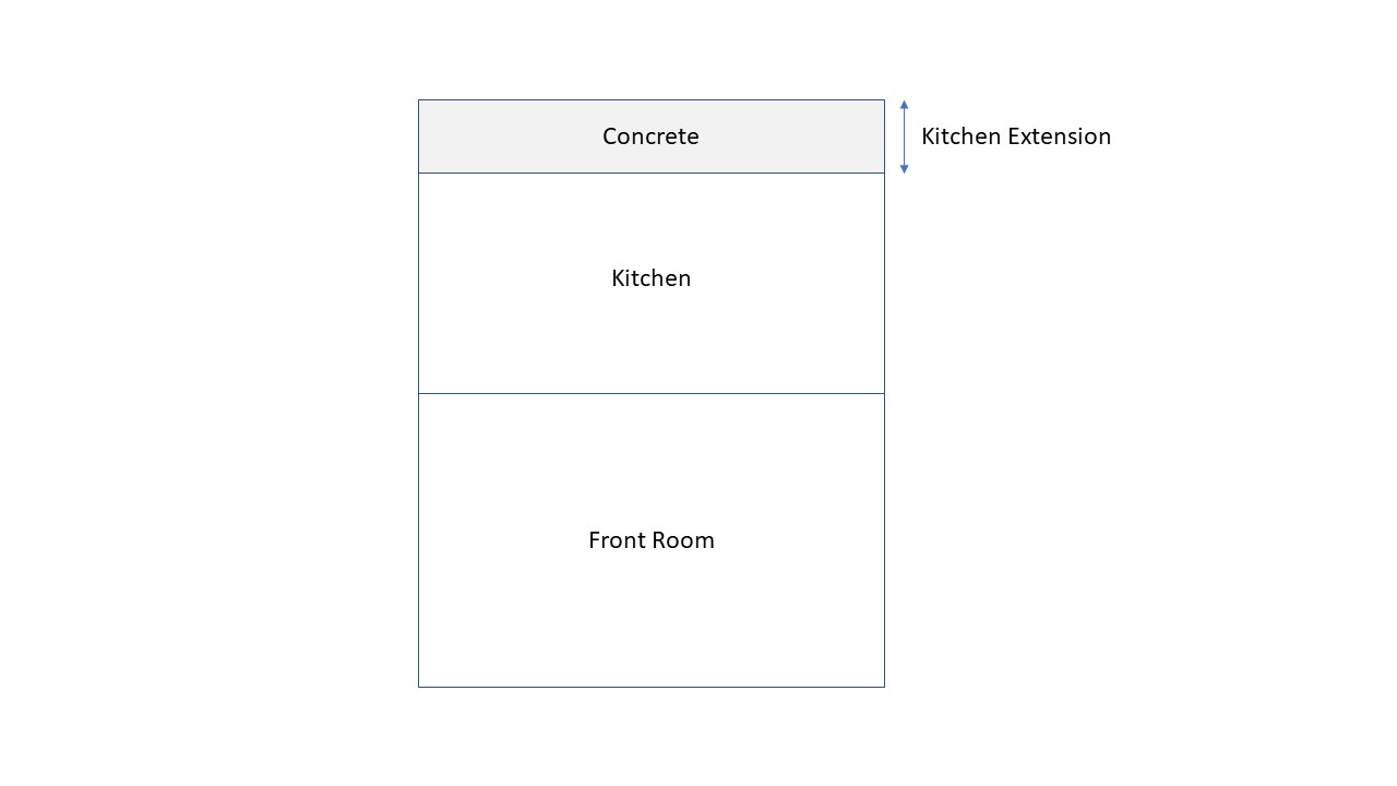

It gets worse I'm afraid. The ground floor is essentially made up of the kitchen and front room. The kitchen has an extension toward the back. The muppets used concrete underneath with the remaining part of the house having timber joists. See the attached quite pic I put together. So any chance of having a front to back air flow is gone. I just cannot understand why it was done like this.

Concrete floors are the standard these days. It's just easier (and cheaper).
You could try dividing the house as seen on the diagram from left to right, then use fans to suck air in from the left front and exhaust on front right, but that seems a bit excessive and quite possibly a terrible idea.

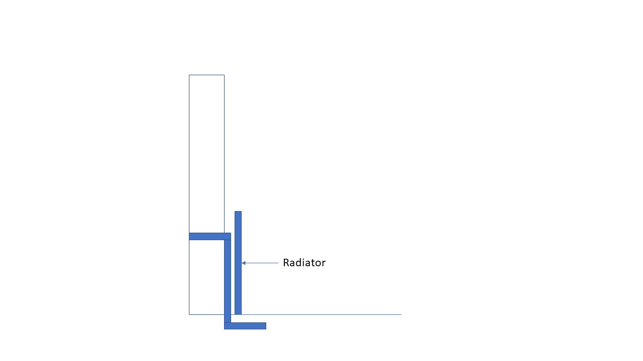

What about the telescope/periscope vent? What are people's thoughts on the feasibility of that?
A bit unconventional I suppose but nothing hugely complicated or risky about diagonal holes. Just a matter of drilling at the right angle and being aware of where the joists are so you come out between them if they run side to side or below if they run front to back and are close to the wall. You could put periscopes in, it's just going to be more of a messy way of achieving the same thing - a diagonal path for airflow and because you don't have a cavity for the vertical section it's going to end up behind your skirting board covered with a dollop of plaster

Another out the box idea, and I qualify this with not being a builder, is an external telescopic vent?
Dig down, add vent and face with brick slips, so they look like mini buttresses?
I am assuming solid wall no cavity, so, like the below, but, the grey telescope bit would be on the outside with brick on either side, and brick faces/slips covering its front?
That way its part od your building, only a brick's width depth, won't involve lowering the path etc.
Potential idea so you dont have tbe telescope on the inside...
Hi Jacko555
This isn't a bad idea. As you say it puts the shaft and 90 degree bit at the top outside of the building and means no messing around with the neighbours path too much. Although there probably will be some minor work to get the bottom 90 degree bit into the building it's nothing compared to the alternative. I'll have a word with him and see what he says.
