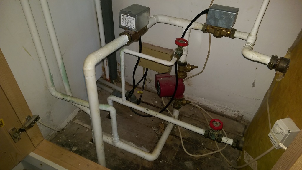

Hi all,
I'm considering replacing our old manual bypass valve with an automatic one.
Is it possible to do this without draining the system?
We've just had a new boiler fitted and inhibitor added so I'd rather not drain it unless I have to.
Please see photo. If I close the zone valves, the pump out valve and the hot water return valve, would this isolate the bypass valve so I can cut out and replace it? Or would there still be some pressure?
Also would it make sense to replace the 15mm bypass pipework with 22mm? We get a fair bit of flow noise on pump overrun so I'm hoping swapping for 22mm with the automatic bypass would solve this?
Thanks in advance,
Rob
There would be as you're not isolating everything - the returns are still connected and "live" (the pipe going below the floor). Why do you think it needs an automatic one?
Thanks - I thought that would be the case and can't see how I could lock off the return side as there's no valve that I can see.
Main reason I'm thinking of replacing it is that during pump overrun it's rather noisy, makes a high pressure hissing sound, presumably as it's having to force the output from the pump through a barely cracked open gate valve and 15mm pipework (wheras the rest is 22mm). I also gather a manual valve isn't very efficient, as it's always giving up some flow to the bypass, even when the CH/HW are on, and as we've just had a new boiler fitted I thought it might be worth updating.
Do you think it's worth doing? Would it get rid of the overrun noise? Or would I get the same result perhaps by cracking open the bypass valve a touch? My concern then is it will be even less efficient. Automatic does seem to make sense.
Is there any way I can isolate it without draining the system. If I close off all the valves mentioned then it's isolated from all angles except that return that goes into the floor as you say, might there be a valve somewhere else in the system that would close that off?

Close all upstairs radiator valves and then drain from the boiler. 90% of the water will stay in (downstairs won't drain at all) and you won't need to re-dose with inhibitor.
Worcester will NOT invalidate warranty for no auto-bypass... A manual bypass is not ideal but not enough to invalidate warranty. No bypass at all might be a different story.

Would it make sense to replace the 15mm bypass pipework with 22mm while I'm there, or not necessary?
15mm should be fine. 22mm would mean unsoldering joints etc and especially annoying to do on painted pipes!
You will struggle to find a 15mm bypass though... most I see up size to 22mm for a short section either side of the valve.
Thanks, happy to get the torch out and put the effort in if necessary! One of the reasons I'm doing this is to eliminate the flow/pressure noise, is there a chance the 22mm to 15mm reduction is causing this or is it more likely just because the gate valve is only opened a crack (so as not to waste too much flow when CH/HW on) whereas an auto bypass will open fully during overrun and hopefully eliminate the pressure/noise?
More likely because the manual bypass is only open a crack.
Replacing with correctly set auto bypass should cure your noises
Excellent, I'll give it a go with upsizing to 22mm either side of the auto bypass, and if that doesn't cure the noise I'll bite the bullet and go back and replace with 22mm, but sounds like it will be fine.
