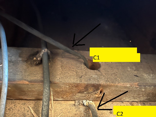

Hi
I want to install downlights in my hallway on ground floor, there is a ceiling light and a light switch as in pic below. To trace cables, I took a floorboard on first floor which is just above the light; pic attached. Am I right to say one of the cables marked C1 and C2 are loop and the other is switch line? Also am I right to say this ceiling light is the last one in this lighting circuit as there is no loop cable coming out to go to another?
From tracing the 2 cables, C2 must be the loop and C1 is the switch line.
If C1 is the switch cable then C2 must be the feed...probably.
If so take those wires to the first downlight and loop in 1mm twin and earth to the next ones.
You might need a junction box above the first downlight.
Yes C2 is the feed, I'm calling it loop,
Defo a JB for first downlight.
Just install one replacement "luminaire" where the existing light is and install any other "luminaires" in parallel with it.

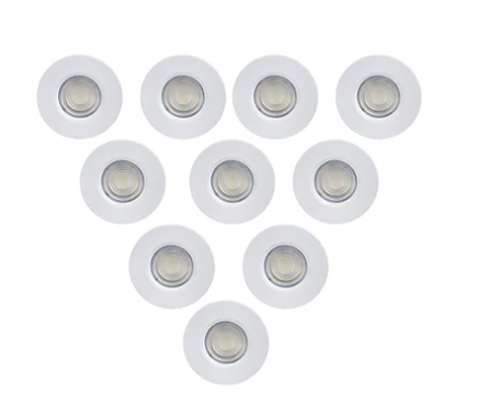

I haven't decided yet of which lights and how many. I am first checking how easy is gone be. So far, looks straight forward; was easy enough to locate joists lift floorboard at the right location using my multi tool oscillator and identify the cables. I will either go for downlights or flush mounts, it will be less work with the latter and also easier to maintain. I have three bulbs atm, each 806 lumens, total app 2400 lumens so want to maintain that sort of lighting or even more; either 5 downlights or 2 flush mounts. My definition of downlights and flush mounts are as pics below:

Doing a bit of research, only one flush mount light will do the job. The LED lights are changing so fast becoming better and affordable; two examples of 4100 and 2700 lumens for less than 30 quid:
The second Luminaire is "brighter" and dimmable.
It is also appears to be colour adjustable - probably at installation.
The first one is "fixed" at 3000 K.
I prefer a less "orange" colour than 3000 K
but
that is a matter of personal preference.
