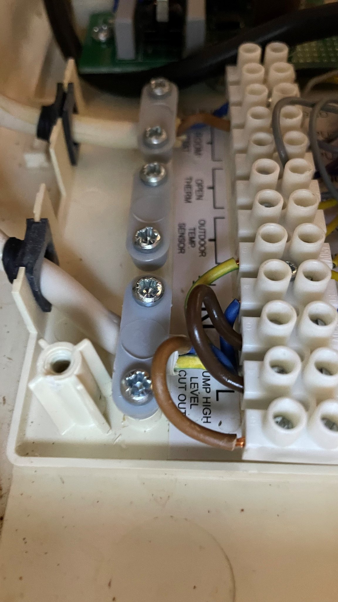

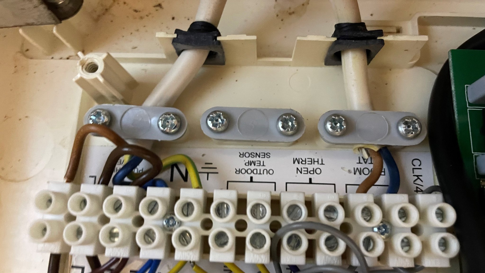

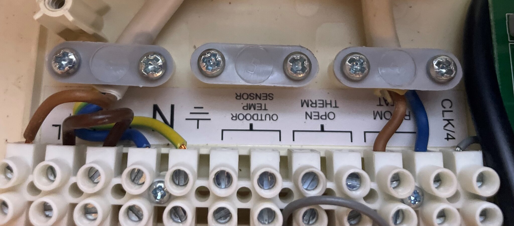

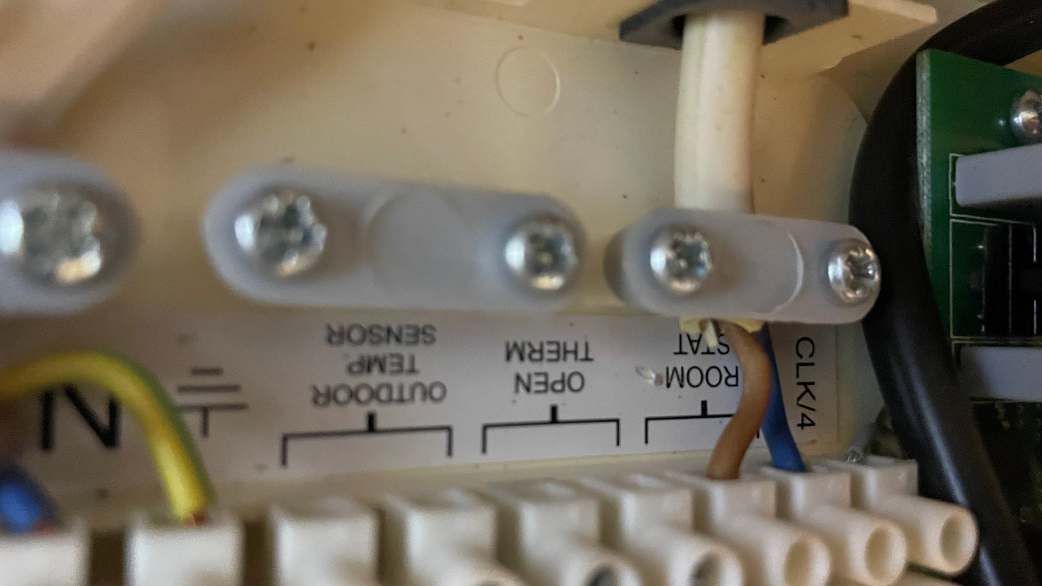

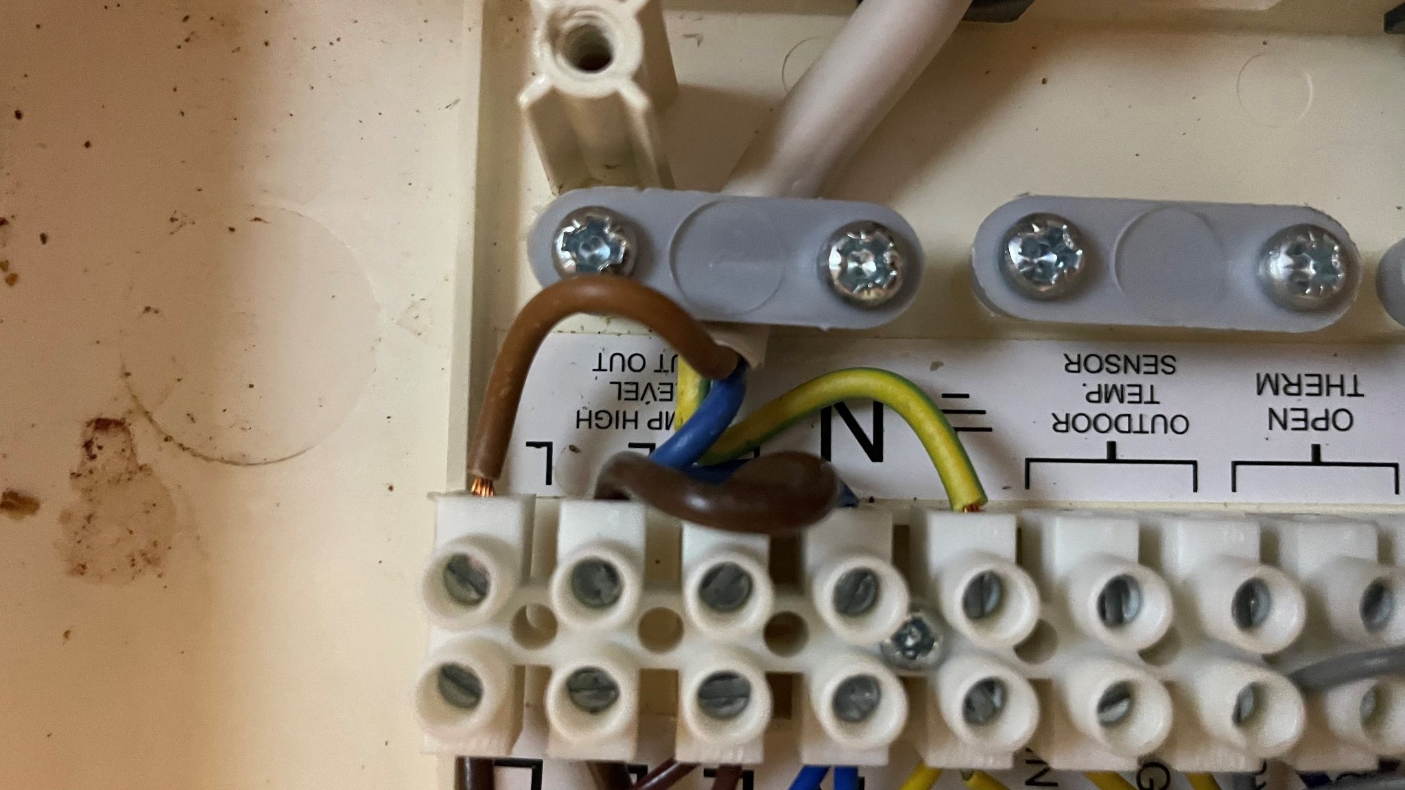

That's the wiring as it is, which is currently wired to a Drayton Digistat SCR. Here's some better photos...

Take the live and neutral for the Hive from the same connections as the mains feed, either at the boiler terminal strip or at the supply end.
The 1 and 3 from the Hive will connect to the room stat connections on the boiler terminal strip, replacing the ones already connected. You could also use Opentherm if the Hive is the latest version.
