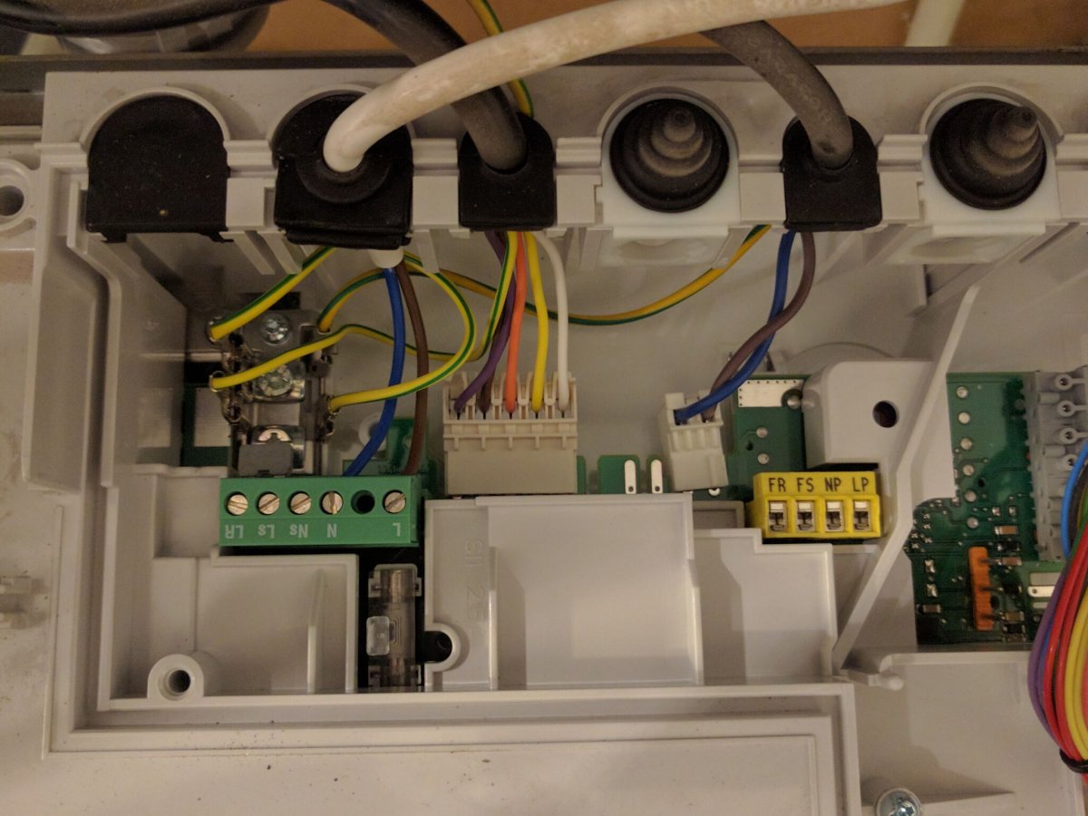

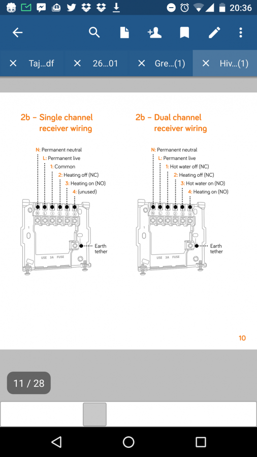

Hi all!
I've received my Hive2 from amazon and i'm trying to figure out how to wire this in.
the system is set as a combi boiler
we do not currently have a thermostat at all, the boiler has a manual timer fitted to it (the kind where you move the little plastic tabs)
I'm a little stuck as to what needs to be wired where, i've attached pictures of the control panel in the boiler and the install manual page from the hive.
I understand live goes to live, neutral to neutral, common is jumpered live also, the switched or 'call' line which i think is Ls needs to go to pin 3 on the hive?
if anyone can confirm or otherwise the above it would be greatly appreciated.
many thanks

You have worked it out correctly. You should have the single channel version, so:
Remove the link at the boiler between terminals Ls and Lr
The Ls on the Boiler is Live supply. This is the live supply to the Hive
The Ns on the boiler is the Neutral supply.This is the neutral to the Hive
The Lr on the boiler is the Live return (switched live) this goes to terminal 3 on the Hive 'heating on'
You then need to inset a link between the permanent live and terminal 1 (Common) at the Hive.
I'm not sure about the internal wiring of the boilers existing manual timeswitch. You may find that you have to set it permanently 'on' to then allow the Hive to take overall control.
