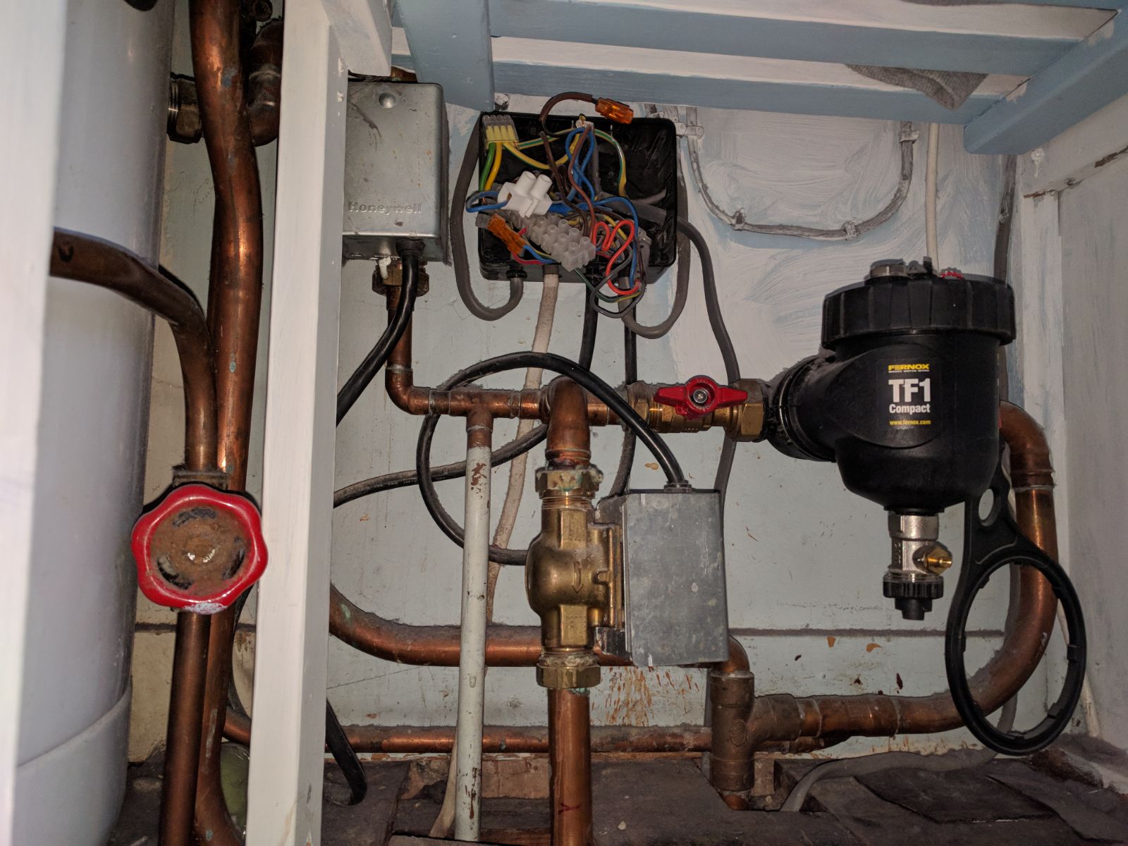

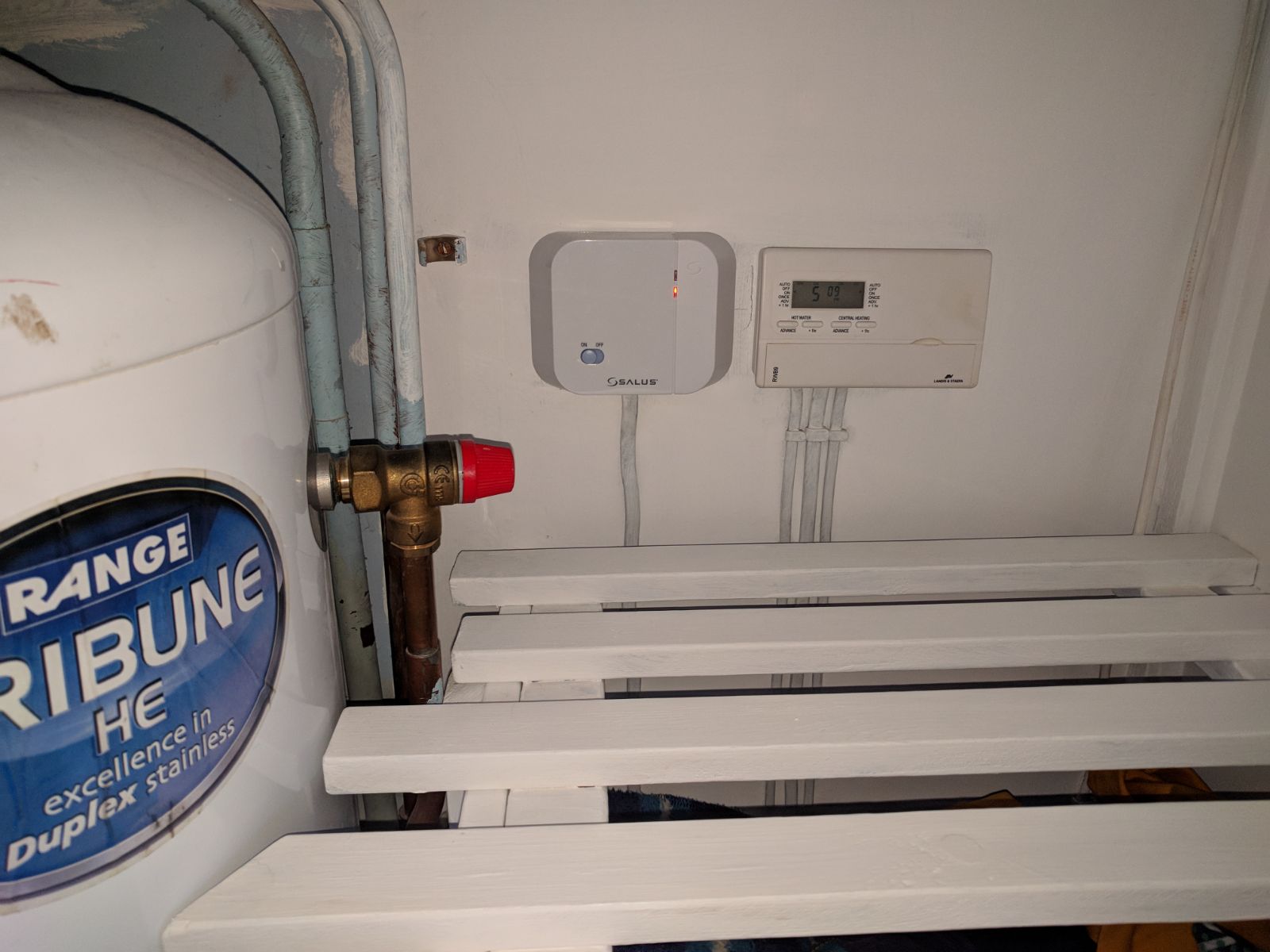

Checking further. The Salus receiver is installed next to the hot water cylinder and also there is a programmer next to it with Heating and Water set to 'always on'. I wasn't sure how that was used as the boiler only fires up via me setting schedules on the Salus RT500RF.
Perhaps the programmer is set to always on giving the control to Salus?
I guess i need to figure how the Salus receiver is wired/connected back to the boiler, is it likely this is done by a zone valve?
I've uploaded 2 pictures, one of the receiver and programmer and the other of the wiring at the bottom of the cylinder where the Salus receiver is. There are some valves there.
Many thanks in advance.

If both heating and hot water are set to be permanently 'on' at the programmer near the hot water cylinder then that is controlling the heating of the water, not the room thermostat. Hot water cylinders don't cause the boiler to fire often, because once they are heated and unless you are using a lot of hot water, they stay hot for hours on end. With your present set up, because the Salus is a combined programmer and and thermostat, the central heating needs to be left permanently 'on' at the programmer near the cylinder, otherwise it would override the Salus.
The existing programmer looks like a Siemens RWB9 (aka Landis and Staefa)
In which case the wiring terminals will be as below...
....and the Hive Dual Channel version is exactly the same. Lucky you, they are a straight swap :)
Once the Hive is installed, look at the wiring at the Salus receiver. Trace the cable from the Salus back to its origin and note where each of the wires are connected, and remove the entire cable. Then join together with a wire link, the terminals where the wires that went to the Salus 'NO' and 'COM' terminals were connected. Don't worry about any other connections, they are only to provide power to the Salus and can be disconnected. If you need any further help with this bit, post back a photo of the wires connected to the Salus.
No need to touch any of the wires at the boiler.

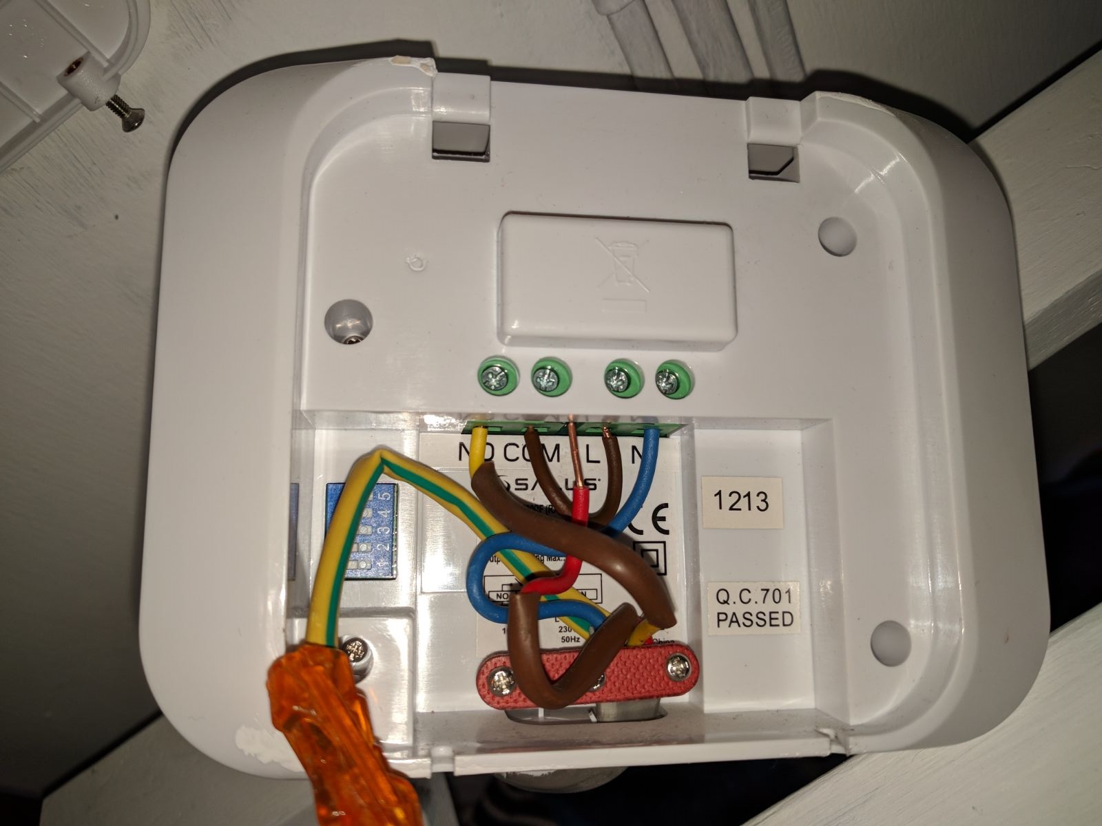

Attached here the wiring of the Salus receiver. The COM and L is looped so the COM had no cable itself, when i remove the cable how do i bridge NO and COM when i will only have the wire from NO.
Thanks.
Yes, as i took it off the wall the red wire fell out but it was in COM yes. It's the live to the box
OK Thanks, then:
1) Trace the cable back to its origin and note where the 'red' and 'yellow' wires are connected.
2) Disconnect the 'red', 'yellow', 'blue' and 'earth' wires and remove the entire cable.
3) Insert a wire to link together the two terminals where the 'red' and 'yellow' wires were previously connected

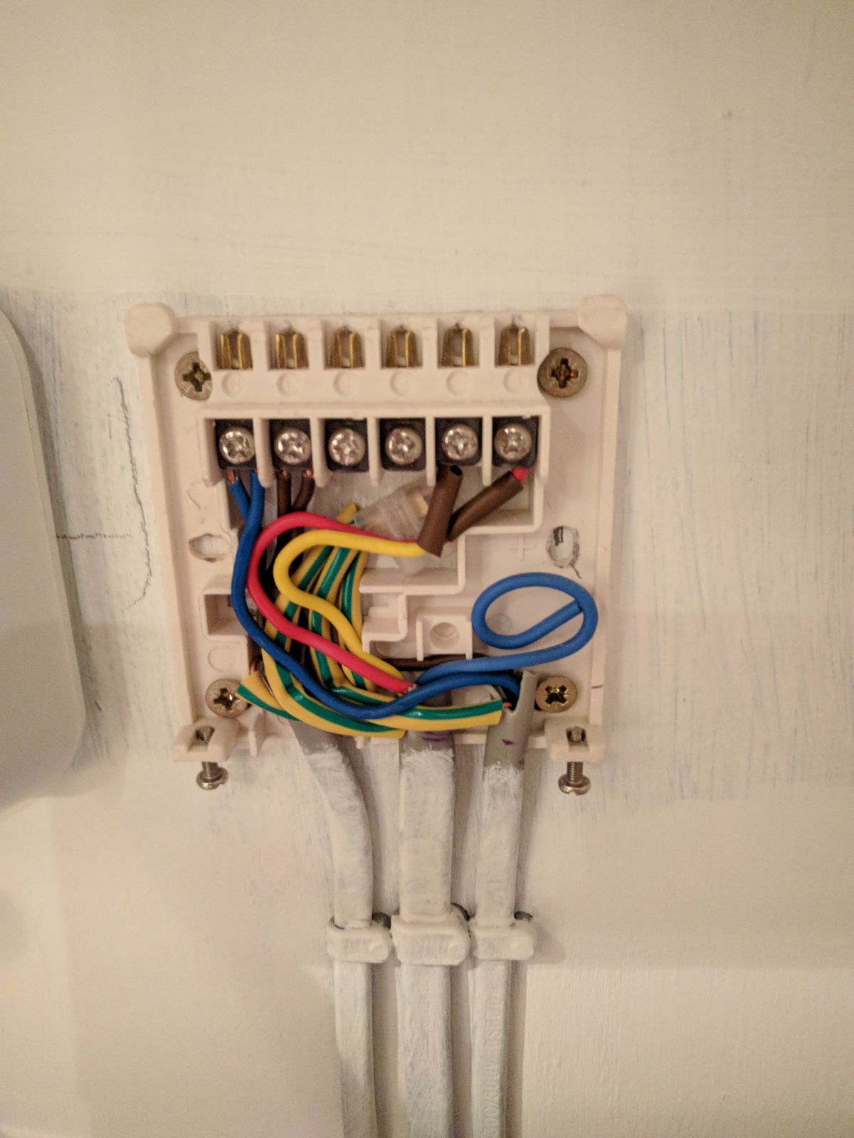

I've attached picture of the Siemens wiring of the programmer. 2 things:
1) Only the CH & HW 'ON' is connected. As i've read around i think that is fine, you only need to call the boiler ON anyway and not off.
2) Noticed there is a feed from the live out, trying to trace that and see if i can remove it completely, the Hive unit should stick straight over but with all the wires it is not fitting. I guess the extra live feed is just providing power somewhere so maybe it can be removed.
That's fine, they are were not connected before were they, and it worked, so you won't need to add them, your system doesn't need CH or HW off connections.
NO! Keep them exactly as they are you will need both. Remember...
So, don't change anything (apart from the thermostat wiring of course). If you took a picture after the Hive installation it shouldn't look any different to the one you posed right at the start. Sometimes you can swap the fronts over without actually changing the backplates. They are supposed to be universal, but they don't always seem to be. Having said that I always swap them even if they do fit.
